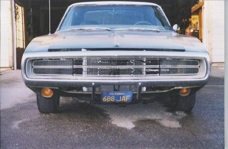

If that is your car in your avatar, it looks like it might be a really nice car. Countless nice cars have been hacked up by young males trying to make a hotrod, (i'm guilty), if you have a car that has made it 50 years, try to appreciate that fact and preserve it as much as possible.
Can you post more pics of your car? We would love to help you get where you want to be.

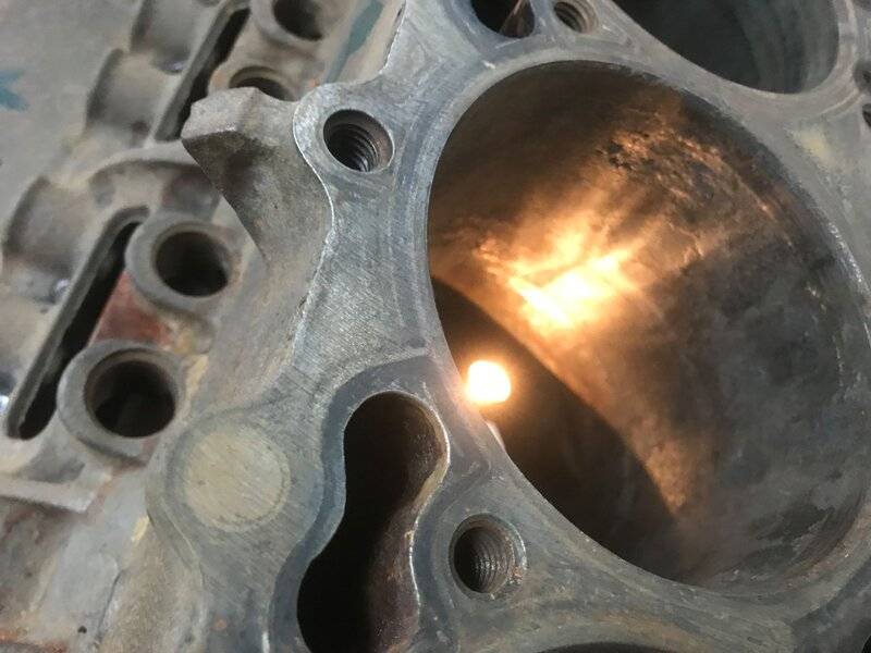

Hey Lorny. I just got a 75 440 myself yesterday. Just like a kid in a candy store. It's been sitting for many years. Not sure how many but too many. I started reading your thread. And when you asked about the crank I went right out to the shop to check and yes mine is a cast crank.
Like was said earlier, some of the most knowledgeable people on engines here. I have a question. When I tore mine apart last night. I took the heads off and seen this... Is this repairable to bore 30-60 thou over or will it require a sleeve? Or is it junk and I'm still looking?
Lorny I hope you don't mind me asking here. And also I hope your does not look like this. Sorry for the interruption.

If that's the only bad hole I would crack check the block then see what the other 7 will take to clean them up.
I would just sleeve that one and match the over bore for the others.
