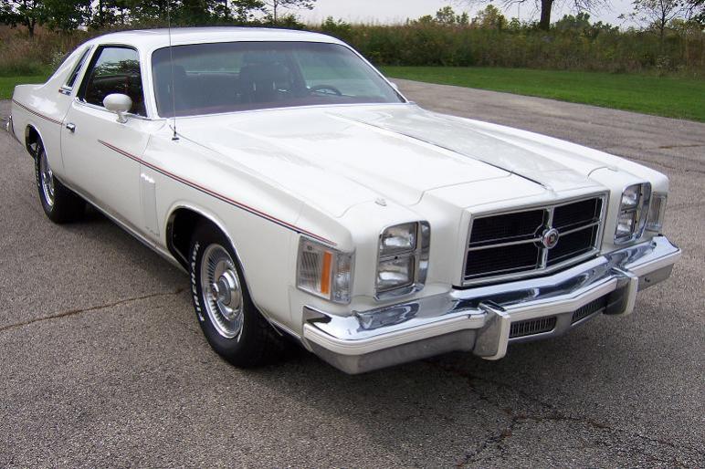

Sugest you dump the leanburn and put a conversion kit from Chrysler on it. 34 year old rudimentry electronics will forever be a problem for you. Restored a 79 300 with 28K on the odometer for my wife a few years back and the leanburn system was the first thing to go. BTW, I have a complete heater box with a good core ( no A/C ) for sale if you are interested. Nice looking car you have there. mares3002.jpg

Great find. Found one in Lombard, Il in 2007 with 28K on the odometer. Restored it for my wife and she has been enjoying it ever since. It was a double option plate car from California, so lots of stuff on it ( including factory sun roof ). For reliability, I suggest you dump the lean burn system in it's entirety - also the convertors ( mine had 3 on it). The original T-quad can be reworked to run great. They make great drivers. Good luck with it. mares3002.jpg

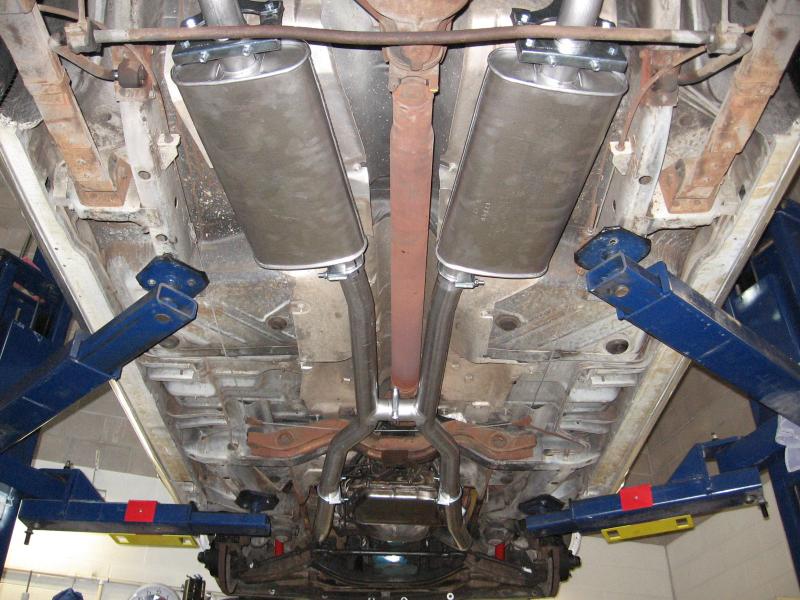

After a year of driving my exhaust converters clogged up .I don't have to smog it so a call to TTI got a complete system using the stock exhaust manifolds.
