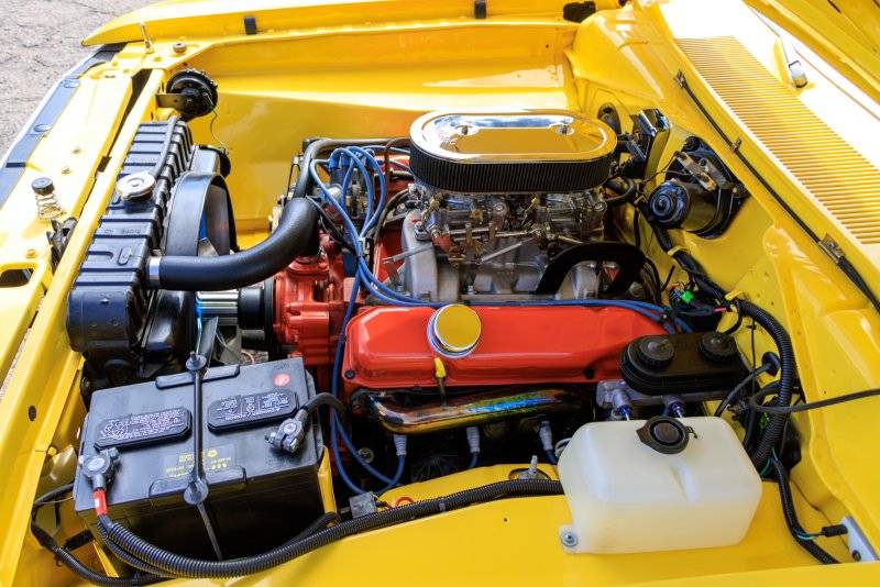

I've this cam in my .030 over 9:1 440 (built around 25 years ago; I've owned about 10 years now) runs excellent. Decent idle, pulls strong, lots of torque, never seems to drop off. 906 heads, 727, slightly warmer than stock converter, 3:55s. Not sure which version it is but leaning toward the 114lsa as it's very streetable to drive. Pic from earlier this year. Sounds crisper now since I rebuilt the carbs, etc., but here's an older link of it running:
