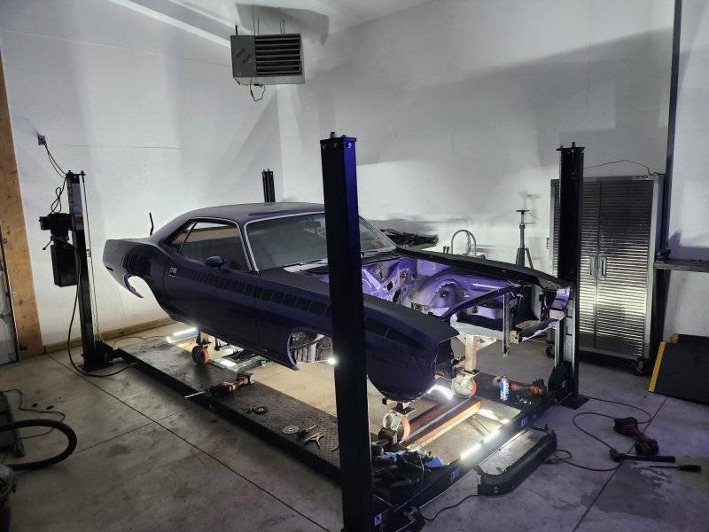

In the middle of a Cuda overhaul, just got the block back from machinist. about ready to pull the trigger on a stroker kit. With everything up in the air on quality, does anyone have any good or bad results on any part manufacturers? looking for a mid 10 to 1 compression ratio, hoping to achieve 500 plus hp and torque range, thanks.
