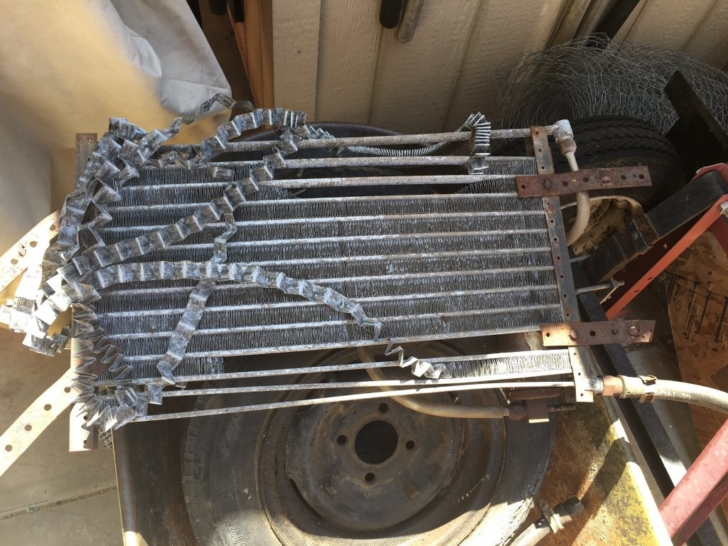

Is there any way to fix this part of the a/c system?
Again, thank you clarifying that for me Phil! I feel like I've gotten the better end of the .04 you have offered! I have some things to think about before spending any cash.
View attachment 357511 Is there any way to fix this part of the a/c system?
I don't think theres any hope there, anyway mine looked solid but when I went to try to disconnect the lines the metal simply broke, you'll probably have to do what I intend to do is upgrade the system. I d
BEST OPTION PROBABLY its what I'm planning.

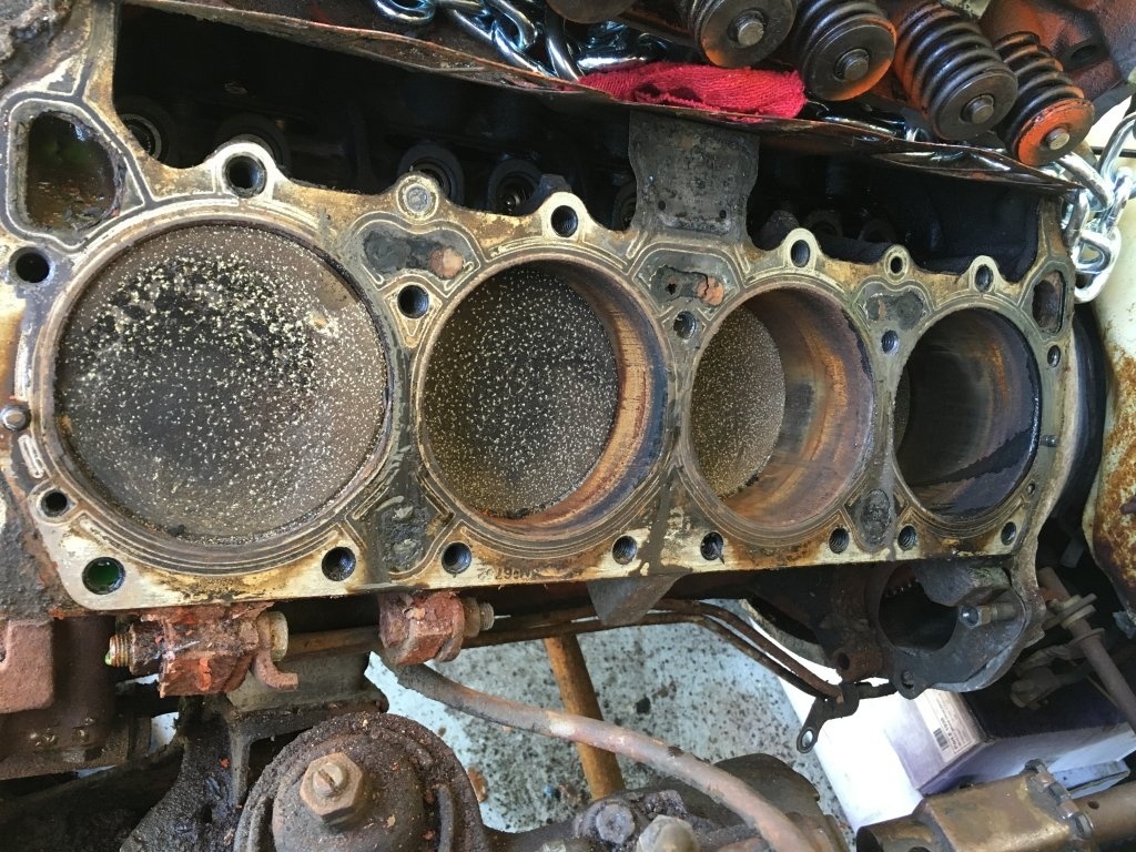

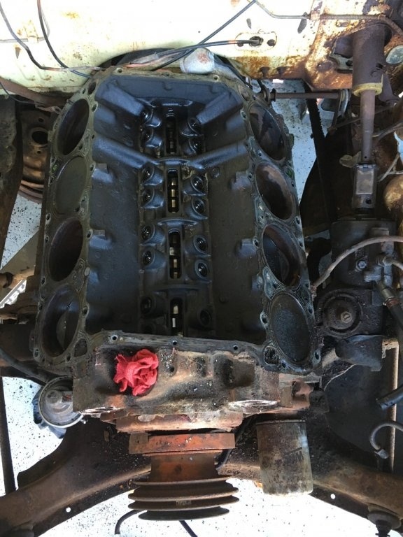

So the last thing I need to take out to pull the engine are the torque converter bolts. Unfortunately I have all the wiring out so I cannot crank it over. I've been trying with a prybar on the crank bolt but I cannot get it to turn. Finally I pulled off one of the head and realized why. I need some Mike's magic oil.

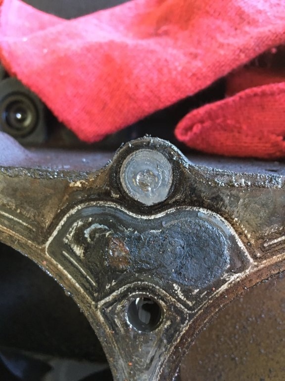

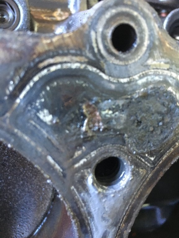

So I took the heads off and I'm noticing that most of the water passages are completely blocked. It's probably a good thing this engine was not started recently.

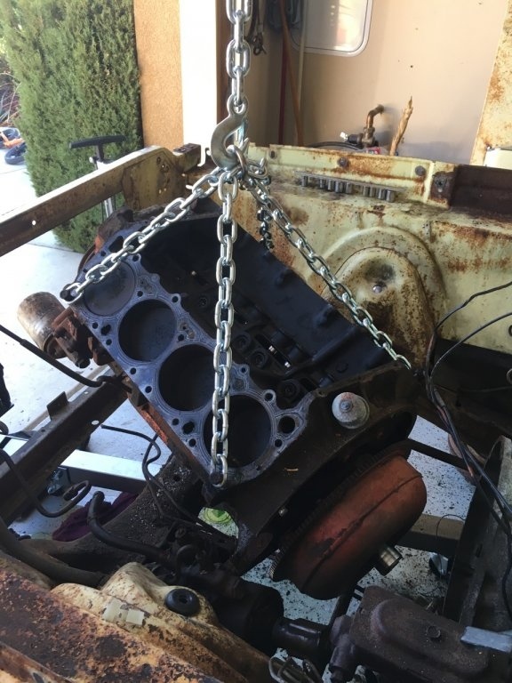

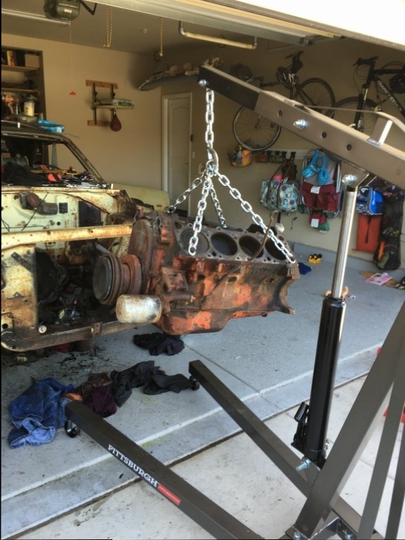

So after a lot of thought and talking to a lot of people I've decided to go totally bone stock with the engine. if I have to I'll just use some lead additive with today's fuel. Finally got the engine out and the torque converter off. I Have it up on the stand and going to tear it down, have everything gaged, and then determine what I need to start rebuilding. So far I'm thinking rings possibly bearings and a new seal kit.

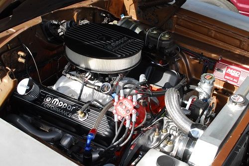

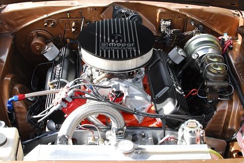

Not stock, lots of power. Way more money than most would put into a 383, but that's what I had (so that's what I used) and what ended up in my car.

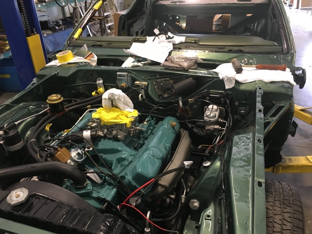

Mine had very little wear, so the bores were re-honed,heads re-done with hardened seats,new valves,cam,rings,lifters and the crank re-polished with new bearings.
