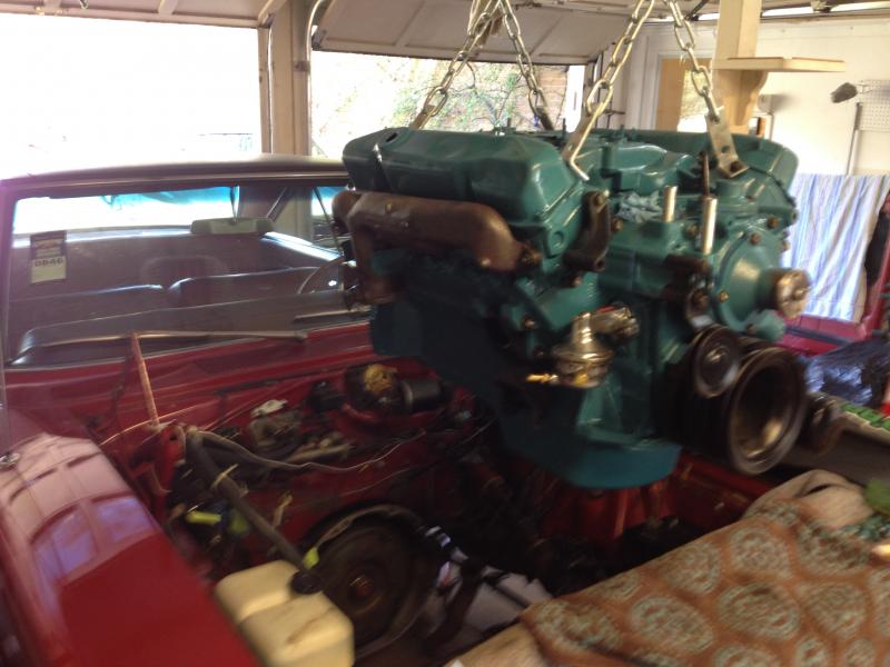

2014-03-30 14.11.44.jpg.......boom, the beast is in!

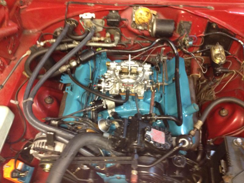

Team,
Just as an amendment, the a/c mounting hardware and brackets are totally different on these two engine sizes.
...well, almost there. All that's left is the damn dip stick tube and then a start up!

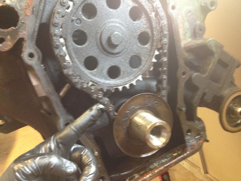

....got the timing chain cover off the old 383 and got a good look at what a motor looks like that's never been rebuilt. The plaque-like oil depositing was interesting, but the timing chain slack was incredible. Have a look at the pics.
...they were coated in plastic?
Some were. Unless that's just a very heavy crust of baked on oil deposit. I can see pieces of something missing, showing clean metal on the teeth...
On closer inspection, there is plastic on there. Never knew that!

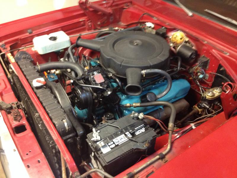

Here's what she looks like now...
