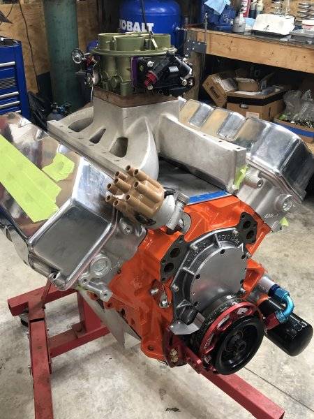

Itll work good. There are some good single plane 4 barrel intakes out there that make great power but hemi’s are kind if boring to look at imo with single carbs.. even with a dominator.

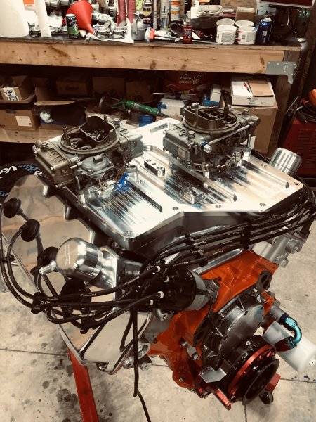

Fine Looking Hemi there !! ......I fully agree with the Single big Quad "Boring" BB Chevy Look you see Everywhere....This Build just looking for Reliable nostalgia "A990" SS look with Hard launching Soft tall wrinkle wall Hoosier cheaters.... Considering changing Crank & pistons for 472" upgrade.....Would the newer removable Lid X--Ram intake be worth the $$ over my stock Magi for significant performance improvement if using the 472" engine ??
On a 472 id run the original intake. I ran the MP on a 505 street/strip car and i would say it was borderline.
