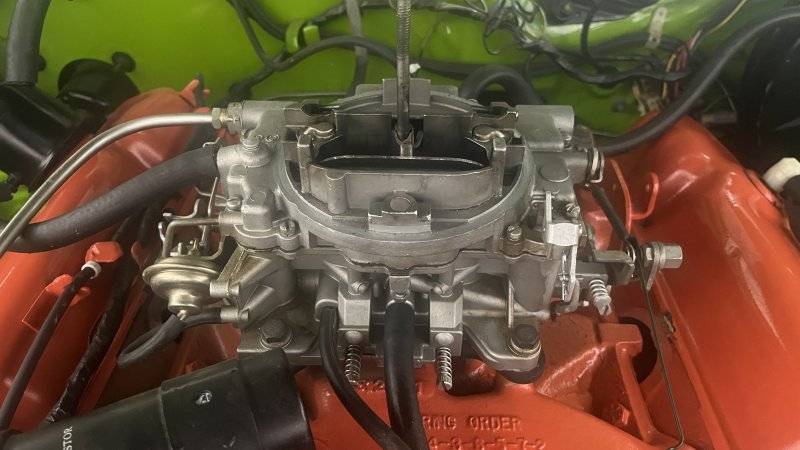

my bad, please see pics with air cleaner removed.
Without reading the P/N's...the carb appears to be a Carter and distributor is a factory single point.

Carb looks great , nice and clean obviously gone thru or rebuilt prior at some point
Can you see carb # stamped number bottom base left corner by mounting bolt
Is your choke fully functional
Can’t tell in pictures but is your choke pull off working along with your choke spring heat stove
Want to make sure your choke plate is opening all the way when engine hot and partially open when cold
Also your distributor is not factory correct for that year - Better off with that style vacuum advance anyways

That carb looks pretty fresh, maybe even professionally restored at some time. I would pull the carb off and get a rebuild kit and pull some Carter rebuild info off the internet. Before going any further put a little gas in the driver side vent tipubes to make sure there is fuel in the bowl. Then with the carb sitting over a pan, slightly rotate the throttle arm and se3 if fuel is instantly being discharged out the shooter nozzles. There should be no delay.
Removing the top of the Carter is simple, remove all the screws, remove the metering rod covers and rods, remove the choke pull off rod, disconnect the accelerator pump rod, disconnect the choke to fast idle cam rod on the driver side and lift the lid straight up and rest it upside down to protect the floats and air bleed tubes. Then the pump can be pulled out. Inspect the pump seal as many have described above, and inspect the shooter nozzle to see what numbers are on it which describe its size. Also look at the top and bottom springs on the pump. The bottom spring should be a lot lighter than the top spring. I have recieved rebuild kits that included incorrect springs. Get some pictures and info on the carb and report it here.

Looking at the pic, the mixture screws seem to be backed out a loooooong way. More than I would expect. Have they been adjusted for best idle, or have they been backed out to try & fix the hesitation?
I agree it does look odd. Also my idle screw seems to be out a long way also. I did use a vacuum gauge to set the idle mixture to the best possible vacuum.
