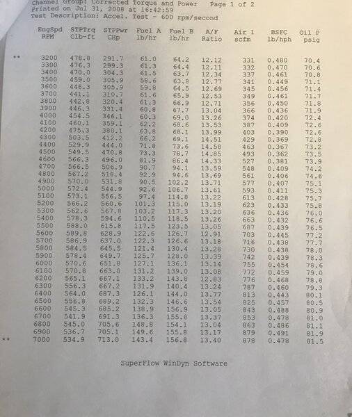

I like actual #s from local repeatable reliable dynos.
Agreed.
But after you’ve handed over the dyno sheet, and then asked, “what do you think it will run?”........ that’s how I come up with an answer.
Not exactly fresh off the dyno as it was 14 years ago...
446ci
Diamond 52002 flat tops
Indy SR heads CNC’d by Modern Cylinder Head [email protected] Int
/[email protected] Ex
Comp solid roller 269/280@050
.800 lift Int/.726 Ex
Super victor intake and a 4150 1050cfm carb
If only I knew then what I know now.

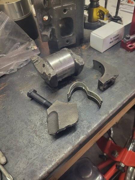

That's where I was at with my little 383 until it got the dreaded "crumbly crank" :(

What I think RamCharger was saying is that high RPM's are hard on OEM cranks. At 6200 -6500 RPM seems like an OEM steel crank holds up. At consistent 7000 they get weak. My 1st 400/452 motor with low deck rods saw 7000 shifts & 7000 in the traps. When I put in my Arrow it was 7200 - 7400 until I changed gears. When I took the motor apart a the end of the season, #4 main cap was in 2 pieces. Still running good. But the crank didn't ring like a tuning fork. sounded like a Chev crank. No good. I hope newer aftermarket cranks are much better.
