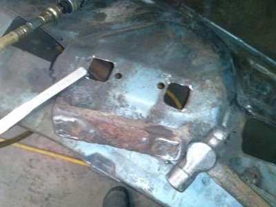

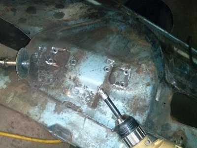

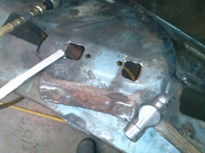

One A frame inbrd inner mount removed, one to go. I will align the new ones with 2- 1/2"x 13" rods going thru them and the outer mounts while welding in, pic of that to come later. These pics are from the engine bay side during removal of old mount/s.

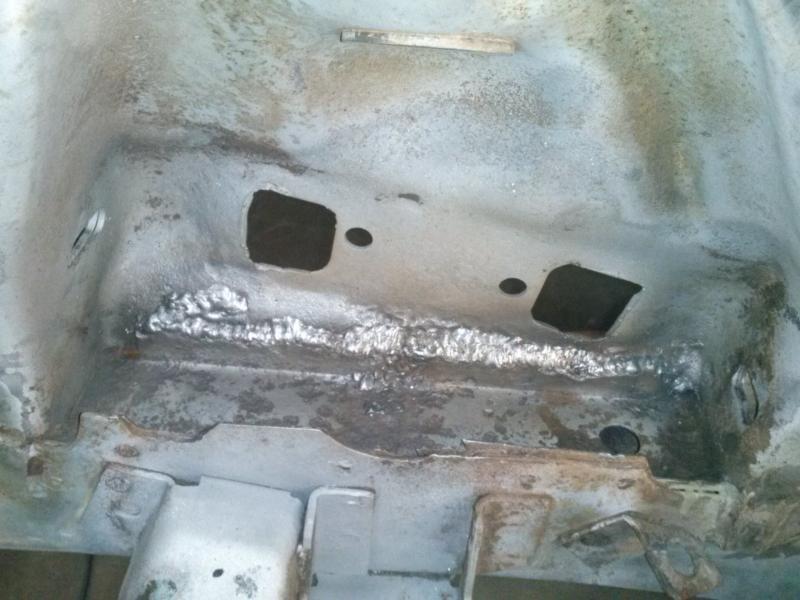

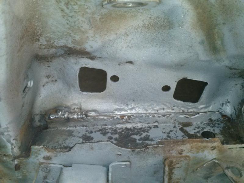

I got the areas blasted and welded one up where the rust had weakened them. New brackets should be here this week and will install them soon.

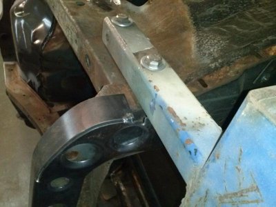

I got the new A arm mnt brackets today. $180 total gouge,
(PAYING THESE PRICES COULD MAKE THIS A MILLION DOLLAR CAR.)

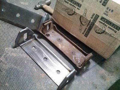

I should have looked closer at the pic of them in the catalog. I'm not real happy with them but I guess they will be good enough. They just don't look anything like stock/factory. And I have to remove the inner cam washer holder deal from my old ones to reuse on the new ones. I ordered them from ABS and they drop shipped them from SafeTcap. I will say though they do seem to be as strong if maybe stronger than stock. The tab-part where the A arm bolts will actually be thicker by 1/3 after I weld on the old cam holders. As can be seen here, they are as thick as stock before adding the holders.

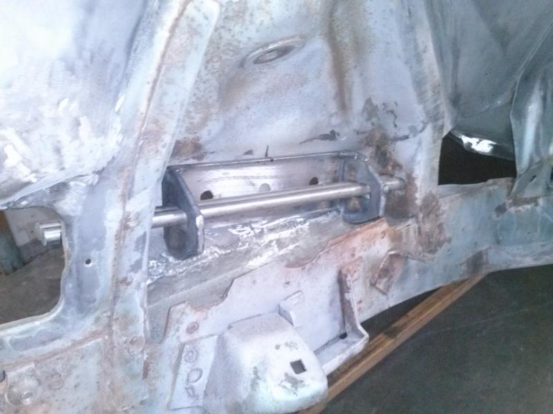

Here is a good test fit and shows how I'm going to line up the brackets during weld in.

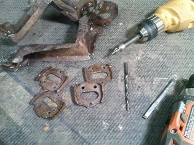

And here also are the cam holders coming off. I will blast them tomorrow.

No need to make them. They are still in good shape and were not to hard to remove. Making them would have pushed my limits and taken too long.
