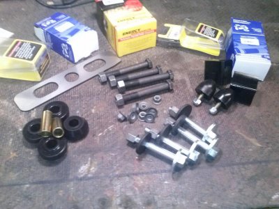

Got a few goodies from Mancini, hope it all fits!. I'm trying to buy a few things at a time that I'll need, as I think of them, and confirm the actual need. Bought extra hanger bolts for the rear wheel stand mod that I'm going to do. This mod will help the light front cg while on the stands since it will have the rear stands an inch or so further back.

Have you seen the video on those LCA stiffening plates? Don't forget to tighten them up if they are loose before you weld the plates on :)

Looking good daytona! Nothing like new parts, small or large "new" is good!

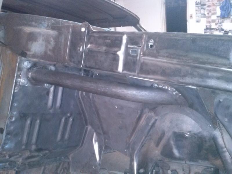

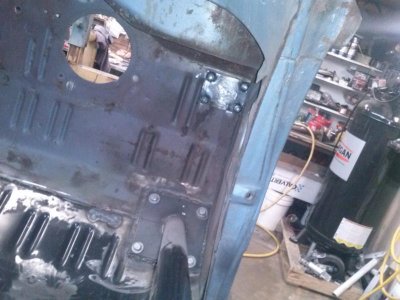

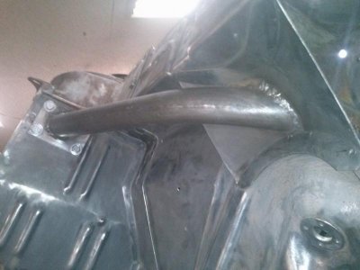

Got a good deal on these., thought I might as well ad some strength to the front also.. But I added something which I think will work out good. I added plates on the inside of the firewall that I will weld tubing to going diag to the door bars thus connecting front to back, or so. Still leaving all the inside bars unboltable. My buds kid me that I'm building a tank.

Very nice, boy she's gonna be stiff.
Thanks kid... I've been thinking of using those too on the convert to stiffen it up some more
I'll give these a thumbs up for ease of install.. They came with some extra plates/pieces that would beef up where they meet the shock tower but I really don't see them adding that much strength, so they're probably not going on unless someone can convince me otherwise.
I think I know what you mean and the strength adding may be deceptive .. but you have them so I'd do it .. remember these are uni-bodies and any bracing, gusseting, support etc can't hurt.
