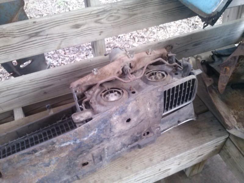

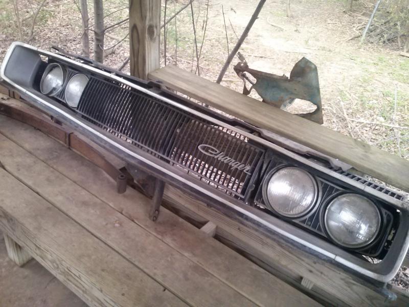

I dug out the grille for a look to see what all it needed. Doesn't look like it needs a lot. The lowest section of vertical fins is missing a few. The are about 1/4" tall, I hope to be able to replace them with something that will match. Any ideas on where to get something to fix these with would be appreciated. The head light door mechanisms appear to be ok but will probably go with some of the electric replacement units.

this is how i made missing fins & repaired cracks
using acetone & abs pipe shreds, worked awesome for fixing cracks & making fins,but takes DAYS to completely dry.
get some abs pipe from hardware store,cut it up in very small pieces,get a glass jar that seals good & mix the shavings with acetone,it takes time for it to melt,get it to where its like thin tooth paste. it works great!!!!!!!!!!
I'm going to try that! Thanks Charlie!

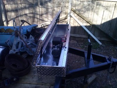

Still waiting on a good weekend to blast.. In the mean time I bought some stuff for the tow rig/trailer. A 9,000 lb winch and a tool box for it to live in. I'll add a battery for it, and some basic tools, equipment, straps, etc. Gotta cut a hole in the backside of the box for the cable and mount it to the trailer.

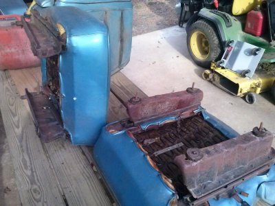

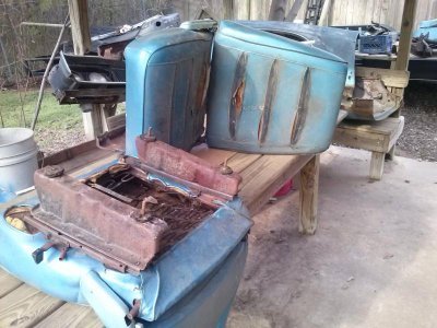

I,m thinking about selling my old seats. They need a lot of work and I'm going with the modern jegs racing style seats I bought. I figure if I ever want to put stock seats back in it I'll buy some then. I really just don't feel like trying to get them in my attic. My friend, the 27 mopars hoarder, has offered to buy them so I think I'll let em go.. I know it seems horrible to some to let go of original stuff but I can live with out them I believe. May let him have a few other items that I'll be replacing that I can get later new if I need. Just don't feel like storing a bunch of junk I don't really need. Please forgive me purist!
Funny, As can be seen in the pic, one seat had 3/8 thick plywood discs under the mount-bolts and one had 1" metal spacers.. And it looks like factory stuff.
HUMMM!:confused1:
