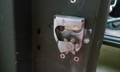

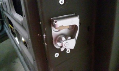

I finished up getting the passenger door latch working, and clean. I may have to go back and clean the drivers a little more. They will probably have to come back off when I paint anyway, not sure yet.
So that's what the door latch on the door is suppose to look like. Mine is just a big hole with spider web cracks in it LOL

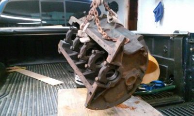

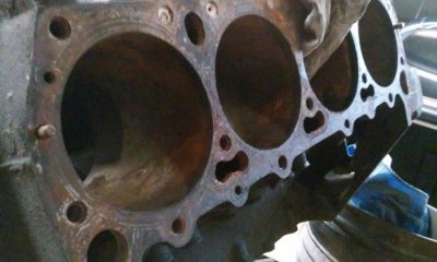

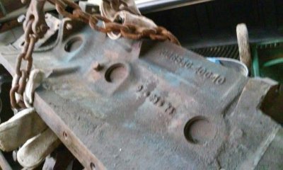

Got the 400 block today, looks good to me.. Casting date is 9/30/74.. I checked the bore and it was stock/4.34 with maybe .05 slop and a little minor surface rust. But I'm pretty sure I'll need to go with a cleaned up .30 over rebore anyway. Looking for best deal on a 512 stroker kit now, any recommendations? I know 440 Source is a good kit but are there any others comparable to theirs at a lower price? I talked to a bud of mine that has a racing engine business (w/ dyno, head flow bench, etc, etc..) about a mile from my house and he said he would help with what I can't do. He has a famous son that races nascar, but I'll leave out his name since he may not want the publicity. I think I'm going with 10-1 compression on this motor so I can still run pump gas., but build it for a little n2o also.
