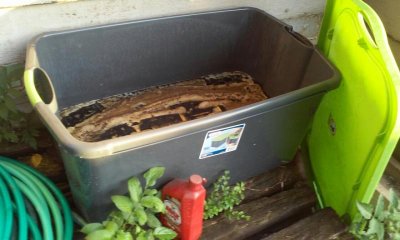

Got a new bigger molasses tub from walmart. I had a few more parts to de-rust that wouldn't fit in the cooler that I used a while back. The 4 pieces of the front bumper mount brackets are in there now.
