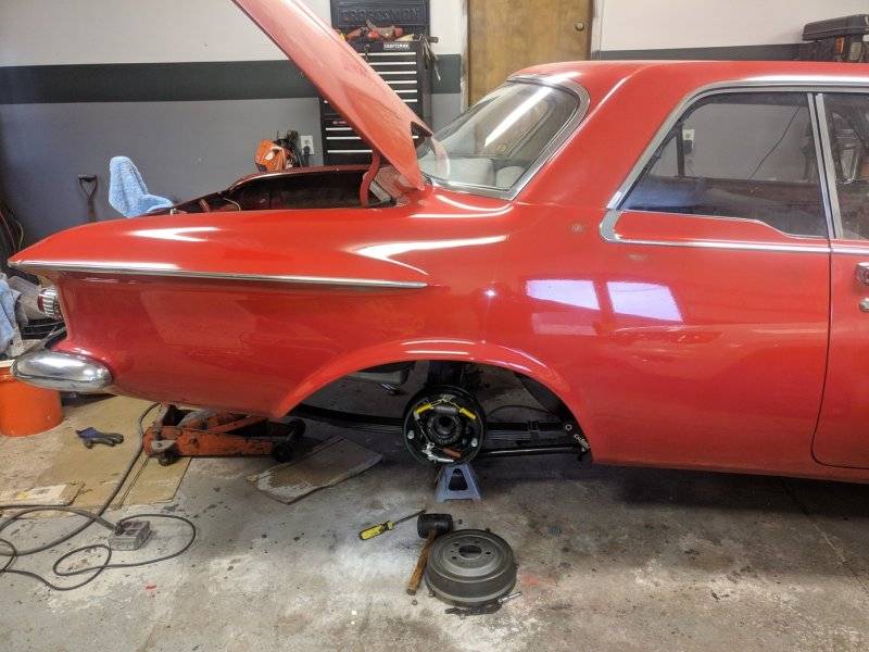

Gonna take the axles out tonight and swap sides.. last night one was 140 degrees when i got done driving, other was 98.. wanna see if that heat moves with the axle or stays with the brakes (i had them adjusted with no drag at all, so i think i might have a bad bearing.. will see)

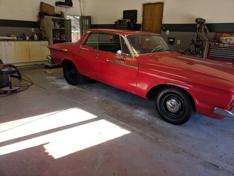

OHH BTW... leave dog dishes on the front or make them blank like the rear? my dog dishes wont fit the rear plus i like the rear black rims..
Personally, I really like the look of the dog dish caps, and even more so when the wheels are the same color as the body. I have always thought a plain black wheel looked more like a temporary spare. But of course, your car, so definitely do what makes you happy. Either way, the car looks pretty cool.

And i agree with body color rims.. i just didn't think bout it before mounting the rear tires, and i have never once painted rims without getting paint on the tires so i'm not going to try at this point.... one day.

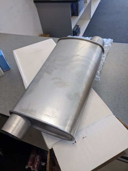

Pulled the old mufflers last night.. new ones just showed up, hopefully get them on tonight depending how i feel after work..
They are big and ugly and heavy and hopefully quiet :)

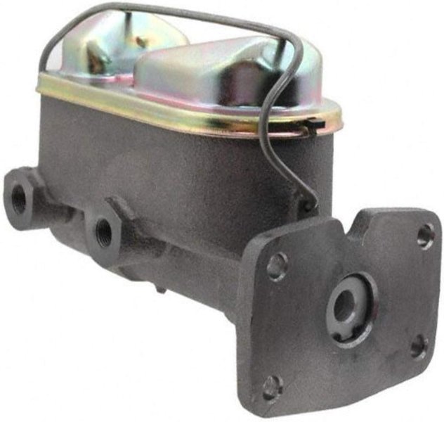

The brakes are just dangerous and with that i have no idea why. everything is brand new, disc/drum using the Raybestos MC36412 MC, supposed to be for manual disc/drum.. i can stand on the pedal and there is no quick stops.. just a nice easy slowing down. Even put yellowstuff pads in front to try for more bite. I think i'm going to buy the half plastic one drdiff sells to see if that changes it. The one below is the current one..
