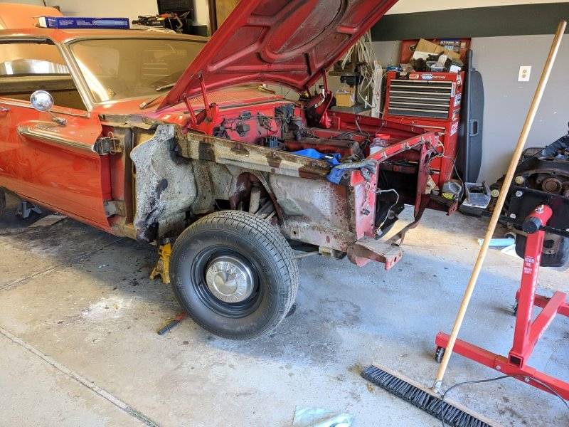

Got the front clip off last night... haven't been able to get help removing the hood yet... is it possible to get the engine out of these with the hood still on?

Great project! I have a 62 4 door of my own with a slightly modified Poly in it.
You may be able to pull the engine with the hood on if you get the cherry picker right down on the engine. You'll need to seperate it from the trans/torque converter.
Use some straps and the engine hoist to remove the hood.
I have thought of that.. i really can't take a chance of hurting that windshield though.. i will get some help eventually.. I have the trans unbolted from the motor, since it's locked i can't undo the TC bolts.. might try to get the trans out first.. i'm starting to get in RUSH RUSH mode.. and that's bad... long term project.. relax :)
If the motor is locked, I would keep the engine/trans attached and pull them both from the top. Need to remove the hood and have clearance in the garage. Less likely to break the trans/TC.
well pewp.. all unbolted... i figured i would get a jack under the trans and lift the motor up a little then forward to clear the converter (taking off the timing cover and front of engine for more clearance) then up and out
If you have room to pull them apart then give it a try. With the radiator out, you could probably pull the engine forward with the the engine lift. And then work the trans back and down. It's a lot harder with the torque converter in place.
Or pull the engine forward and get to the TC bolts from up top.
yeah.. issue is i have to do all this alone and with a messed up shoulder... so figured not pulling both together might be a little easier than handling the whole thing at once
I hear that ! The older I get makes it even harder. But I don't have any other hobbies.This is all I know.
My old joke is it keeps me out of bars and chasing wild women !!

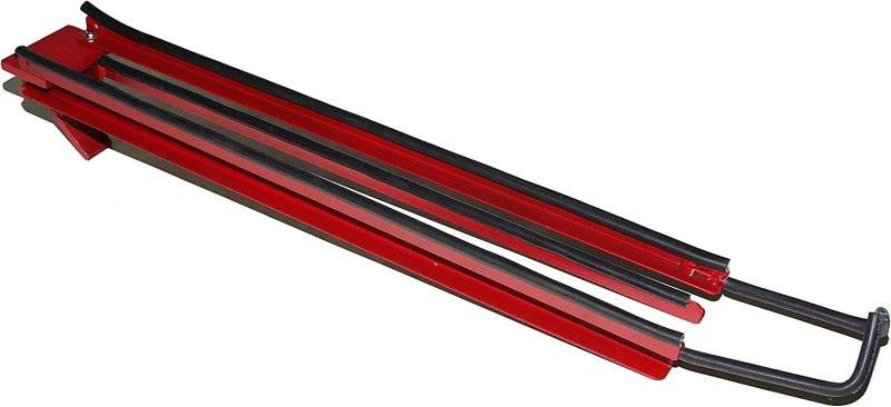

A number of years ago I bought one of these to remove hoods without help. Bolt it to cherry picker and go. Best $100 spent.

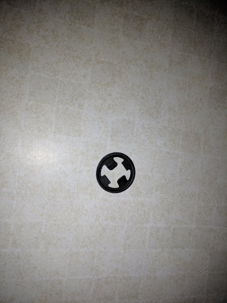

Slow going.. been working on the window regulators and getting the windows back in.. which is done now except 1 star washer i broke :( Anyone know where to get something like this?

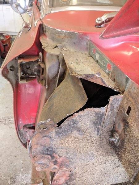

Pulled the fender splash shields today and found more rust to cut out, i think i am almost done finding bad rust... nothing too bad though, some patches and it's hidden anyway.. I doubt anyone makes splash shields.. will have to try to save mine.

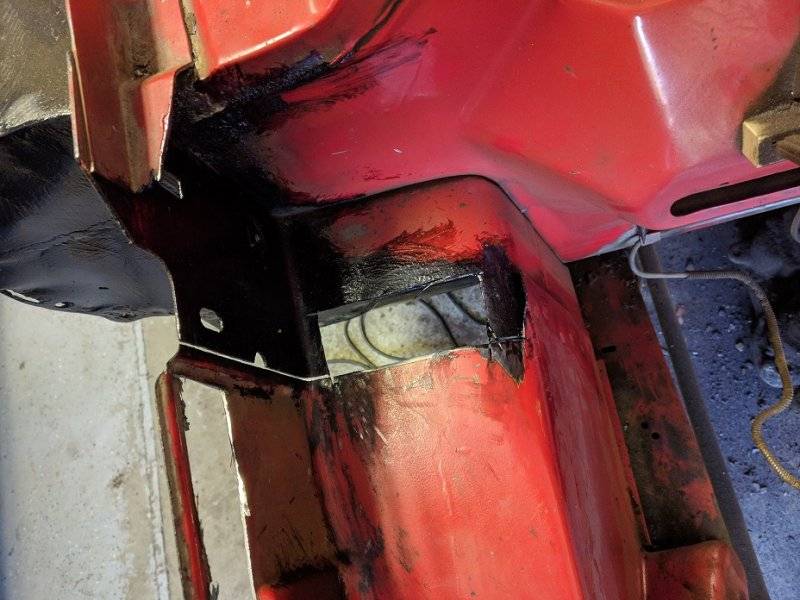

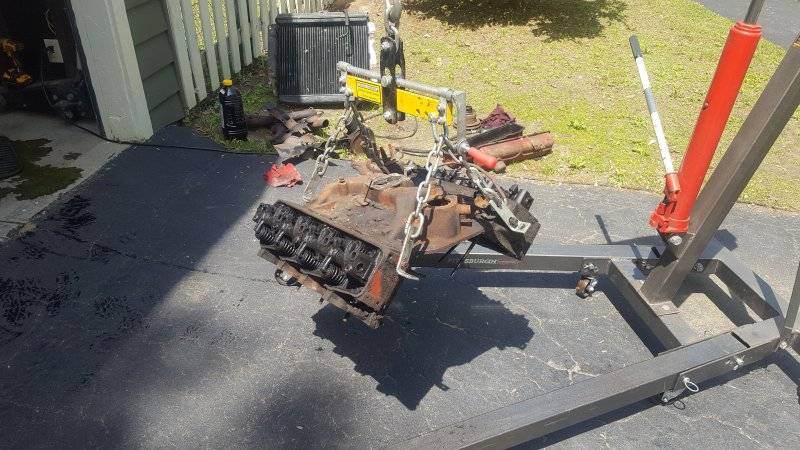

Finally got some work done yesterday, hood is off the car so the motor/k-frame can come out...

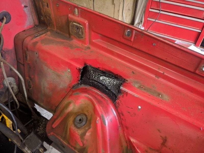

Also turned this...
Into this.... which i am not sure how it's supposed to look, just guessed... good enough to seal up stuff and the splash shield to mount to..

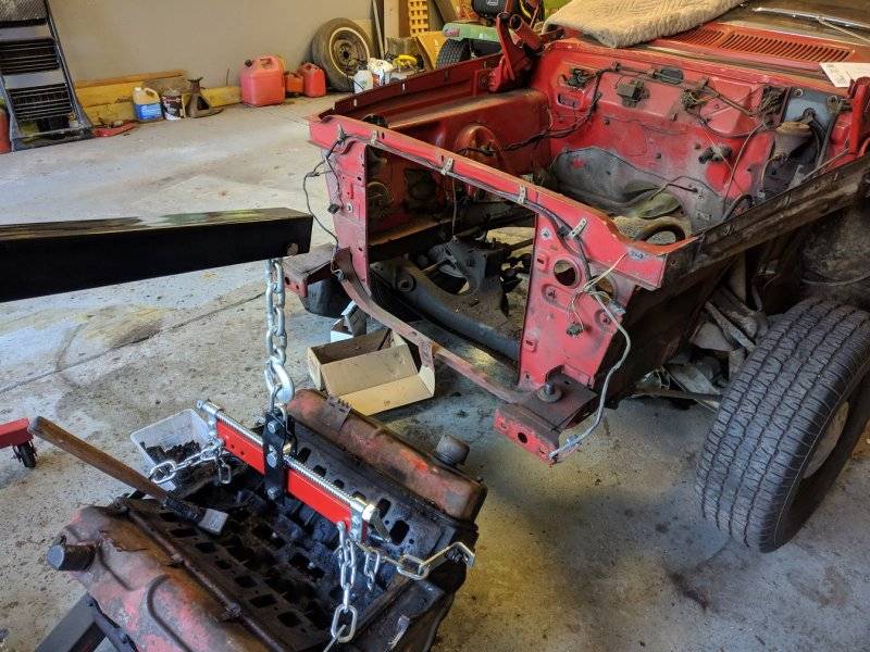

Engines out.. now the work can start and i have no excuse... the trans has me a bit worried, never did a 2 pump but will figure it out. Gonna see if A&A or Cope will send me the correct parts to switch to 24 spline so i'm not guessing at it..

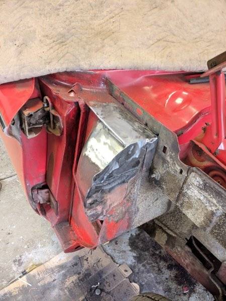

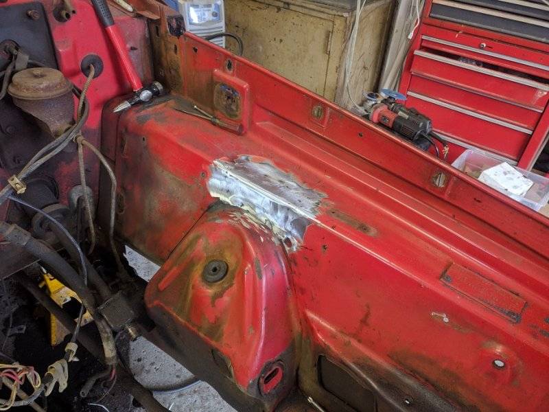

Soo.. took this to this.. Didnt' do a great job on the arch.. but will be good enough.

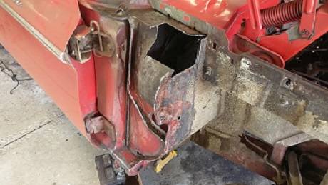

And cut out more rust back where the seams meet in the back near the cowl.. drivers side will be a pain, need to pretty much replace it all the way down where the seams meet.

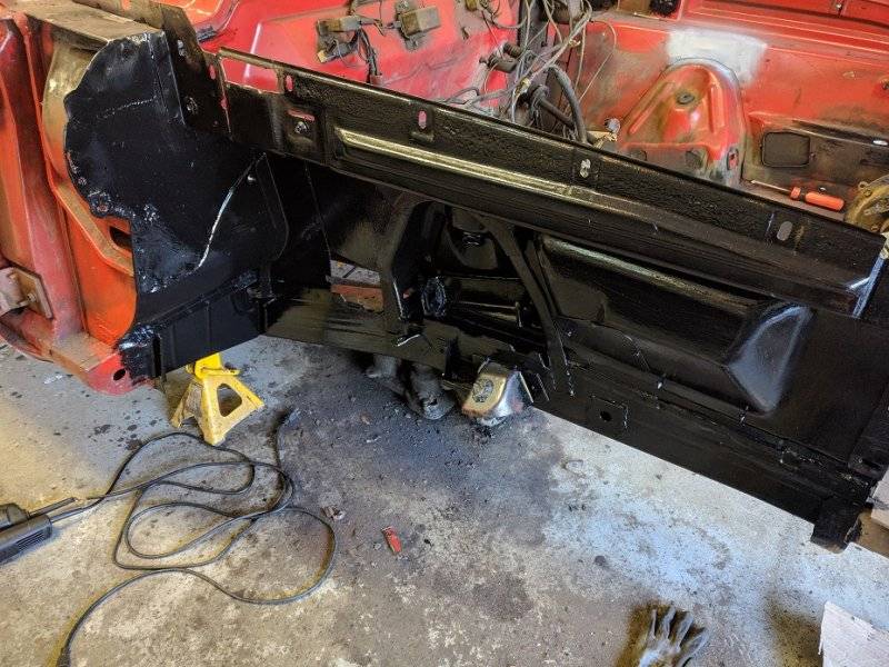

And got some paint in the wheel wells since i had the paint out for the k-frame/LCAs
