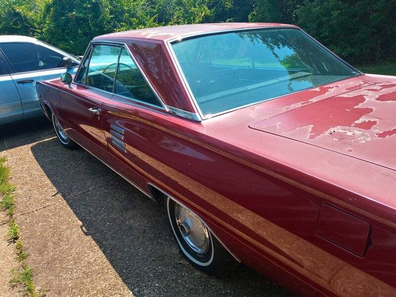

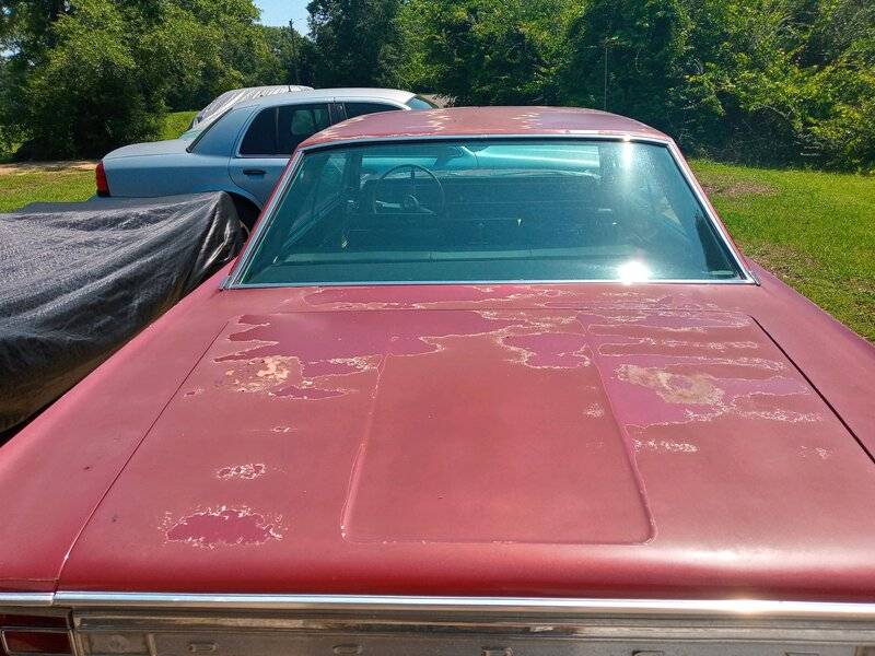

Always wanted to do a build thread on this site. So, I got this car home about a week ago. I made the deal on it last year around August. It came out of the same barn my 66 Belvedere II H code car came out of. They sat side by side for about 20 years. When it saw the light of day, it was beautiful, paint was slick with minor sun fade in spots and interior was spotless. I went down to get it and unfortunately, I shouldn't have waited almost a year to pick it up, but it was 12 hours away in Florida. The sun literally baked the paint off of it unfortunately and the interior got a lot of water intrusion too. So these are how I got it, my buddy did the best he could to keep it safe, so at least it's home.
About the car, 66 Coronet 500, 2 dr hardtop, 361, auto, console, buckets, factory AC, AM radio, remote mirror, 4 way flashers, wood grain wheel.
I want this to be a very nice driver. I want it to run well and be reliable while restoring bits and pieces as I enjoy it. I don't want a hot rod, I have plenty of those, I want this to be a car I can take to car shows, go cruise with my family and maybe take on short trips. I want the ac to work, go down the road straight and smoothly, and have a good ride. I want it to look sharp and turn heads, which it will as I've never seen another around here.

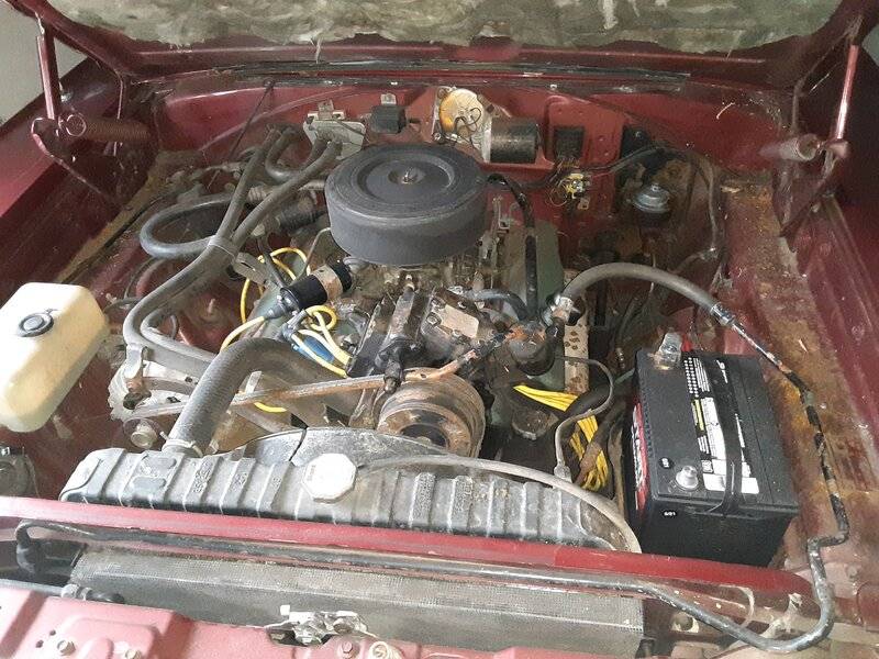

I tried getting it running yesterday and today. I figured out the points were corroded and not letting the proper current pass thru them. I got some 320 grit sand paper and sanded them to clean the corrosion off. It took a few tries and I had to gap them a bit tighter when finally, poof! Spark! So I tried spraying some starting fluid in(brake clean), and it kicked over and promptly tossed a chunk of the cracked fan shroud up in the air. Lol. Fired up tho, even if for just a sec. Engine has had a 4 bbl put on it, looks correct for a 63 by the date cast in the intake. But it wasn't getting fuel up to the carb. So, today I decided to Roadkill it and pulled the inlet off the fuel pump and hooked a 5/16 rubber line up to it and put the other end into a gas can. I tried pouring gas in the carb and got it to sputter some, but when I put my thumb over the fuel line inlet and cranked it over, no bueno. No suction. So called up the parts store, 28 bucks, be in tomorrow. We'll see how close it is to the original when I get it.

Ok, so it runs! And runs good too! I figured out why he parked it, the driver's side very rear exhaust manifold stud is broke off and it's leaking exhaust badly. Also, it needs a matched pair of AC belts too. Lastly, the distributor shaft has copious amounts of side play and wobble, so it needs to go.
The afb idled and even the accelerator pump worked. Choke worked, idled about 500 so I set up the idle a bit. It went into gear forward and reverse. Power steering worked and no leaks I could see.
I used a gas can with a hose to the inlet of the new fuel pump. I used a magnetic screwdriver to get the pushrod back up and pump went right on.
Tomorrow, I'm going to put a filter inline before the pump, there is one after the pump already, and put some fuel in the tank and see if it will run that way for now.

For now, as is. It's a damn shame to as the car was gorgeous when it came out of the barn. A year in the florida sun wrecked what turned out to be a cheap paint job. Eventually I'd like to fix the paint, but this is not going to be a strip everything down to the shell resto. I've seen way too many of those end up taking 10 years to finish and I'm not missing out on driving this one. So patina for now, yep!
