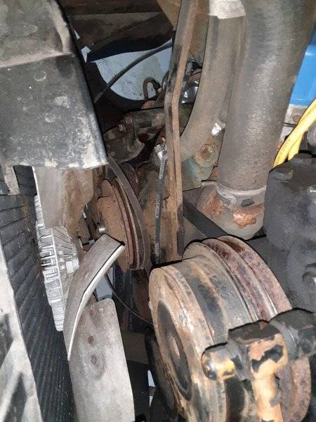

Well, decided to take the bolts out of the clutch and separate it from the fan. I was able to get it loose by lifting it upward and out. Radiator is a little worse for wear, but it'll work. New one is almost as long as the one I took off. The fan shroud has to come off in order to get the fan out so I'm going to do that and then dry test the new clutch. If it gives me 1/2" more between the radiator and clutch face, I'm going to run it. I'm putting all the belts on with everything out of the way, too. Can't wait to get this done. Going to have to wait til later or early tomorrow as it is just too hot in the shop right now.

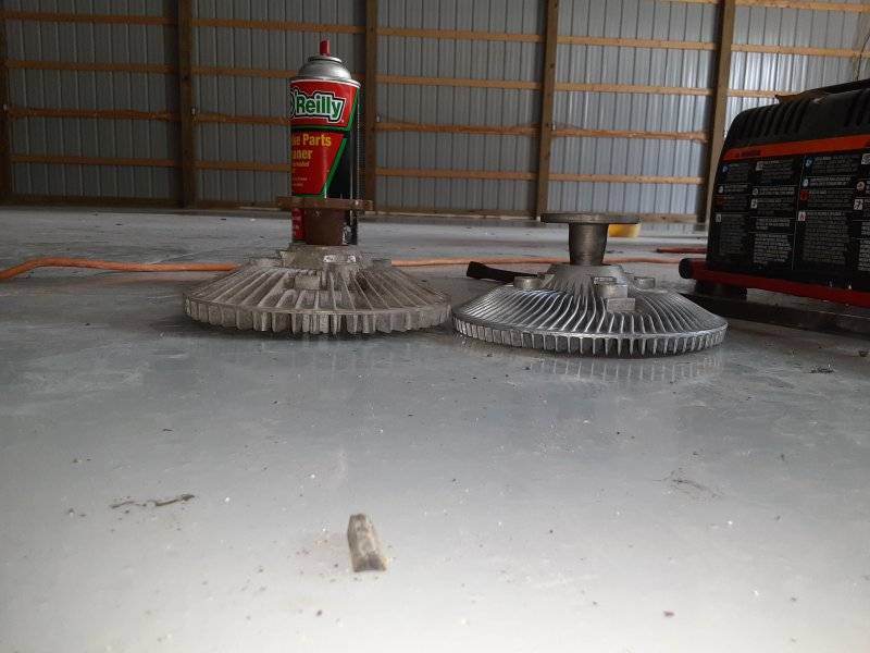

So, FTMFL, I got the shroud off, fan out and tried the new fan clutch, it is about 1/4" shorter so I could get it over the waterpump nub, but alas, the hole in the back of the clutch is too small to fit over the nub. I called napa, they'll have one tomorrow morning.

So, I'm having a hard time finding a fan clutch that doesn't hit the radiator but still fits over the water pump nub.

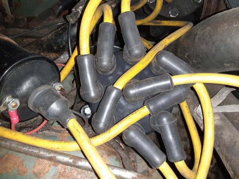

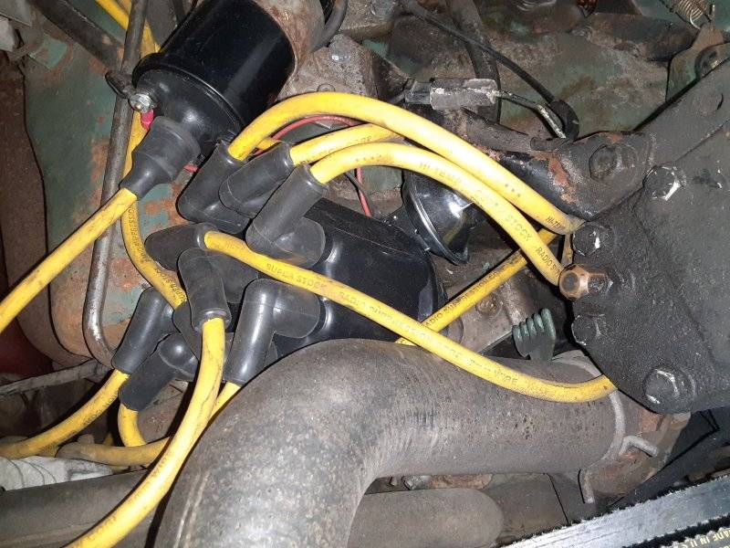

I decided to go ahead and try the petronics 2 distributor in this BB. I am not impressed. From the GM cap and rotor to the GM style base, I just think it is too big for no reason. I didn't have to grind anything but the wiring harness runs down the manifold edge of the valve cover and I had to stretch it out of the way to clear the GM cap.
I got it in and started it up. Seemed to run a lot smoother, so happy about that.
I am going to go with Sniper EFI and Sniper ignition so I can computer control the timing, too. So this distributor is short lived anyway. It'll be up for sale on here when I'm done with it.

I called Megaparts about their repop viscous drive for my fan on Friday. I asked him how long it was from base to the front so I could see if it will give me enough fan to radiator clearance. He said he was busy and if he had time over the weekend he'd get one out and measure it for me. I said ok, tttyl. So I call today after not hearing from them over the weekend, no biggie being Junteenth and all. Kidding, Father's Day. I called today and he was busy filling orders from the weekend. Hopefully I'll know tomorrow. He seems like a really good guy.
Fixing the radiator and getting the proper sized fan clutch on it is the last thing before driving it. I really hope he looks for me tomorrow.
I could have used the original points ignition distributor and converted it, but the original is completely worn out and would have just caused issues.
So hats off to Zach at Mega Parts, he got back with me and their repopped fan clutch for bb ac is 2.75" long. The one I had was 3.75" long. This should work perfectly so I can replace belts if necessary without pulling radiator, shroud, etc. I will post pics of the differences when it arrives. I need to get the radiator out and solder up the tubes I grazed open. I think at that point everything I can do from the top is about done. I still need to figure out which ground is bad causing all my electrical issues on the dash.
