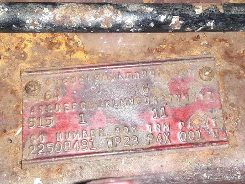

So here is a decode of my fender tag.
a6-console, b4- bucket seats, p6- lh remote mirror, AB51- 361 2 bbl, C5- auto trans, G1- 26" rad, R1- AM radio, S1- AC(comes with tinted windows), QQ1 dark red metallic.

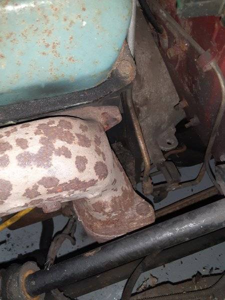

Yeah, I'm not looking forward to it at all. I need my lift installed before I start on it. The exhaust needs to be unbolted from the manifold before I can start pulling off the manifold. I'm not looking forward to doing this at all. I'll try welding a nut to the broken stud if there is any part still sticking out. I'll post pics and show how I did it. Last resort is pulling the head.
Driver's side. I'll snap a pic of it when we get home from vaca tomorrow

It is the very rear stud that is broken off on the driver's side. I really am dreading this.
