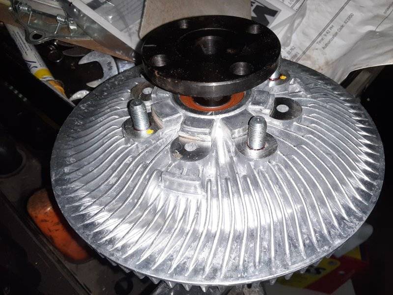

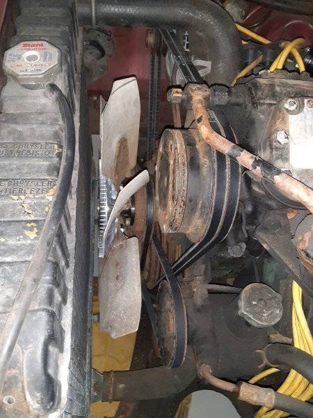

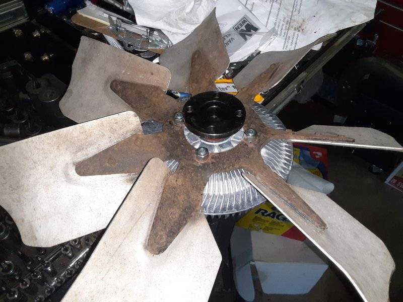

I got the fan clutch assembled. It comes with studs to use to mount the fan onto it. I used red loctite on the studs and double nutted them to get them in and snug. Only negative is one side of the studs is ground to a bevel and they didn't clean the threads after grinding, so the nuts didn't want to start on. I put the nut on the good end and screwed it up through the bad threads. Still didn't really get them perfect but I just wanted to get it together, otherwise I would have ran a die over all of them. I then slid the fan over it and bolted it together. Then I slid it down onto the water pump and bolted it up. I have about 1.5" between the clutch and the radiator. Very happy at this point.

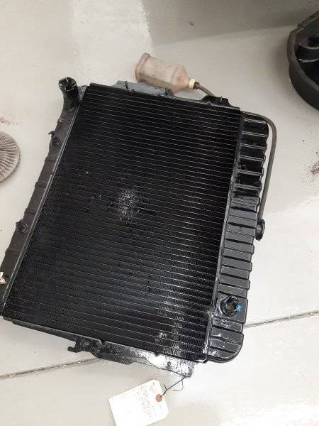

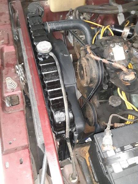

I pulled the radiator out and attempted to repair it. After prepping and trying a couple different ideas, I gave up! Called the last remaining radiator shop within 100 miles and he said he would try to get it repaired today for me to puck up before they close because they won't be open Friday and not back until Tuesday. I stopped by NAPA and was able to get the hoses ordered. I need to finish taking the old ones off so I can match them up. More later.

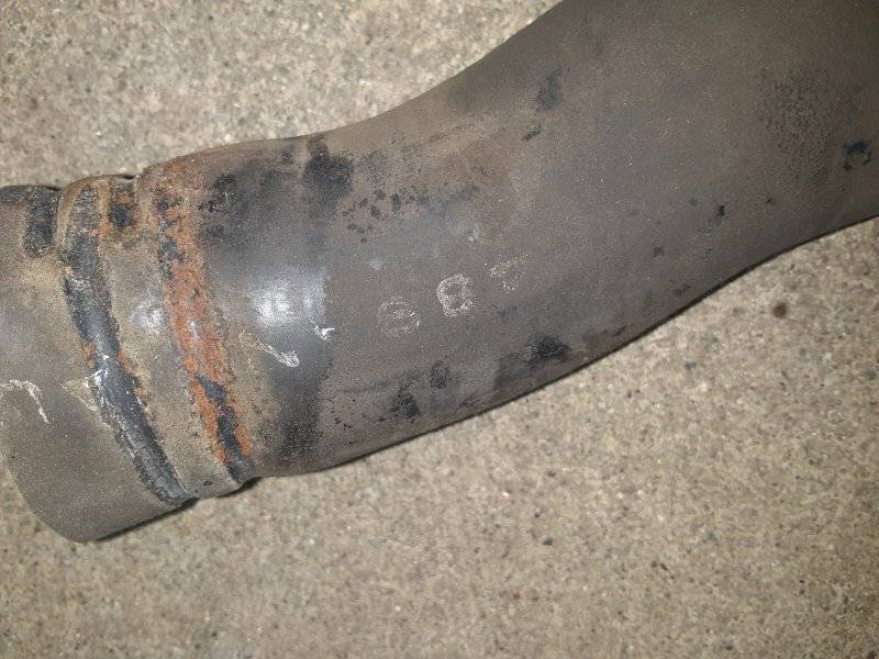

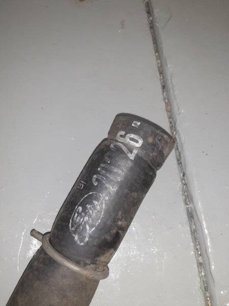

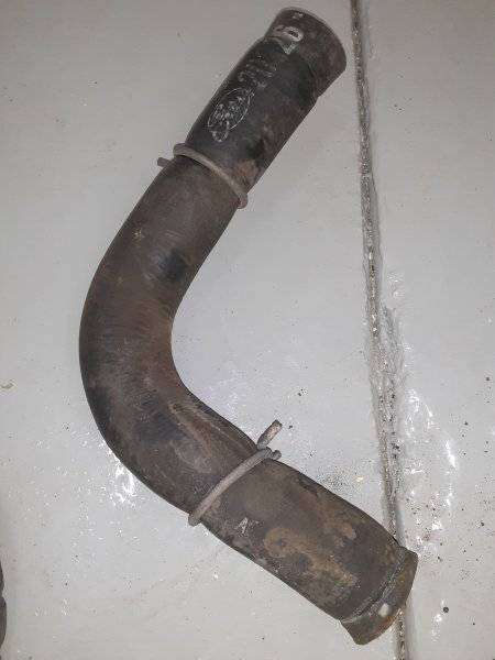

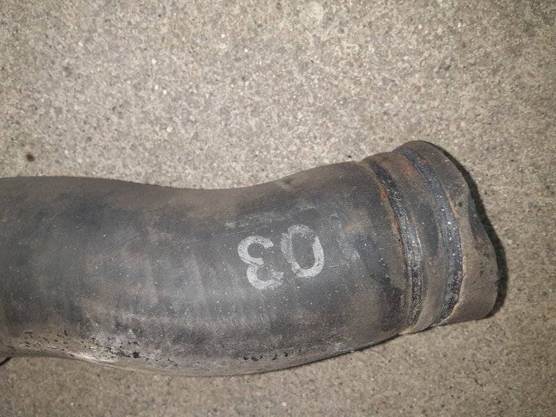

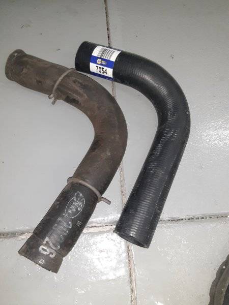

I got my original hoses off and went to NAPA to pick up the ones I ordered. I'm glad I did because the upper they had was wrong. My upper had a very clear Gates part number on it. We cross referenced it and have the correct one coming tomorrow. Here are pics of the upper and lower. I have the lower they ordered in, it looks very close to correct, but I think the lower I took off was an original hose. It has a partial part number on it that looks like a stock part number. I had the radiator repaired and it looks decent. It'll work til the aluminum one comes in. More tomorrow.
I picked up the radiator from Woody's and the bill was 180 with tax. They fixed the couple holes I put into it with the belt and it turned out decent. They did a good job even though it needed a new core. They also resoldered the overflow hose clip back onto the side. Looks really good.

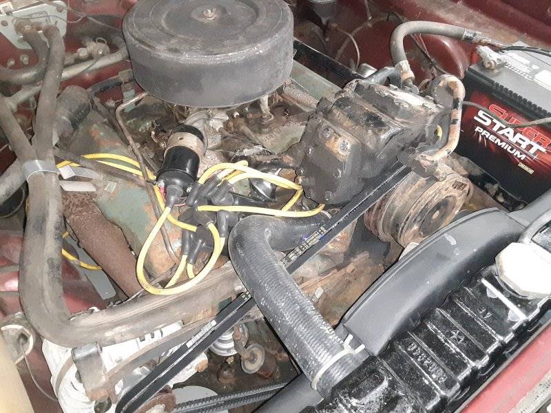

So the correct upper hose came in and I laid it out next to the one that was on it and also laid the lower next to the one that was on it so I could check fitment. The lower is incorrect compared to the original. It's missing a bend that raises the hose up away from the Kmember. Oh well, I trimmed it an inch off the radiator side and stuck it on with the original clamps. My handy tool made quick work of that.
Got it all together, filled it up with coolant, looked for leaks, and put the cap on it. I hooked up my timing light and fired up the car. Started up but timing was way retarded from installing the new distributor. I set the timing about 10 deg advanced and locked it down. I hooked the vac advance back up and adjusted the idle and mixture screws. I think it turned out great. Runs excellent now. Needs new plugs and some black plug wires now.

I went over to my storage unit and found my vacuum pump. I brought it home, gathered up my ac gauges and set out to the shop to pull a vacuum and test the system. It held vacuum for the most part, so I charged it up with Freeze 12 and man! is it cold! Clutch on the fan worked perfectly, too. After that success, I decided to install my LED headlights since both my bulbs blew. I pulled them out and both were date coded 12-5, I take that as December of 65, and since my car was built around Feb 25 of 66, those were probably the original headlights? I'm guessing so. I'm getting close to taking it out for a cruise. I can't wait!

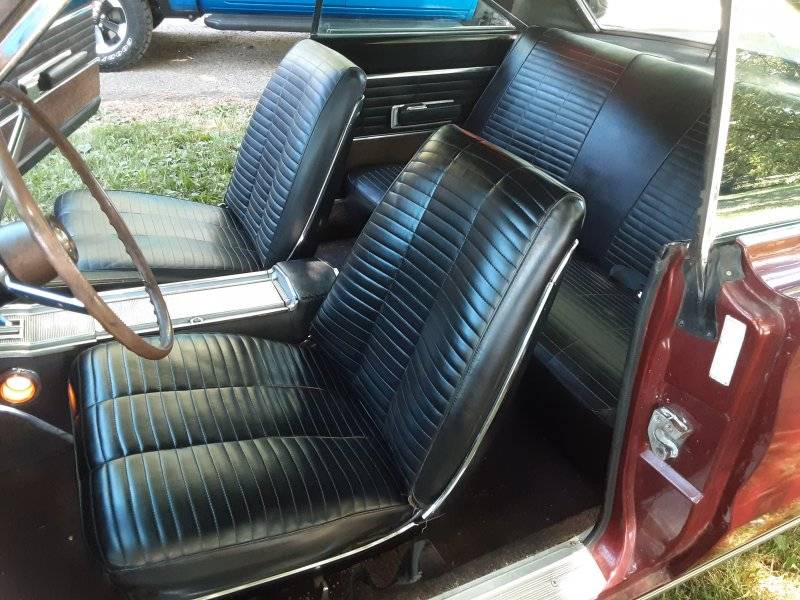

So I got it out,ac still works a day later, so takin it day by day, lol. Decided to wash 20 years of crap off it from inside and out. I'll post pics when I'm finished. It looks really good inside after some elbow grease.

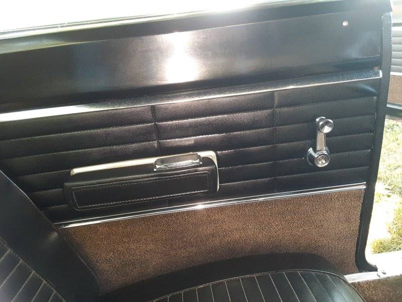

Spent 2.5 hours cleaning the car up. Before that I pumped up the ever leaking tire, and decided to clean out the parts and such that were inside it. I found some cans of Sea Foam and thought, I'll pour some in the tank. Wrong answer, read on. Most of that time was spent cleaning up the interior and glass. I think it looks fantastic compared to how it did. Got 20 years of neglect washed off. Before:
And after:

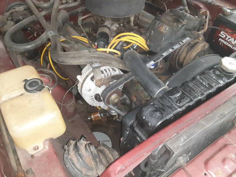

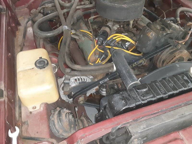

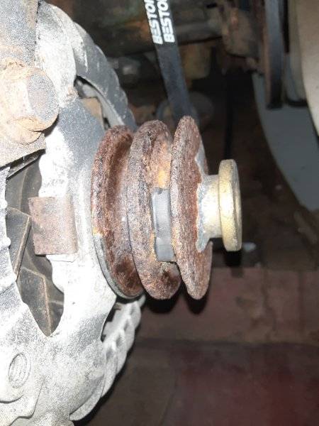

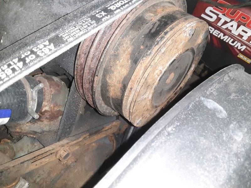

So today, the UPS guy dropped off my matched set of V belts. After a bunch of searching the internet and getting no responses, I finally got a call back from a place and they were able to get me a matched set to my specs. As you can see below in the pics, the NAPA belts were way too long. Way longer than they should have been and then kept stretching too boot. The alternator was almost against the apron. So the belts I ordered were 3.5" shorter, which should have been perfect, but I ordered 1/2" wide belt as that's what the NAPA specs were, at least I thought, but in reality these belts are 3/8" or 7/16" wide at most. So the belts didn't fit perfectly, well, not at all, but undaunted, I studied the problem and moved forward. I removed the 5/16" bolt that holds the heater hose support and the bracket to the alternator. I removed the distributor cap so the alternator could come in towards the water pump as far as possible. This allowed me to barely get the belts onto the alternator pulley. I then tensioned it, put the bolt back in, and adjusted it using the longest pry bar I own. I tightened everything down, and started it up. I turned on the a/c just for grins, and damned if it didn't blow out cool air. I went out and sure enough the expansion valve was damp with condensation. It wasn't as cold as it was before it leaked, but it was still semi functioning. This means the leak only happens at higher pressures. I have that part coming thanks to a member on here, and can't thank him enough. Can't wait to get it on and the system up to snuff. Since I have to crack it open anyway, I am going through all the connections and putting in the new green O rings.
So the next pic shows the new belts, you can see the alternator is in a much better spot now. The belts hang up out of the pulleys, but as rusty as these pulleys are, no belt is going to last long. I need to take a scotchlock to them and polish the rust off.
I found this chunk of rubber stuck in the pulley and had to use my knife to dig it out. What a pain, this is probably why one belt was stretched more than the other. I got it out and both belts tensioned perfectly.
