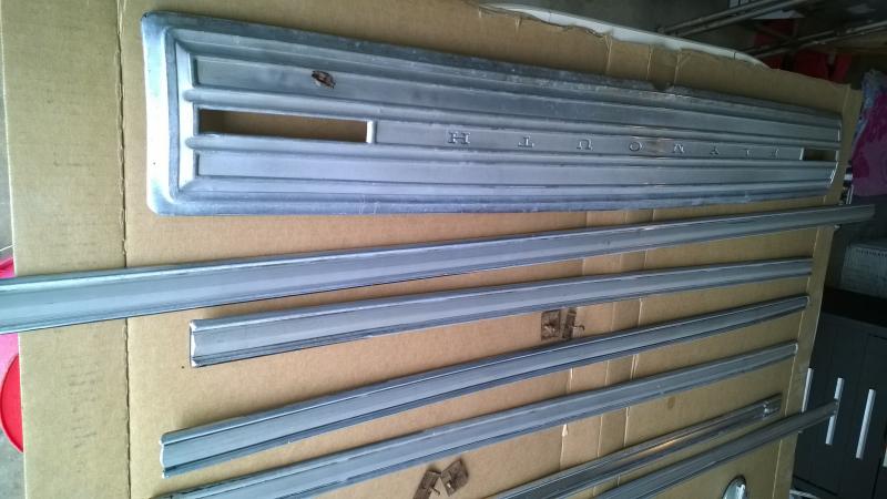

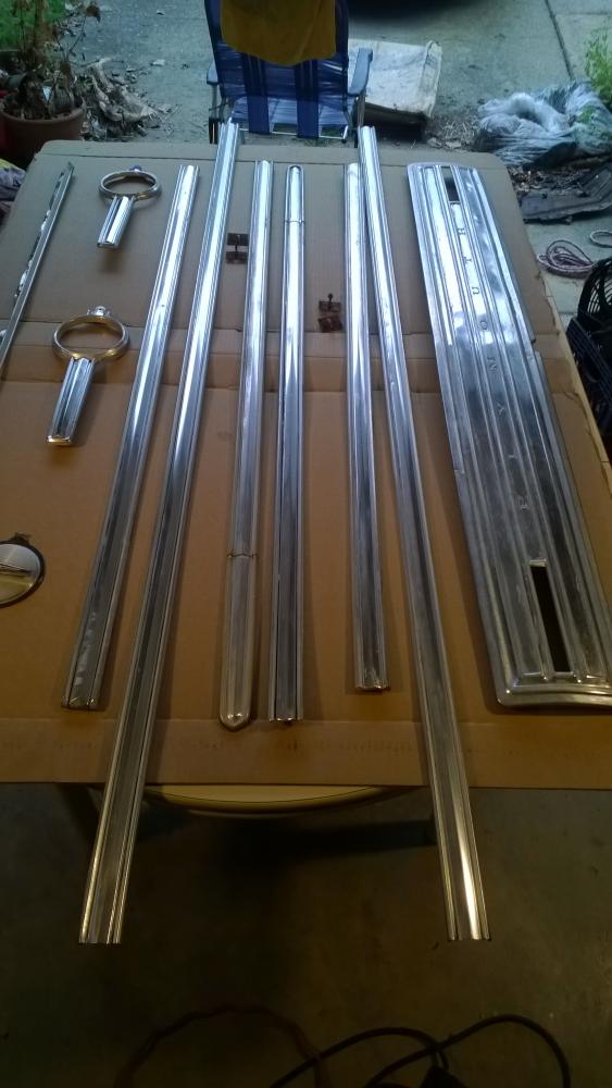

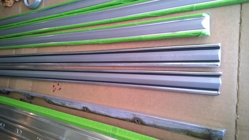

WP_20140915_17_00_09_Pro.jpgWP_20140915_17_58_48_Pro.jpgWP_20140928_09_11_55_Pro.jpgWP_20150208_14_30_29_Pro.jpgI didn't have the cash or desire for restoration, so I refreshed. Used paint stripper and metal polish and did not remove anodized. Gently worked bumps & wrinkles. Used Rust-oleum Metallic Paint & Primer In One, Flat Antique Nickel rattle can for burnished finish in the middle of trim. Looks great, get lots of compliments. This is a daily driver never a show car.
