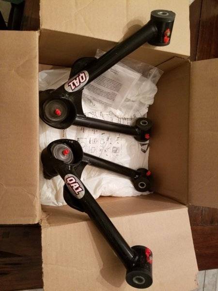

Bought the QA1 UCAs from Dave , very well packaged, shipped immidiately and perfectly described! Thanks man!!! Needed some good news, lol!

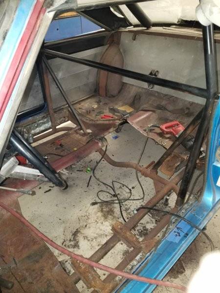

Well had hoped to have the old out and the new fitted up before my vacation ends...i don't know if that's gonna happen but the demo has started...

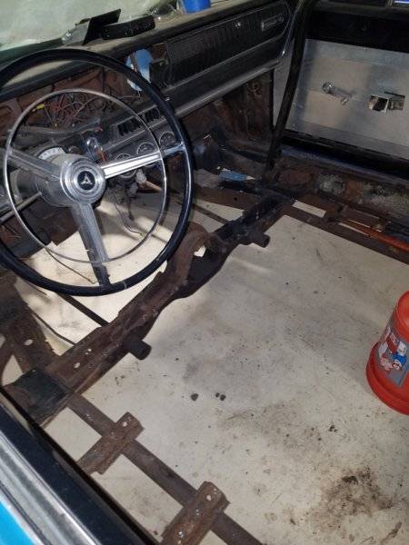

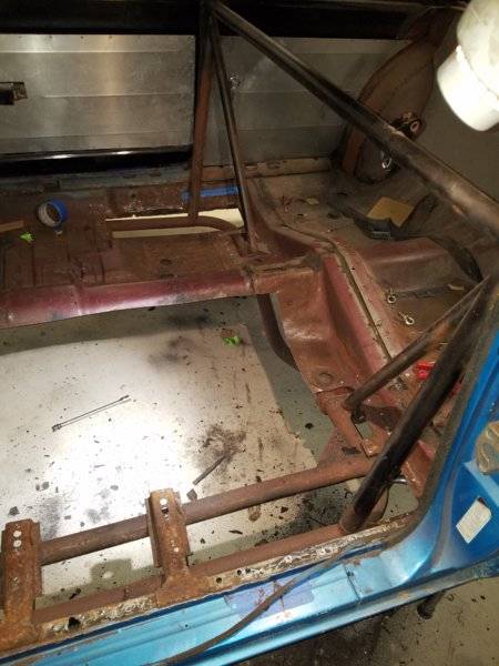

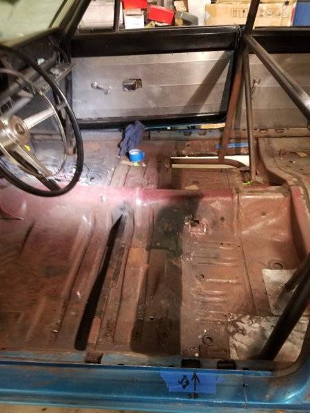

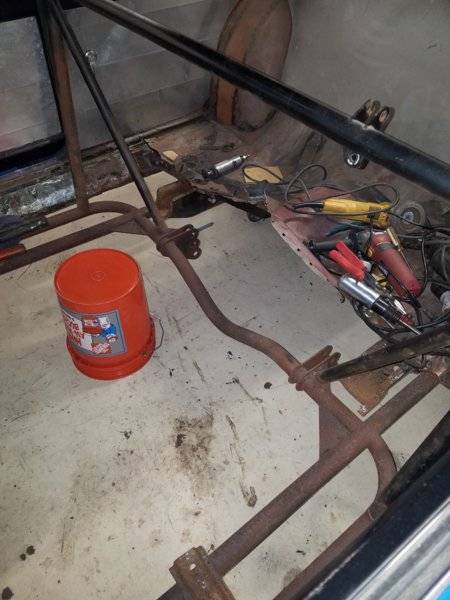

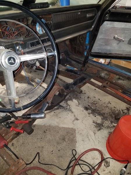

Well did some more drilling out of spot welds, grinding and air chiseling...all of the floor is out except the pinch welds at the fire wall...that can wait until I get it on the lift.
Came out pretty easy, the spot weld cutter kit I bought had 15 dual head bits and I only used 2 1/2 to go through 100 spot welds...best $15 I've spent so far...
I was really happy to find no rust in the rockers, trans crossmember is solid!!!
Now the fun of wire wheeling everything and coating it before the pans go in...any volunteers????

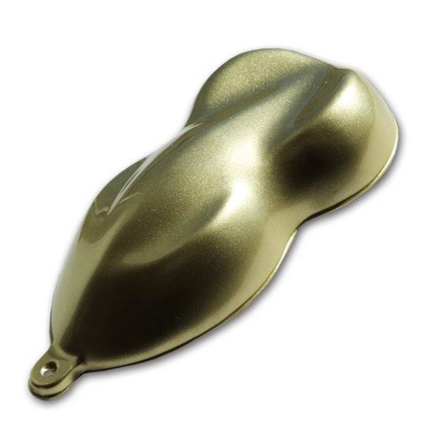

Ive decided to strip it and do all the bodywork and paint myself, probably a quarter at a time since I'm only at the shop on Saturdays..I'm still undecided on a color though...Any thoughts? Black interior w/ black vinyl top...
s-l1000.jpg Liquid Brass.jpg Champagne.jpg Light Gold.jpg Tru Blue-600px.jpg Arctic Blue.jpg
I like the gold also........ if you are painting it in sections; do a fender, door, and quarter together; to avoid any slight mismatch down the side caused by the metallic............
Ya Ive really become partial to the top two...there still another color I like but have not been able to find a good sample, it's kind of a satin silverish green...
I'll strip and prime a little at a time and when it comes time to shoot I will make sure it's done all at once...Im not a pro like you dub but I like a challenge, spraying is really not a big deal to me and feel pretty comfortable doing it. I've had pretty good results in the past... but like I told you on the phone the body work scares me!!! Lol! I don't mind messing up and having to start over on anything but jeez the cost of the materials is crazy!!!
Being as I own a gold 67 R/T, you know that gets my vote! I like the first and last gold. Last gold is more true to original, but the first one really pops. I don't think you can go wrong with either. Gold will be more rare than the blue. You just don't see many around. Done up right it's one of the best colors IMO.
