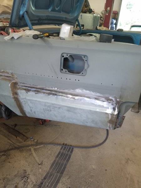

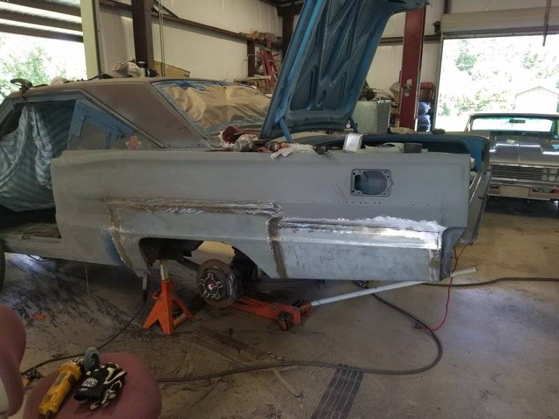

Made a lot of progress today. Got the drivers side totally welded in. Did the rear lower with a tig....wish I would have done the first panel that way....
Body lines matched up pretty well... not perfect but happy with the result for doing it for the first time!

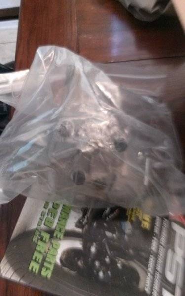

Got my new PST 16:1 steering box today. Ordered it Monday, boxed up real well.... Thanks to the guys @PST and my Cummins....

All the welding is done except for the flange that meets the lower quarter and trunk extension. Will shoot some more epoxy and start slinging mud I guess.

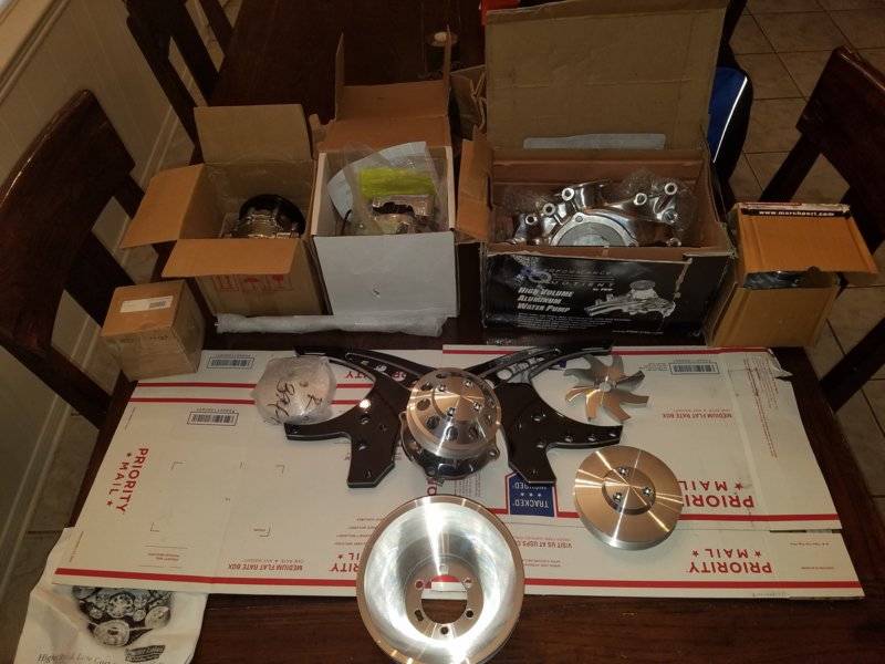

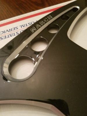

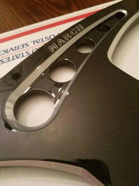

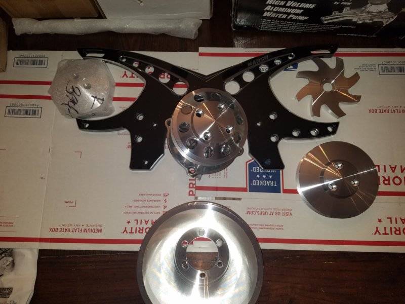

Everyine knowd that Im doing this on the cheap, or at least as much as I can, anyways found a steal on ebay and had to get it....I wanted a serp set up and was about to biy the Wraptor from CVF bit found this March set up $400 less! I would have rather had a self adjusting tensioner but oh well.
I will be getting rid of the aluminum pulleys, low mount ac comp/ brackets, polished wp ect to make up sone of the cost soon...
PM me when you get to that point...

I thought it was all brushed aluminum I pulled the bracket put and its actuall black with all of the edges machined. I really like it!
When I saw it I immidiately thought about your mill and how bad *** it would look on it.
I still cant make up my mind on a body color much less an engine color... kind of narrowed down to two, B5 and F5 variant

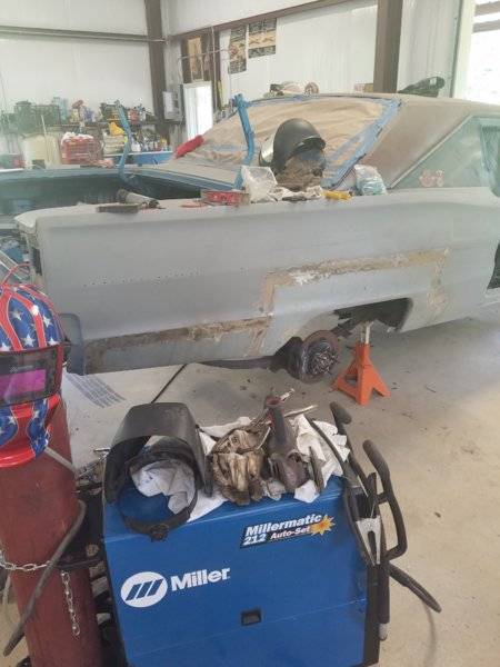

Well got the last bit of welding completed on the passenger side panels...thought I was done when i ran into a small problem.
It wasnt for lack of planning or so I think. I measured everything when I was tacking in each side...measured off the door jambs back to wheel well openings and they are spot on. Measured from the frame out to the leading edge of the replacement paneland they are <1/4 difference.
Went to put my big wheels on both sides and theres a 1" difference in clearance...wtf?
I measured from the backing plate to the spring perch on each side....ends up the drivwrs side tube is an inch longer than the passenger's side..
I knew i was going to have to trim the lip a little on the left but with the othwr tire on I dont have to do anything...it will fit perfectly. So with both wheels on I sat there staring for an hour contemplating a solution other than shortening one tube/axle....looking from the rear it is very noticeable and I dont know if I could live with it...
I have Moser axles and Im hoping they are the cut to fit varienty that still has enough spline to do it....2 steps forward 3 steps back...I didn't take a pic of it I was so disgusted ...
Mine was 1/2" closer on the left with the 70 rear. Didn't matter much with the smaller wheels, but too tight for the 275s. I put new perches on and equalized the space. Still tight though. 1" off sounds unusual.
