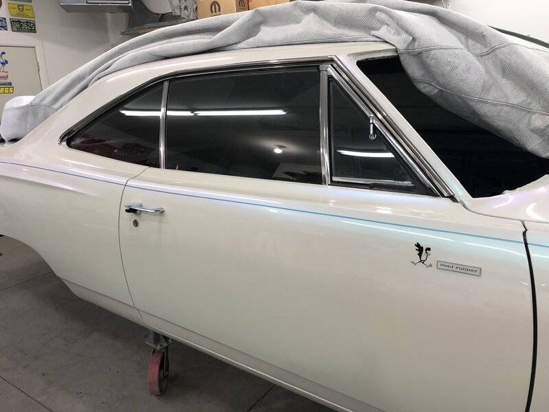

Glass looks great, wish I had the patience to do that. Might as well wait a bit before making the final adjustments. When you get the motor and drivetrain in the car, I'll bet you need to fine tune the door adjustment. I piddled around getting the doors and glass set perfect when on rollers just like you have only to find out they needed to be redone with the weight on the wheels.
