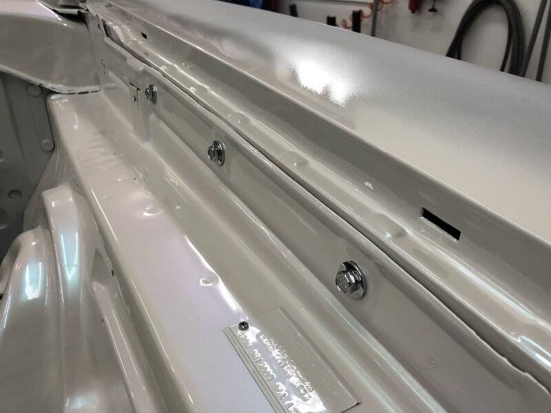

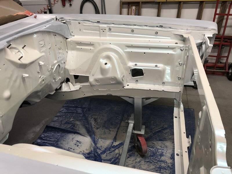

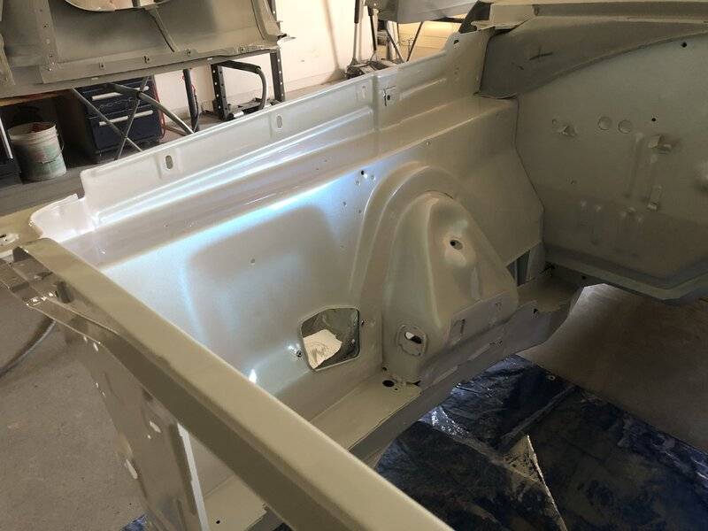

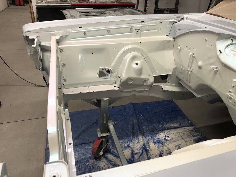

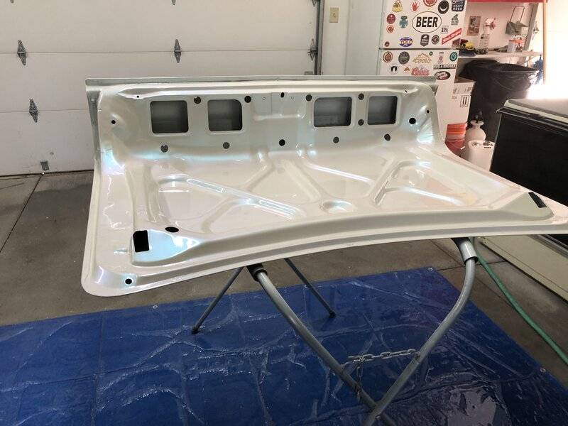

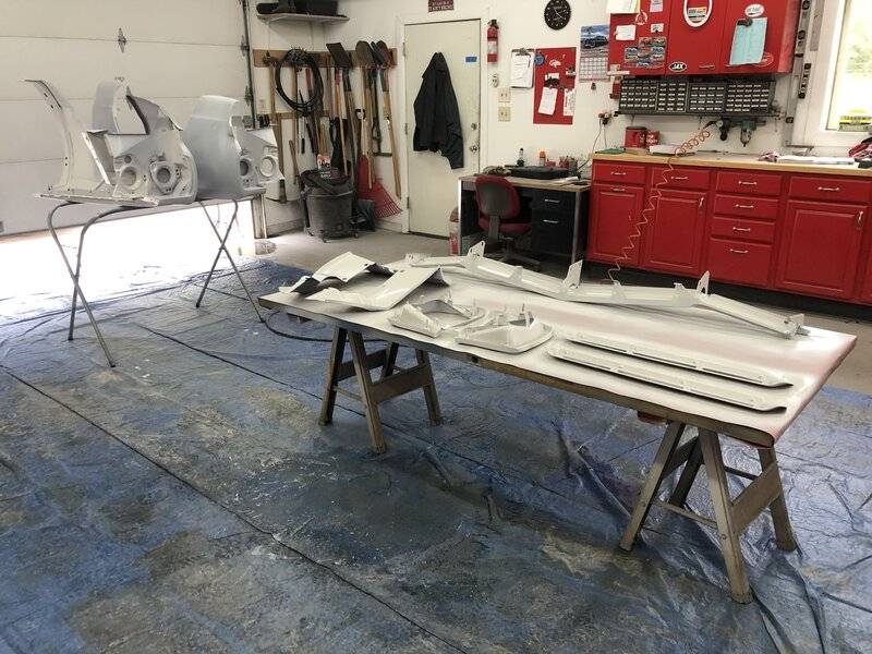

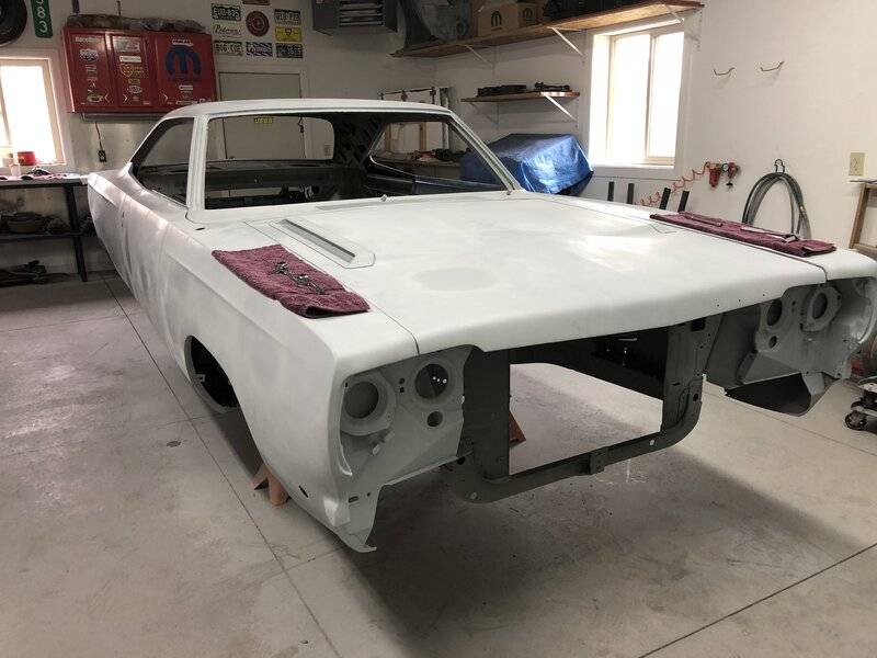

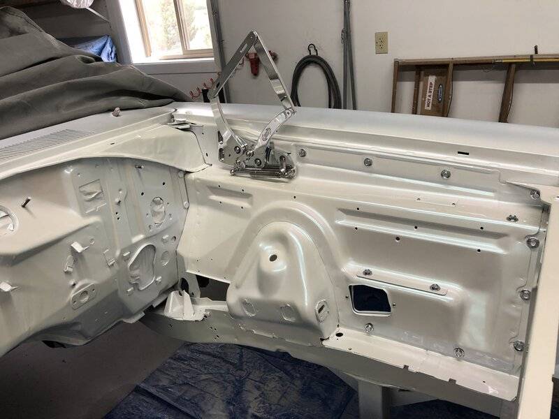

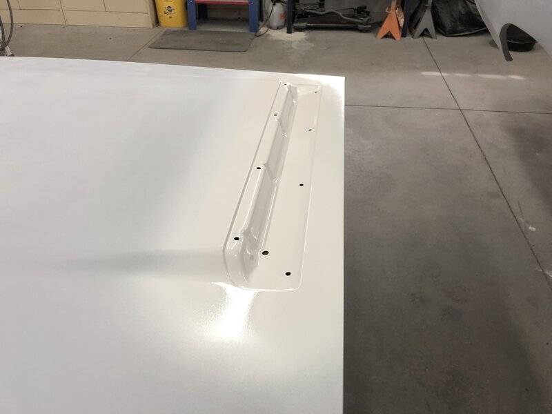

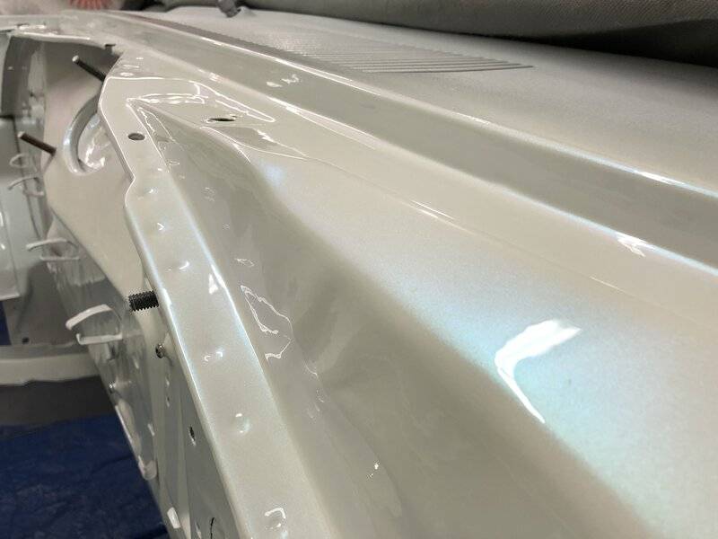

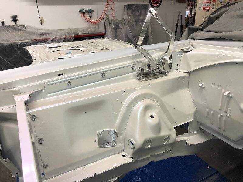

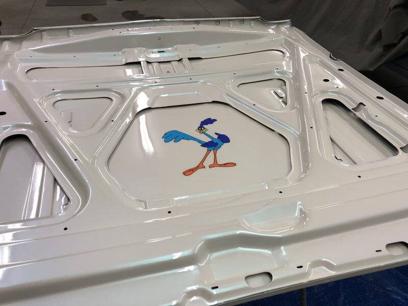

PPG Tri coat system.
That's the original W1 White with PPG VM4604 Blue Murano in PPG DBC500 as the inter coat clear.
Murano was used back in the 70s but was discontinued. I shot this car back in 79 with gold Murano and it looked shitty now that I look back at pictures. I was 17 and did my best.
Our local PPG rep is a friend of mine and tipped me off that they just started to make the Murano again. 4 colors, Gold, Silver, Blue and Red. My jobber had to special order it. $100 for 4 oz. The blend I'm using is 4 oz. per gallon of DBC. Keeps it simple. I had to figure that out after shooting 8 let down panels to make a decision. PM me if you want to go that way.
The thing about Murano is that its made out of fish scales rather than ground up oyster shells like most pearls. Only an idiot can stripe Murano, lays down real nice with a slow reducer. Pictures don't do it justice. Have to see it with the eye.
