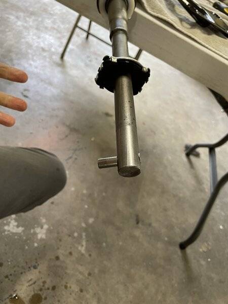

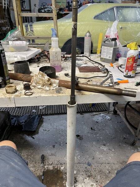

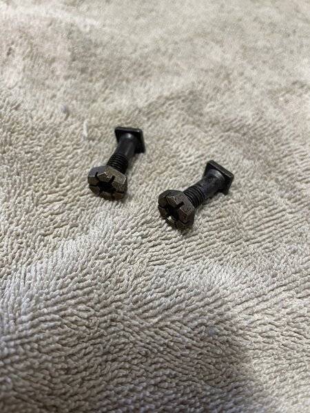

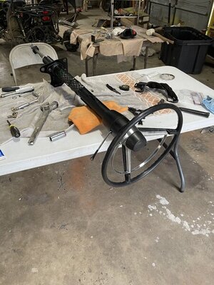

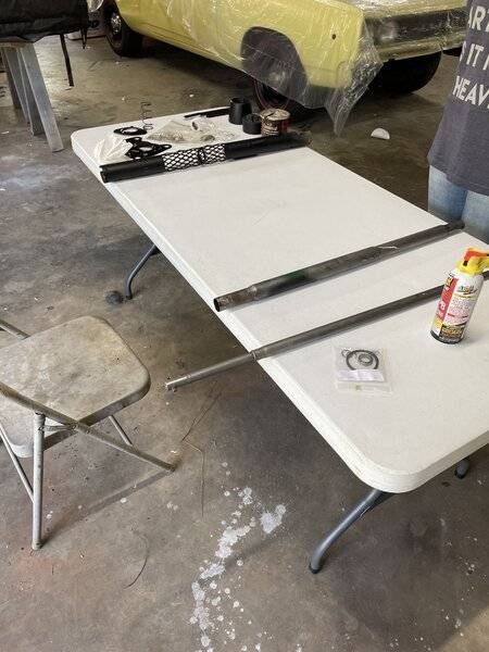

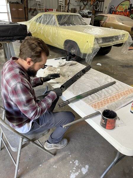

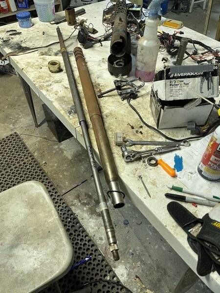

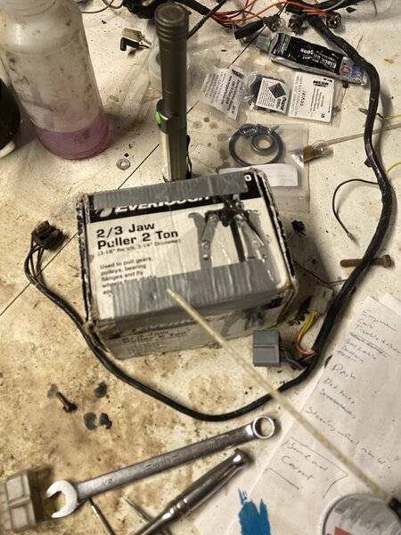

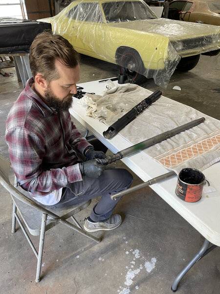

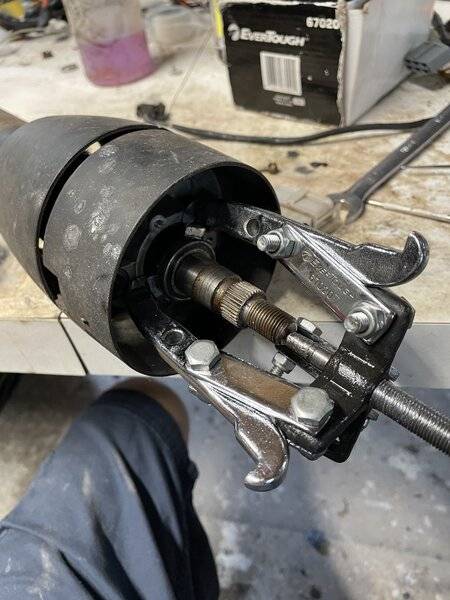

Spent the weekend getting my steering column done. My gauges are supposed to be here Tuesday and the dash has been waiting for months. Got all my parts from mega parts to do my column. It’s was pretty straight forward. I followed moparnation’s thread and all went well.went to oriellys and rented a small puller to remove the upper bearing, worked like a charm. Then blasted everything down to clean metal and soaking the parts that are to stay raw in evaporust then matte clear. Epoxy prime and satin black for everything else. The most challenging part was the two bolts that hold the hubs to the shaft. It helped to have my wife using a flashlight to look from the back and tell me when they were engaged. Gloss black on the firewall plates and all hardware soaked in evaporust as well. Other than that pretty easy and I’m pumped on the results.

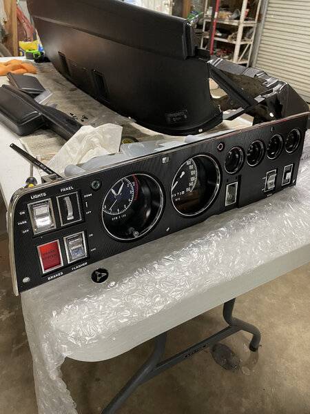

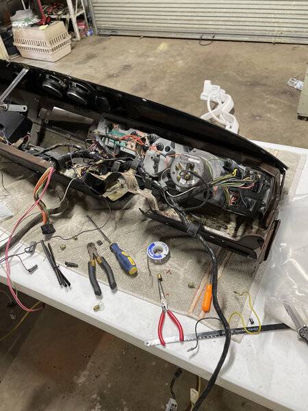

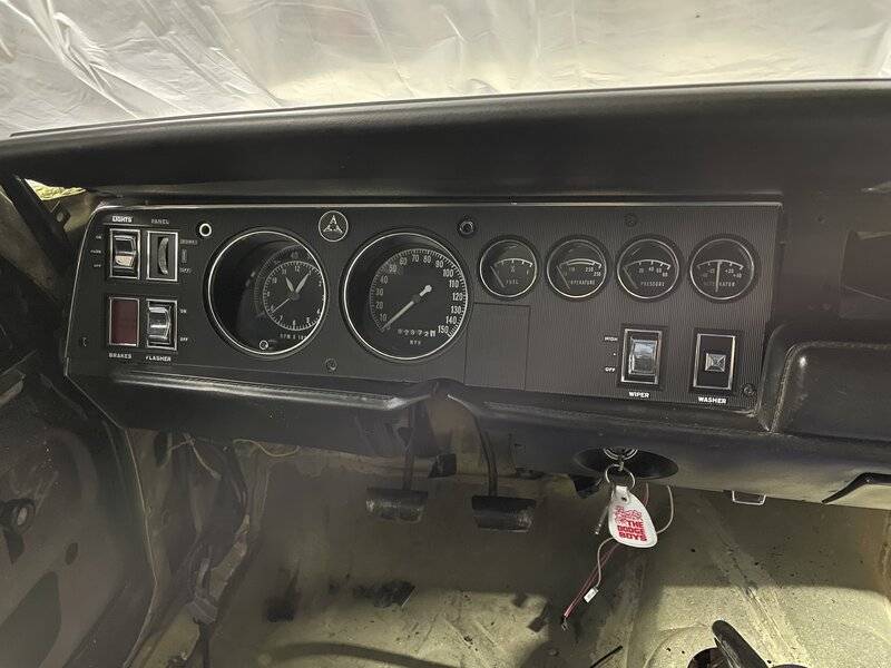

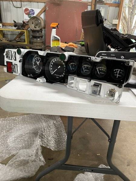

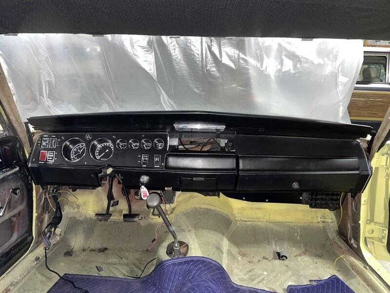

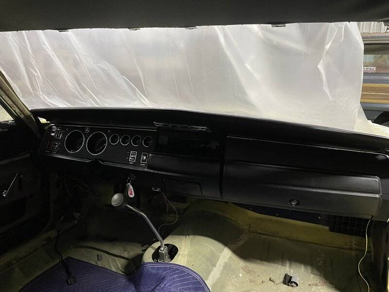

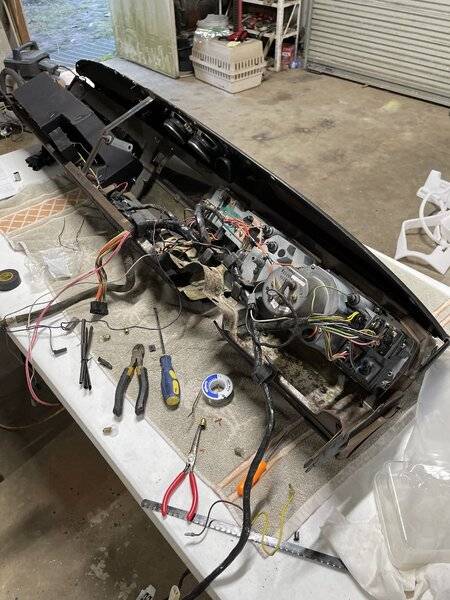

Finally got the dash all back together! Gauges done by Gary “Tachman” and they look great! Bezels all done by vacuum ornamental. New dash pad and original lower pads just cleaned up. Hoping today to get my column in, but should be able to crank it soon!

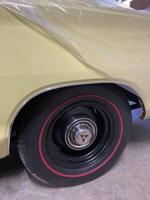

Wheel well moldings, yea or ney?
Definitely nice on the yellow!
Neither of mine had them, but who knows over the decades if bodywork had been performed...
I take that back, my white '68 I bought from the original owner DID have them.
