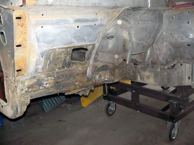

Nice dolly 61, anything to make the job more comfortable is time well spent. Gotta love Tom Petty (especially that album).
Thanks Devin I can actually sit underneath it now and scrape off the rest of the undercoating that I couldn't get to before. Hopefully now I'll be able to remeasure the frame rails and trunk floor to see if I did screw something up.

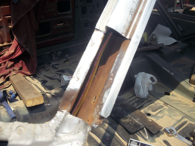

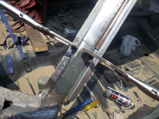

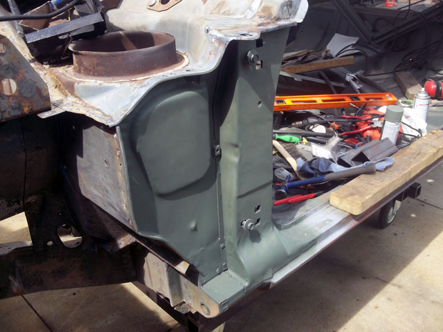

Been working on the Coronet and figured I'd share some of the progress. Today I removed a rust hole from the driver side a-pillar. bent up a new piece from scrap and got it fit in place. Maybe after dinner I'll go drill for spot welds and tack it in place. Right now it's on to the barbecue. :)
john you are still the man.smooth looking work.enjoy the bbq.
Thanks Johnny, the BBQ was just what I needed. I'm still full lol.

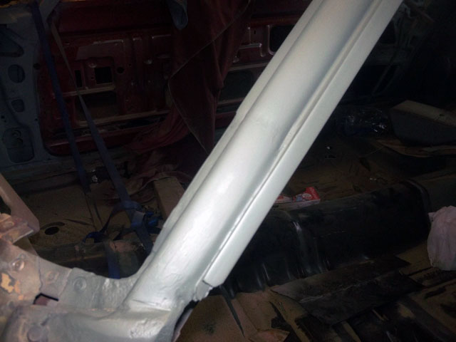

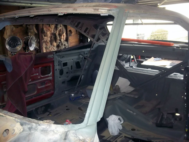

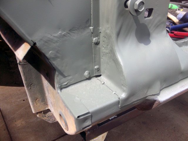

I ended up welding that patch in today. I think it looks good and at least it will once the body work gets started.
Once I was done with the a-pillar I figured that I would continue removing undercoating because that's always a fun job to do haha. The needle scaler got a workout today. 40+ year old undercoating and it was still soft. It may have just been oil soaked but it seemed too high up under the fender to be soft from oil. Not that it matters cause it's gone now :headbang:
It don't look rusty,I'm sure you'll take that trade off? Looking good,piece at a time!
Pretty slick looking patch! She looks pretty clean so far, maybe things will get easier for you???
looking good John. if I didn't see the picture where you cut the A pillar, I would've never known you did anything.
Hell yea I'll take no rust all day long, At this point I found that I have more good metal than rusty metal. The front of the outer passenger rocker has a hole, the kick panel on the passenger side has a hole, and the fresh air duct in the cowl has a rust hole. Knock on wood I believe that is the end of my major rust problems.
Yea Devin, I'm sort of amazed at how it turned out as well. I ended up forming it over the old a-pillar before I cut it out.
Thanks Roger, That was one of those patches that I thought was going to be harder than it turned out to be. When I saw how Mopar4Don sectioned in his a-pillar on his Charger, figuring out the patch on mine came into focus.
Wow my thread dropped down to page 5. I guess it's been awhile since I posted anything about the Coronet. Not too much to say about it, just been doing a lot of sand blasting. My garage and driveway looks like a sand dune most of the time but the front end is looking better with every blast. No major rust to report just pitting. The pits are gone and replaced with new metal and the blasting continues. On a happier note I'm employed again, finally. It's a contract position with HP as a Network Engineer. The pay is excellent and it should last the better part of a year so I should be posting pic's of new metal within the next few weeks. :)
