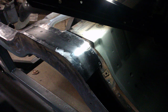

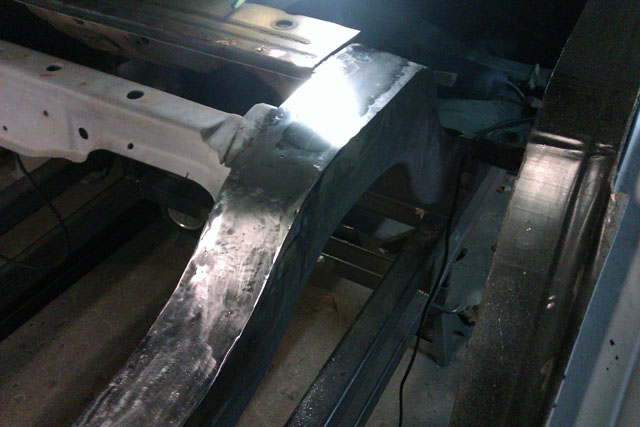

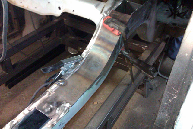

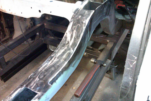

Today I started boxing in my frame rails behind the wheel wells. I'm still not sure if I should just go ahead and box the whole frame rail or just the section behind the well.

Me too Devin. Most of what I hear from them is on the radio and that was the first time I heard that remake. I got mt first welders tan of the year boxing that part of the frame. Looking forward to many more this year as I'm hoping to be able to kick *** on the Coronet this year.:headbang:

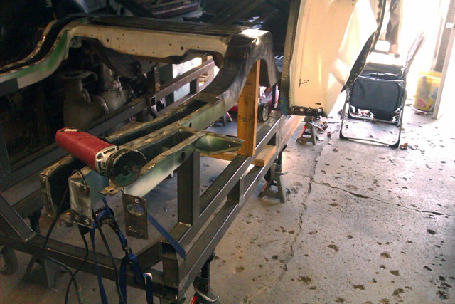

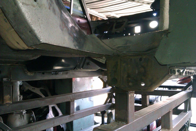

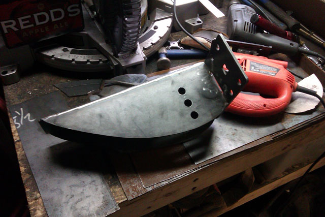

Got more of the frame boxed today. I just need to finish off the front portion of the frame then I can start on reinstalling the wheel well. Before I can finish off the boxing I'm going to install the frame relocation kit. I figure it will be easier with the floor removed.
john, i have got to catch with you thread,reasons for boxing?something new i was not aware of. thanks
Hi Johnny, The reason for boxing the frame is I'm installing a mini tub. The inner wheel well will now be attached to the frame rail. I have to cut off the flange on the outside of the frame rail so the wheel well will sit flush. The frame will be weaker because of the missing flange so boxing restores the strength and then some.

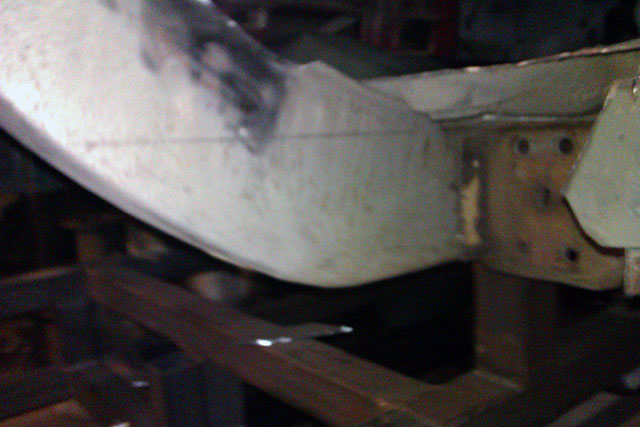

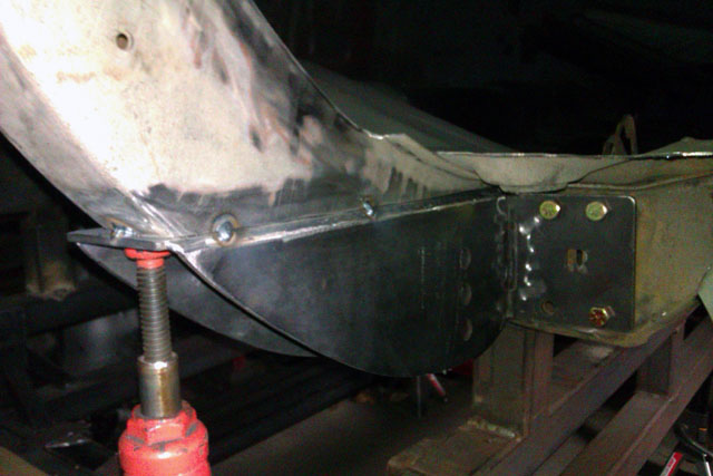

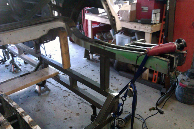

I got the scary part done today I chopped up my frame so I could relocate my springs.
I did make sure that my frame rail wasn't going anywhere.
I then put the new spring hanger in place and made sure it was square.
I got it tack welded in place but that's as far as I got today.

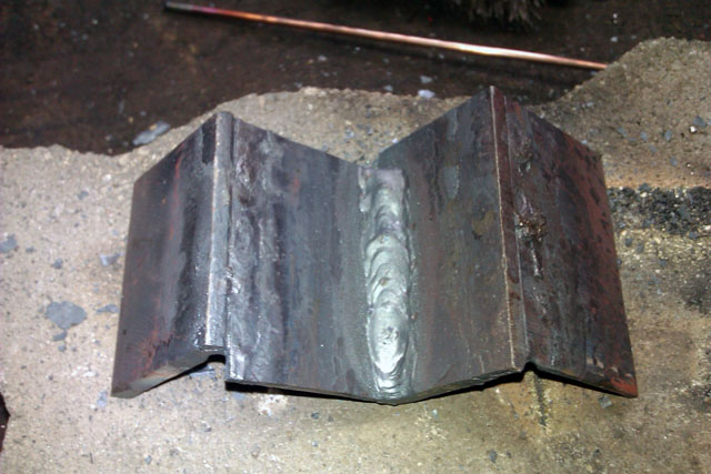

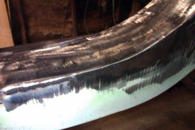

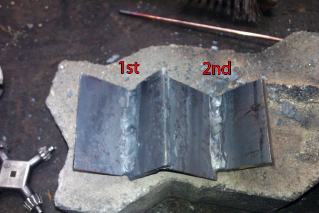

I'm welding these spring relocation brackets in place and I figured out pretty quick that my MIG gun won't fit in the corners. My Oxyacetylene torch fits so I figure I'll just gas weld it in place. I haven't gas welded in 30 years so I thought it might be a good idea to do a couple of practice pieces to see if I even remember how to gas weld. The spring relocation bracket is 3/16th's and the frame rail is 14guage so that's what I set up for practice. I was amazed how far up onto the 3/16th's I had to be so I wouldn't burn through the 14 guage. The first two passes you can see are under cut pretty bad. Yea I'm rusty.
On the third pass I'm getting back into the swing of things. I'll be able to do this:headbang:
I haven't gas welded for years either but it can be a lot of fun especially on thinner metal. Nice to see you forging forward again.

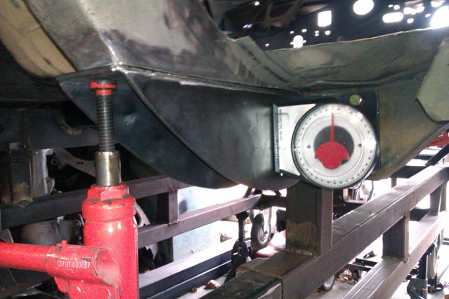

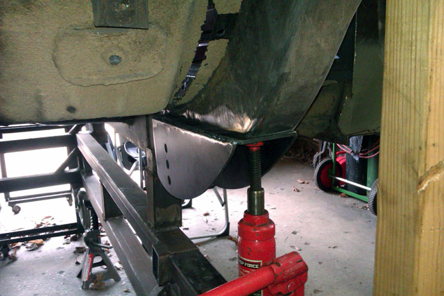

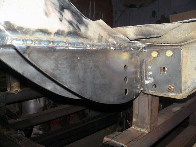

Well today was a littler warmer than yesterday but still stupid cold. I wanted to get some welding done so I ended up firing up the heater and I brought the gas grill in and fired it up as well. It got nice and toasty in the garage so today was a welding day.
It's times like this that I really wish I had taller ceilings and a lift in my garage. I'm 6'6" and stuffed under the car is not fun at all. My welds aren't pretty but they are solid.
