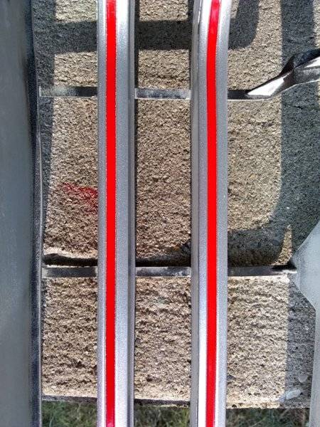

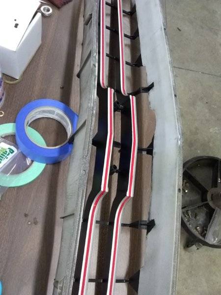

So I was worried at first as the red wasn't covering up. But it turned out to be a blessing. It kept me from putting on to heavy of a coat at once. I put 4 light coats on about 1 minutes apart . As soon as the last coat went on I waited 1 minutes then started pulling the red stripe tape. Worked great and looks pretty good for my first try. IlI' give it a day or 2 to cure then start the next color

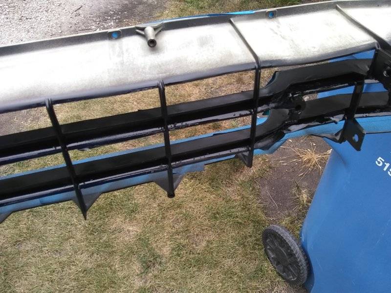

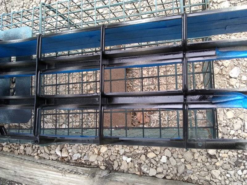

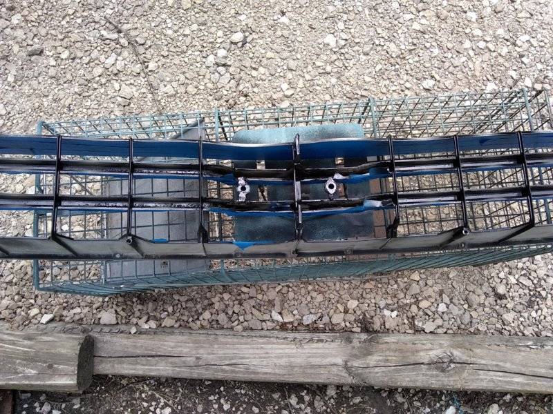

So back to the grille. So I am going to do the satin black next . Got everything taped off.
Next I used satin black paint from totally auto. I painted the back side of the ribs first then the edges before flipping it over to paint the other side.
Pull the tape off as soon as it's painted. So far so good.

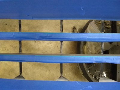

Dark argent next.

Taped and ready to go.
