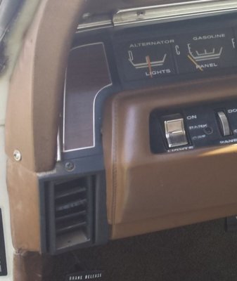

So I finally got some time in the garage over the weekend! Yay. First I installed the hard to find Tbolt I was lucky enough to receive from a great friend! Thanks Justin :lowdown:

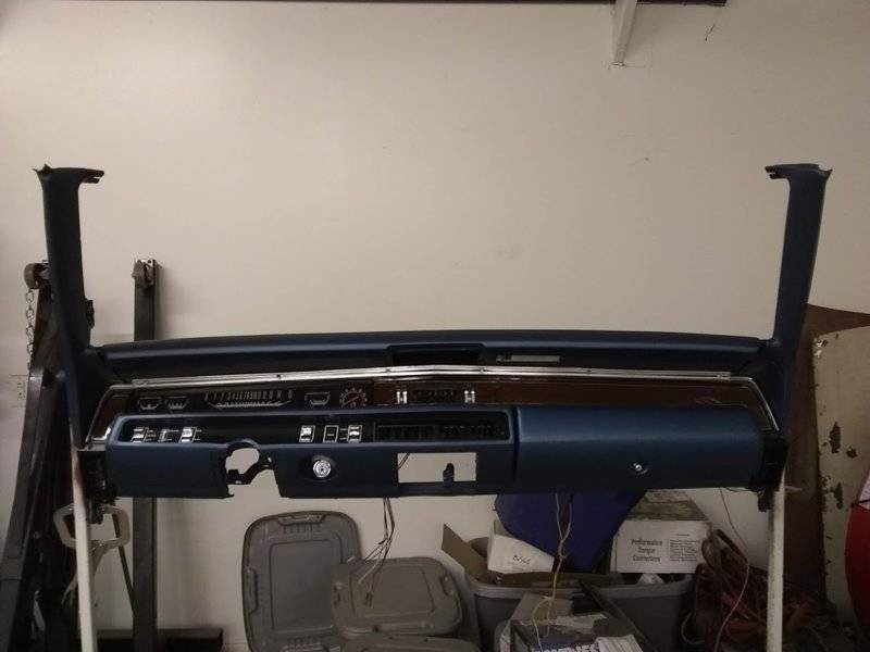

I then installed the dash pad, AC vent surround, switch panel, and AC vents and glove box lid. Lots of off & back on fitting. I found that only installing the top three screws tight on the dash pad mad it easier to put the switch panel in, then tighten the rest up after.

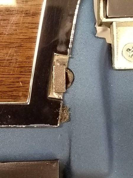

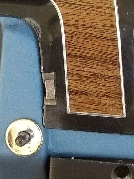

I noticed the Tbolt showing on the left side. I looked at Justin's dash for reference and thought I saw the same amount showing. Is this normal? Still have to drill the attaching holes for the Side AC vents.

One question I do have is did the 2 & 3 speed wipers have the same switch panel?
I still need to figure out how I'm going to letter the extra switch for the Gear Vendors on/off.

Thanks SoCal. I may have to put a little black paint on it to try and hide it a little.

Thanks PPRT! That also gives me a visual for how the AC vent matches up. I may have to try and adjust the hockey stick down a bit to mate up like yours. How's the SS coming along? Looks like a garage weather weekend coming up.
So here's my current dilemma. I'm using the second rocker from the right to power my GearVendor overdrive. I'd like to put a raised font that matches the other switches underneath it and on/off to the left side of it. Anyone have any ideas. I don't really want to just slap a sticker on there. But I may have to resort to something like that.
I think I'll also wire in a relay to cut power when in reverse, I've heard that is hard on them.
