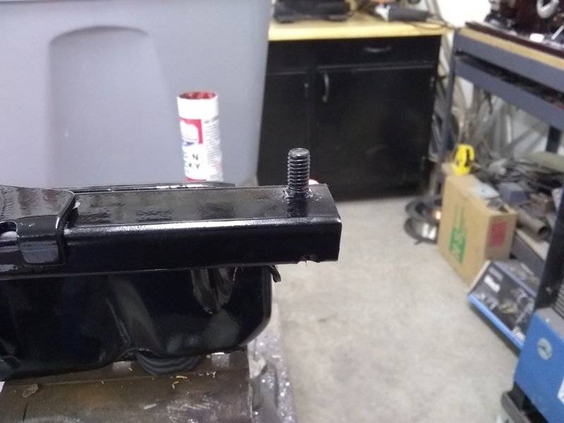

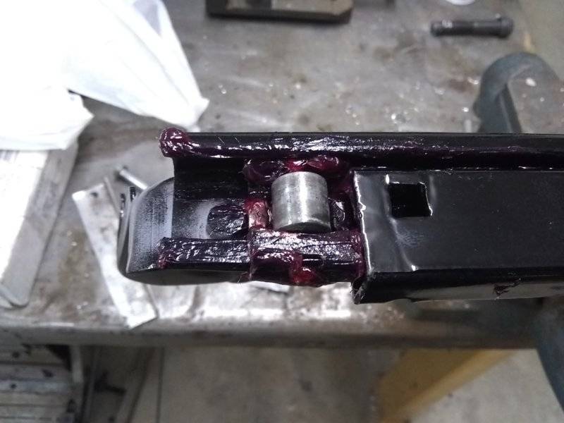

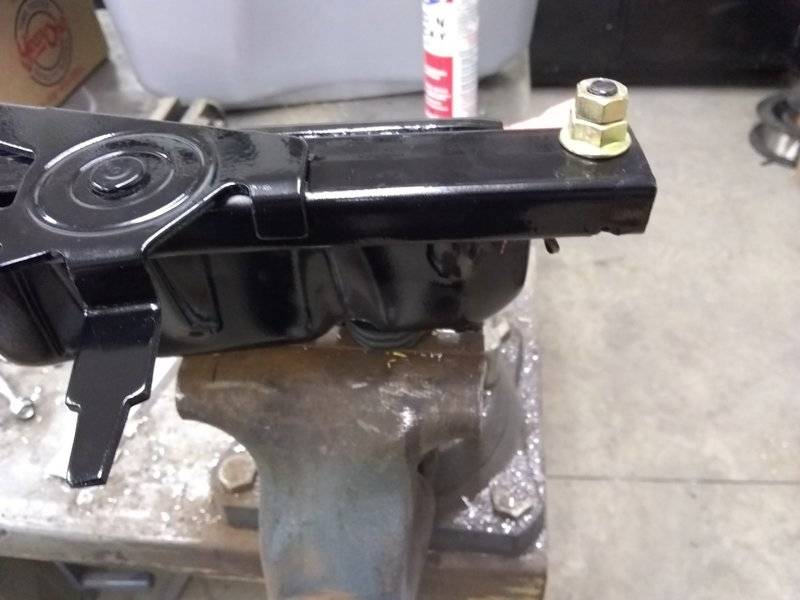

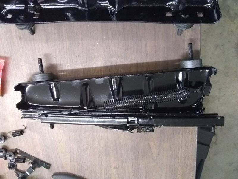

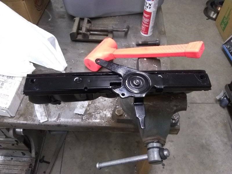

First I straightened all the cages so the balls would stay in place. The I assembled on with out grease to make sure I had it right. So on the 3rd try I got it figured out.
Grease up one cage, line up the track and slide it on. Then slide it till it opens up at the other end and repeat.
I used a oversized nut as a spacer then a nut to pull it up into place. I need to get 4 more as I had to cut 4 of them off to get them apart.

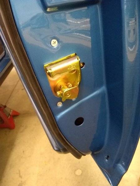

Today I started on doors. Got the new latches in, look great. Got them adjusted and working. I'll probably have to readjust the doors after I get all the glass in.

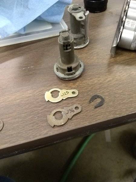

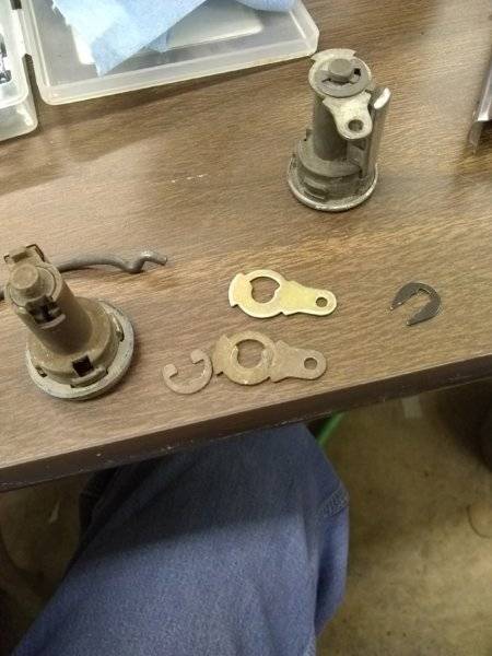

Had too rework the repop key locks. The holes we're to small for the rods. So I removed the circlip and drilled the out to .136. They were .125.

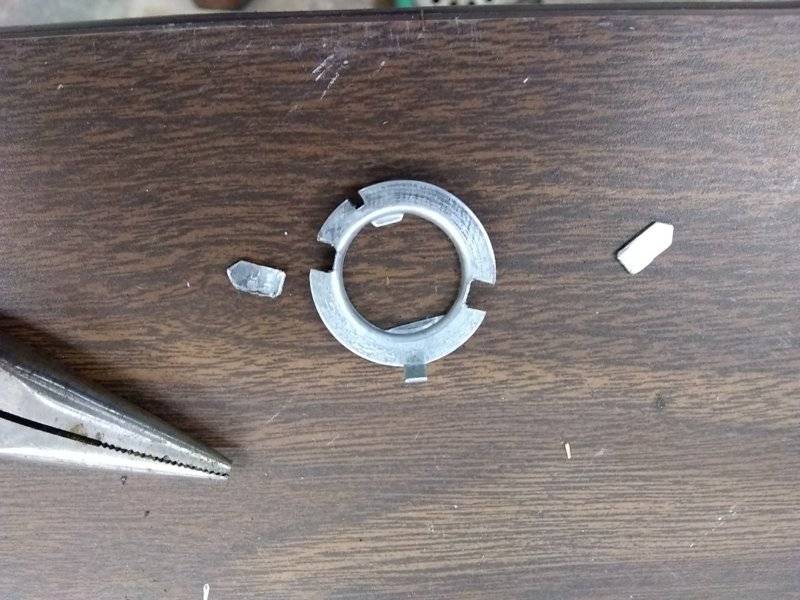

Next was remote mirror. This was a bit of a challenge. First the rear screw didn't fit the hole (too small). The stud for underneath had the threads buggered. The nut they supplied had bad threads. So after I got all that figured out, the sheetmetal washer had me baffled.
So I broke two of the tabs off. And just visually oriented the joy stick correctly.

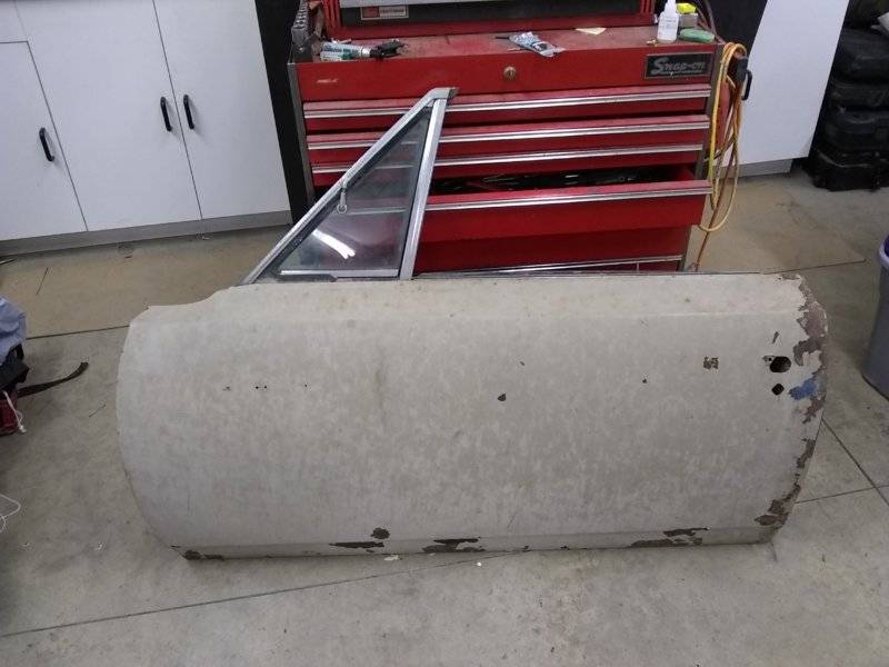

Tomorrow I start on wingvent frames. I brought in the door I took off of my first RR when I put fiberglass doors on. I'll be using it as a reference for putting my windows back in.

So this morning I got some synthetic grease like used on poly bushings. Has no smell, really sticky, and also is almost clear.
So I coated the door latches after they were installed .
