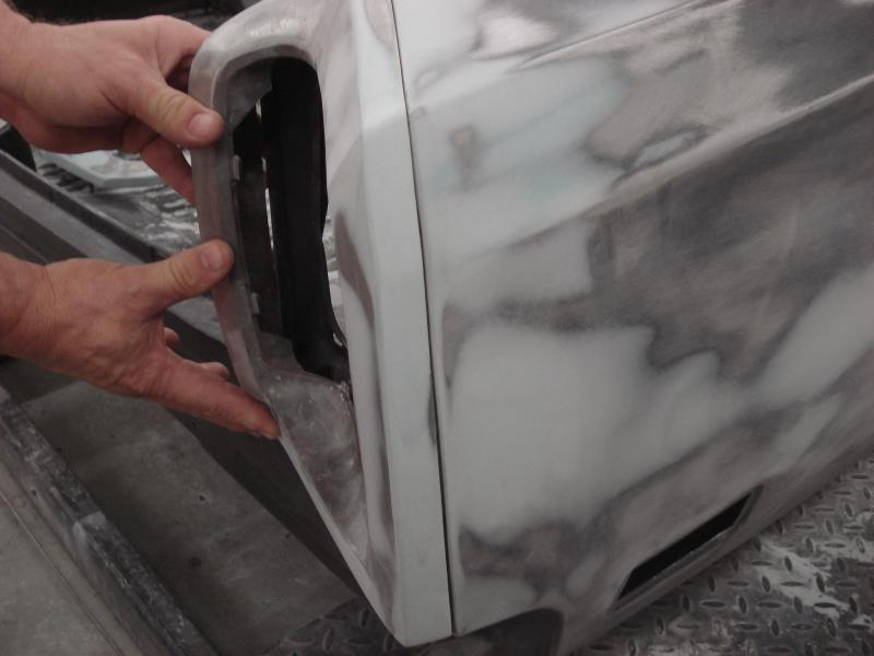

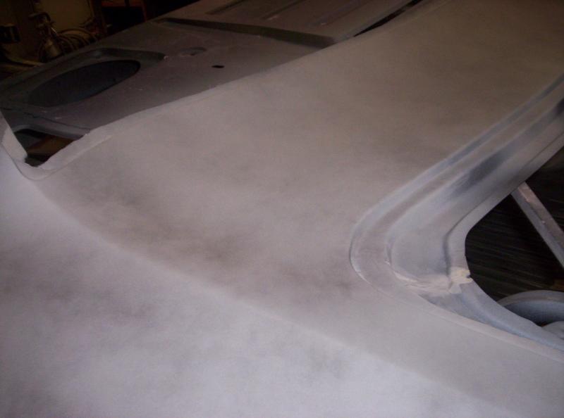

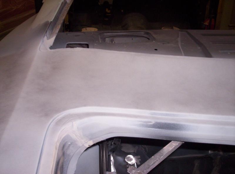

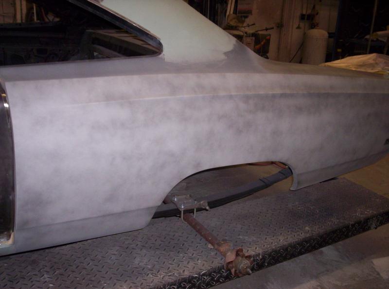

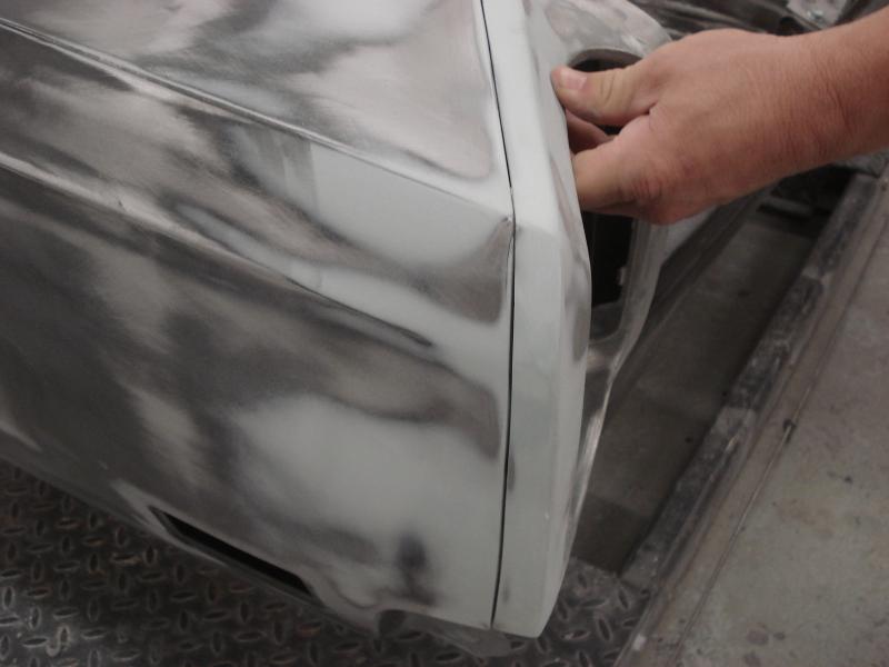

Progress !!! Here's pictures of the seam filled. I need help getting a paint code for Sikkens for B5 blue.
Looking good! Has your shop worked on tail extenisions yet? That was the area I had to spend a lot of time.

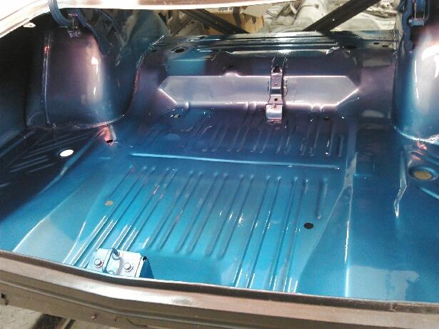

The GTX got some color today!!! Just the trunk, but still excited to see some B5 on the car :headbang:
It's not pearl, just the reflection of the heat lamp farther in the trunk.
That's going to look great when you get it on the rest of the car. course, pearl would've looked awesome as well.
I really love how the mini tubs turned out! You'd have to look close to notice.
