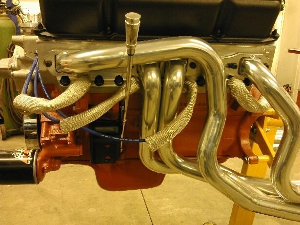

Well got a little more done over the weekend. Got the new jets so reassembled the carbs. Got new brackets for return spring & throttle cable installed. Also ordered Taylor 8" plug wire protectors. Very nice product, a little tuff to install on 90 degree boots but can be done.
I may have to put a straight or 45degree boot on 5&6.

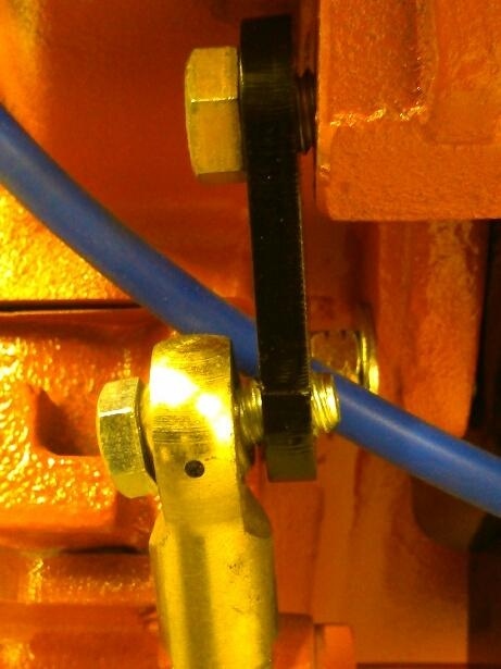

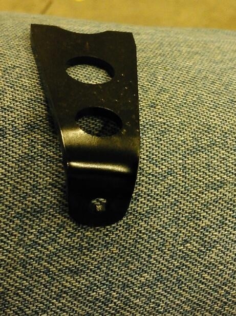

Made this bracket and put it on the motormount bracket to help hold a plug wire on the other side.

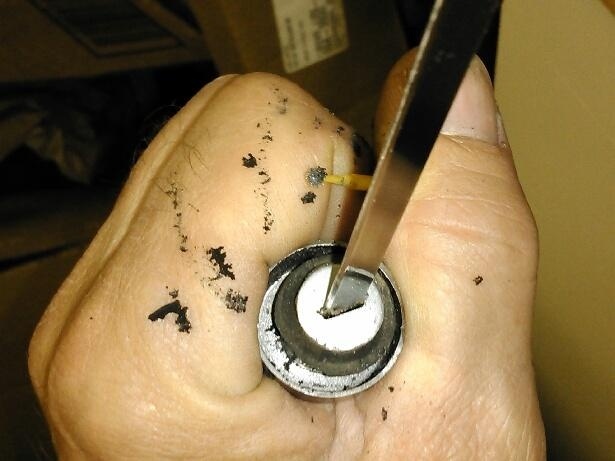

So I ordered a tranny dipstick & tube from Mega parts. Good news, it arrived quickly, cheap shipping,& came with the o ring. Bad news is the inside of it was filthy. You can see the powdered rubber I cleaned out of the dipstick lid. So I was wondering what was inside the tube so I ran one of my 20 ga shotgun brushes down it and look at all the dirt that came out on my pants. Moral of the story just because it comes in a sealed bag doesn't mean it's clean!

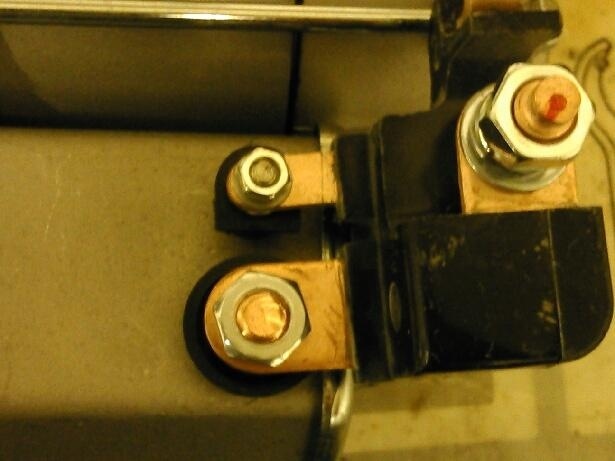

Got a new starter from DB electric off ebay. Wow I ordered it one day had it the next. 1 year full replacement . I removed the terminal extensions.
And great news It can be installed with headers in place!

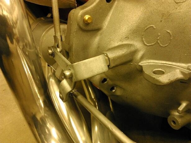

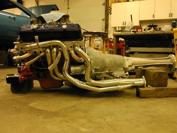

I mocked up the tranny to check the starter and a few other things.
The bell crank clears just fine. I need to get the upper bell crank pivot and rod to the carb to finish up the fitment. So far so good!
Yes it's a mini starter. I had seen several people had bought theirs. Was only 69$ free shipping. The powermaster starters were about 250-300$ and basically same starter with a billet snout. My set up is 10:1 440 so I figured it would be fine. Headers are TTI BTW. I entered 94 Dakota when ordering the starter

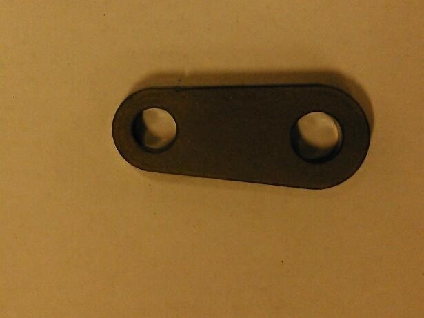

Here's the tab I made for the torque link. .47 hole at one end and .4 the other for 3/8 & 7/16 bolts.
Just put it on loose to may sure it fit. I'll finish the rest after the engine is in.
