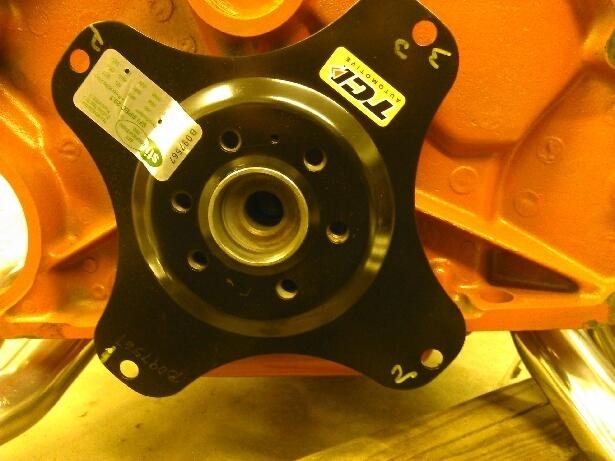

The flex plate only goes on one way so get it lined up first. I also took this picture to verify it has a SFI approved rating if needed later.
I used ARP fasteners and followed the directions for torque & thread locker.

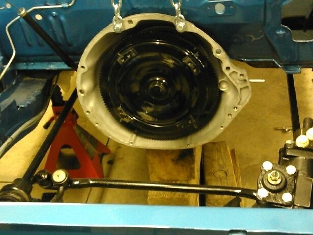

I put 1 quart of fluid in the convertor per PTC instructions before installing. Also I check for convertor engagement. PTC says the convertor should bottom out then come back .125-188 when mating against the flex plate. After checking mine was .190 I think the extra .002 won't be a problem. Also lay your flex plate against the torque convertor mounting holes to get it oriented right. It will also only mate one way. This will save you getting a couple bolts in and then finding it doesn't line up on the next hole.
You can see the interference point for the Gear Vendor OD. Per instructions the say you may have to clearance for the corners.
So I did. Keep in mind that earlier I noted the tranny poly mount was .25 taller than the one I took out. Well after installing the engine it was still hitting so I will have to modify the crossmember.

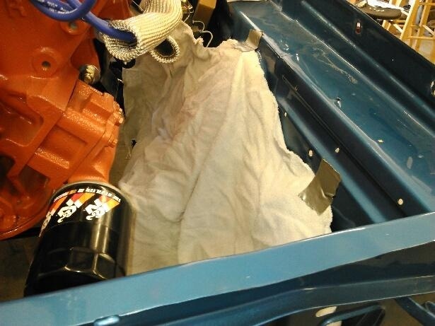

I put towels on the fender wells to keep from scratching them during the install. I also used wire to hold the headers while lowering the engine.

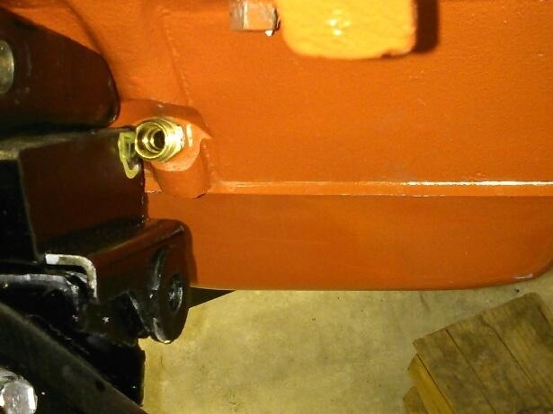

I had to clearance the motor mount a little where marked to get the compression fitting for the dipstick back in.
