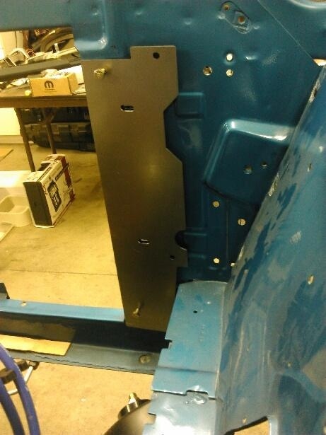

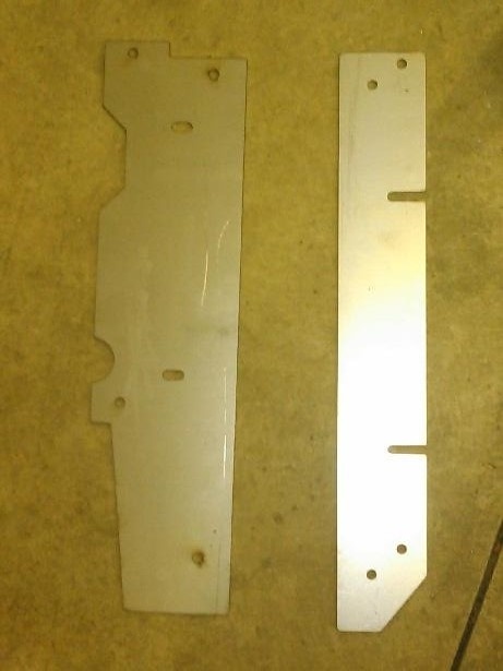

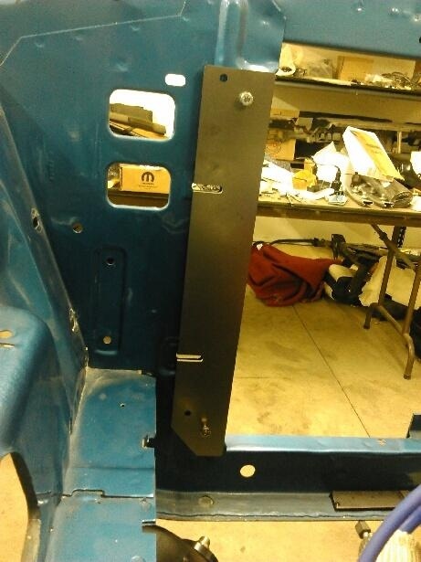

So here's some of the conversion brackets I designed and had made. For 22 to 26 radiator. I even put the original slots for the AC condenser in, in case I can use them.

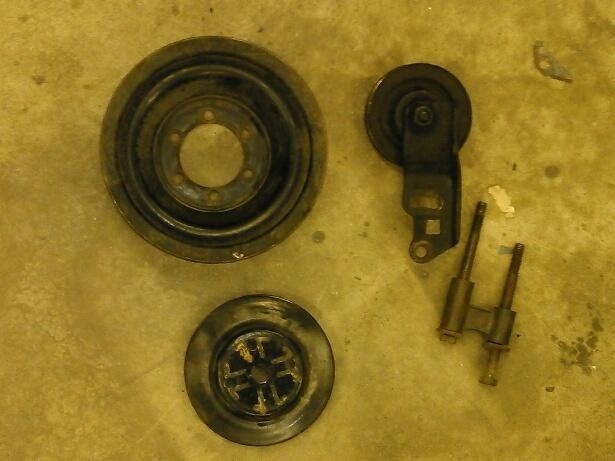

Got all my pulley parts!
