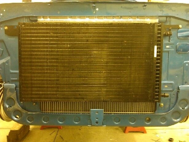

Well got some work done yesterday! My first day off since the 4th. I got my brackets finished up for installing the 26" Griffin radiator on the 22" support. turned out well I think. I ended up with .800 (11/16) clearance between the fan clutch and radiator.
Hung the condenser to see what I had to do for brackets. Then pulled everything back off for black paint. There is more details on my thread 26" in a 22" opening in the cooling section.

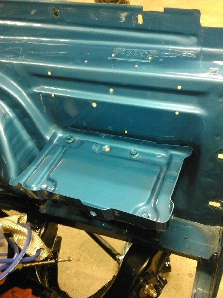

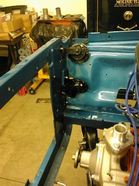

Horns on, battery tray, and fender tag.

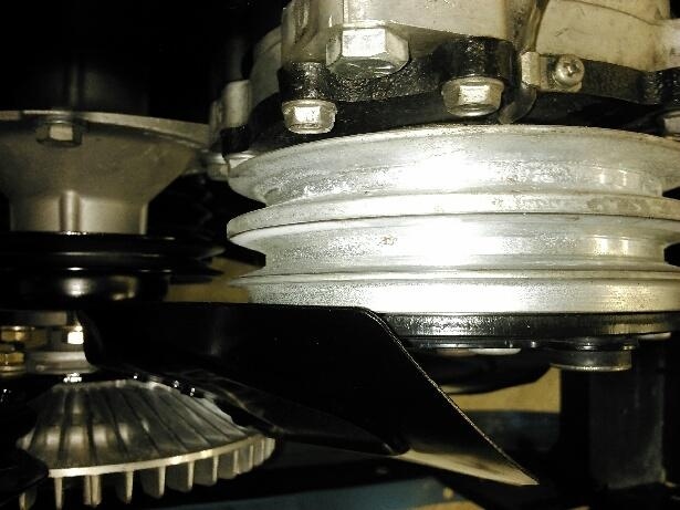

Well I did some work over the weekend. I got the new PS pump bolted in. Had to shim it a bit to get it square to the crank pulley. I noticed I was missing the top bracket for the alt. I then checked my waterpump pulley against the crank pulley, hmmmm doesn't look right. About .120 to far forward. This made me scratch my head. So where's the problem. Well I came to the conclusion it must be in the aftermarket dampener. So working on making a shim to space it out. So next I might as well try the AC bracket. Well at least it was consistent with the rest of the day. The bracket has the compressor using the front two pulleys and I need it to use the rear two. In the position they want it, it also interferes with the fan.
So I didn't get a whole lot accomplished. Looks like some more bracket fab work. I may call Classic & Vintage to see what the offer for replacement stuff for a car that already has AC. May save me some engineering time.
