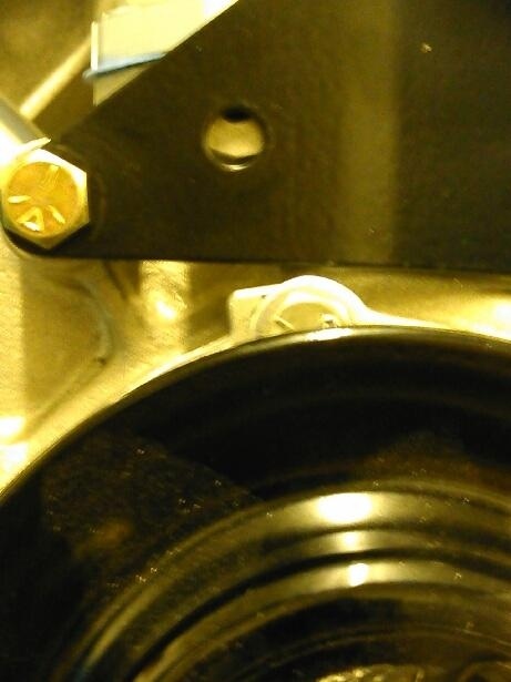

Let me ask a dumb question? Is there 4 inches of clearance between the Water Pump pulley and radiator core support?

Derwud I will measure tomorrow. If I had to guess I would say so.

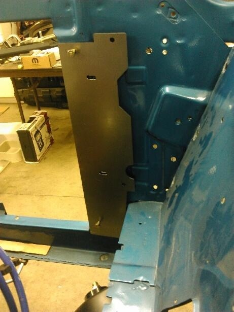

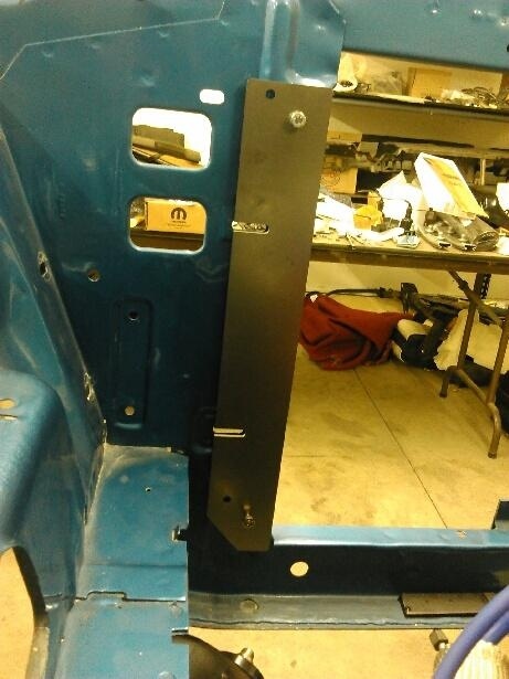

69 GTX, I have a question. If your car is set up for a 26" radiator could you post a pic of the right side radiator support? Both my replacement and the original are set for a 22" radiator and I have to figure out how to modify mine to work with my new 26" aluminum radiator.
Much appreciated :)

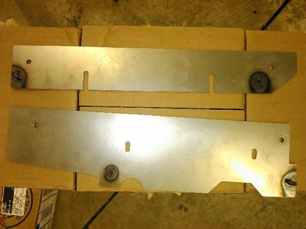

Mine is also a 22" car. That's why I made these adapt plates.
I had extras made if you're interested.
Wow, that is pretty slick. I will let you know, I found new right side pieces which I will probably just buy.

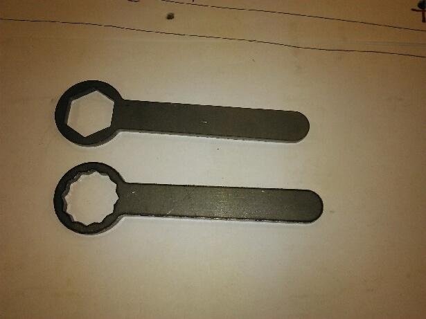

It will be a easy fix, I'll just put it in the mill and make it a slot. I also got my ProMax fuel lines. I'm going to have a wrench made to remove the bowl fittings today. I'll post a picture once it's installed. This will make jetting changes a little easier! Looking forward Saturday when I start my vacation as I'm spending the majority of it in the garage working on the GTX! :thumbsup:

Made some wrenches to tighten the fitting in the fuel bowls on the middle and rear carb

I had to rework my wrenches, to much material around hex, revision B up next!
