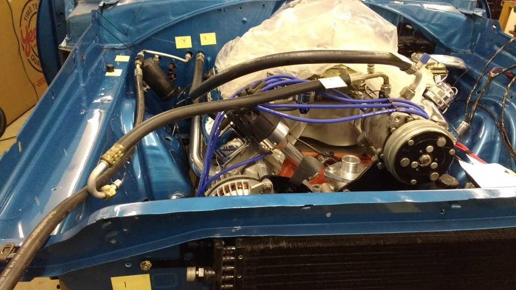

View attachment 402641 So the line routing will look something like this. I'll run hard lines from the condenser up and over where the hose in the lower left is. That way the AC hoses will lay right with the heater hoses. I'll start ordering fittings and line after I get the radiator and condenser set for the last time. I think after my 5th trip to the parts store I may have the right belts for everything! I was thinking of doing the AC lines in braided line so they wouldn't be so big and bulky. But I'm not sure if that'd look good. What do you guys think.
I know a lot of guys run a setup like that but I'm going for the passenger side low mount option!

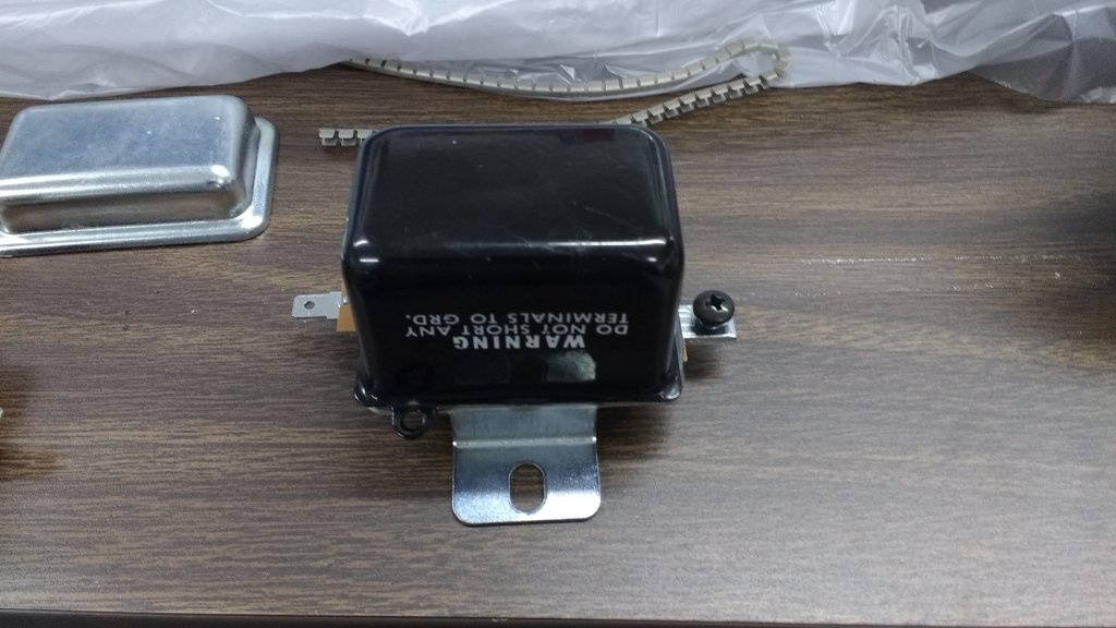

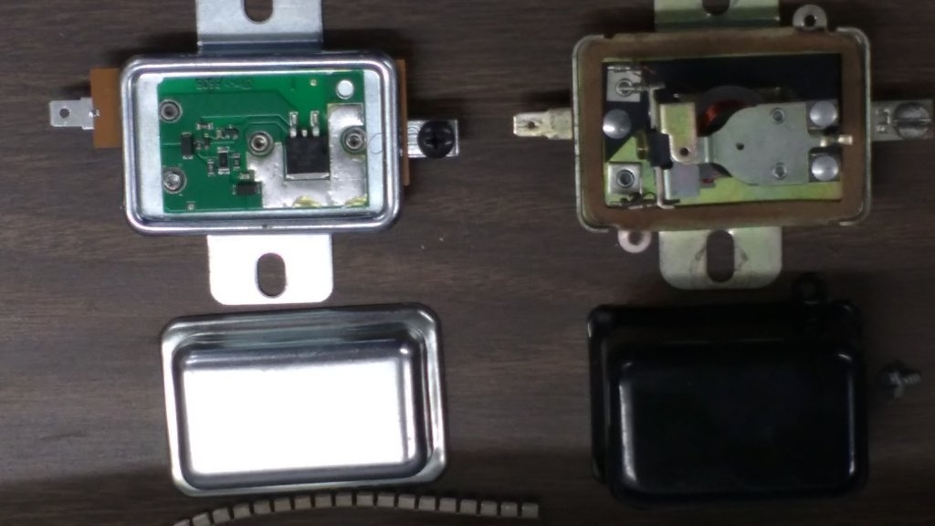

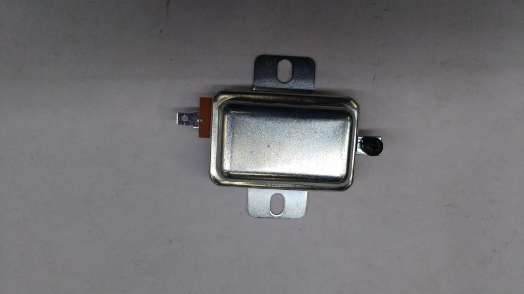

Picked up a new voltage regulator from Autozone last night. I saw where guys use this one and attach the OEM black cover on it to make it look OEM. Also the have a promo where they will give you 10$ store credit for old car batteries (5 per trip) so looks like I will be bringing in some of the ones I have setting around .

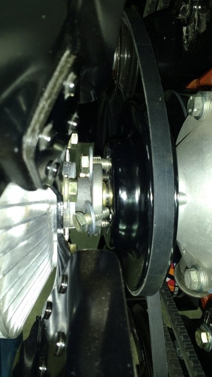

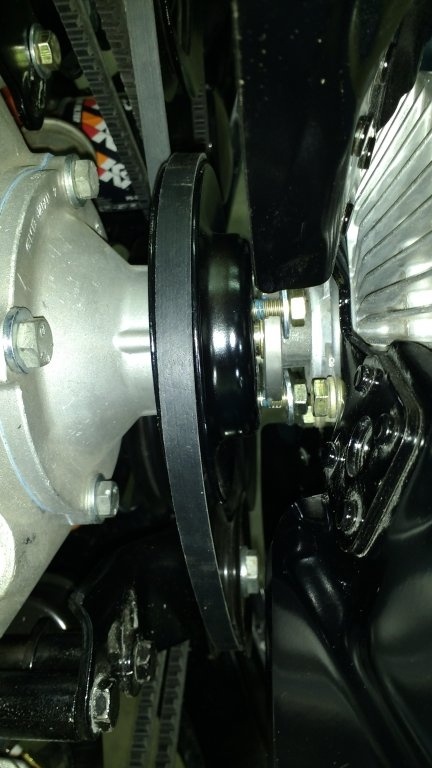

So had a good weekend on the car, finally got all the right belts. Make sure to put the belts on before the fan if you can. Also the lower radiator hose to make your life easier.
The easiest way to do this I found was to get the first bolt started about 2 -3 threads then pull the fan back out to start the next one. Once you get the next bolt in the hole push the fan in to put pressure on the head of the bolt while you thread it in, repeat.

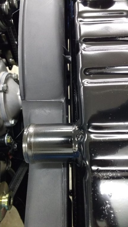

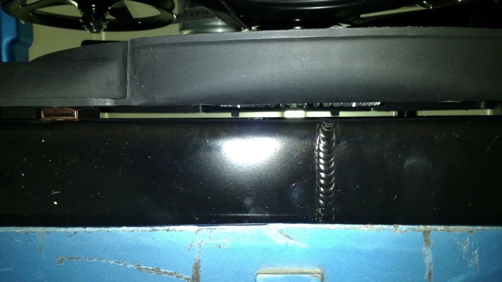

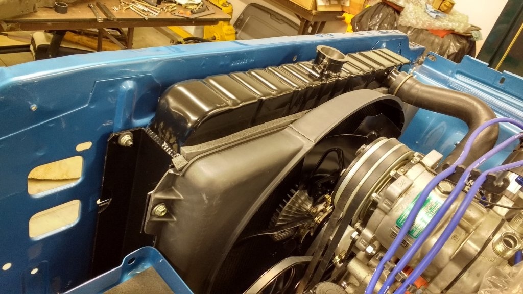

So once I got the radiator and shroud installed I had some pretty good gaps at the top and bottom. I used some 1/2 inch self adhesive foam. It filled the gap nicely.

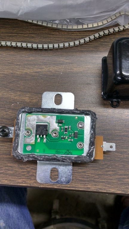

So here is the voltage regulated I got from auto zone and the oem. I removed the covers for a switcharoo.

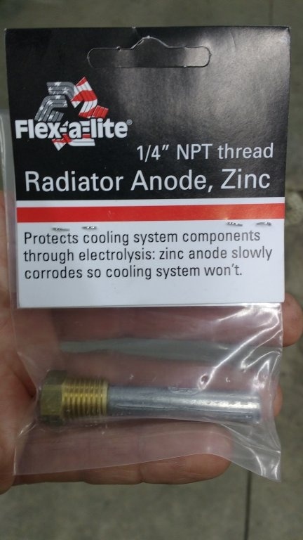

I bought this for the alum. radiator/waterpump.
Here's a picture of the foam filling the gap on shroud.

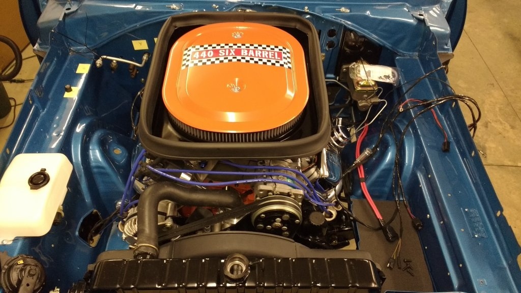

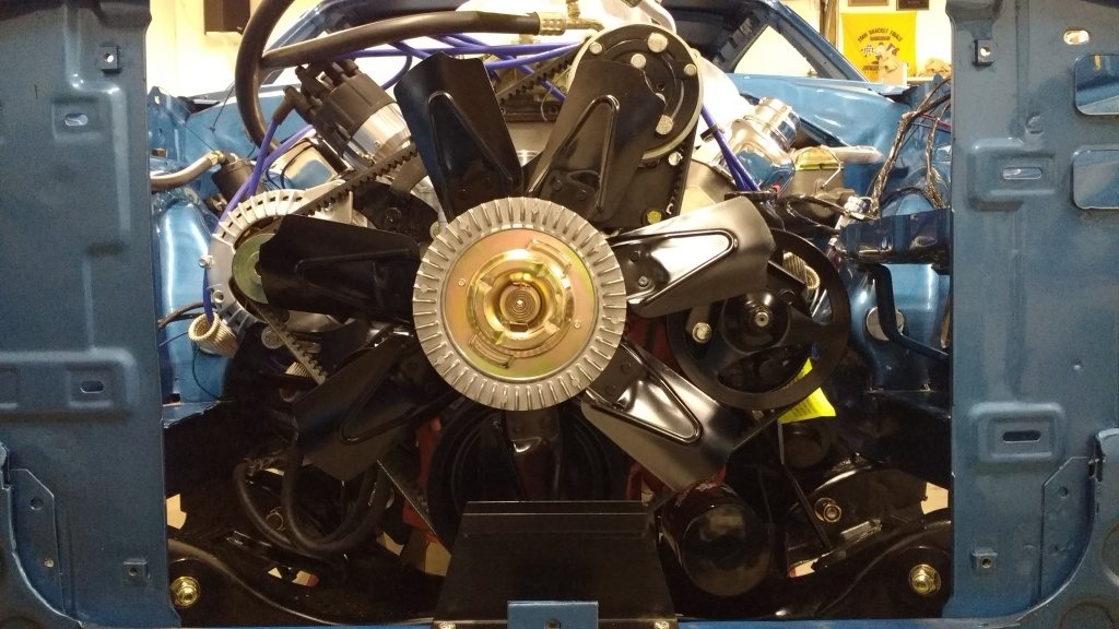

It's starting to look like a engine compartment now.

View attachment 403836 So here is the voltage regulated I got from auto zone and the oem. I removed the covers for a switcharoo.
I have 3 or 4 of the solid state ones from a seller on ebay. Switched over my 62 and running the same setup on my 69.
By the way, where does that anode screw in? Great idea as I have an aluminum radiator and water pump.
