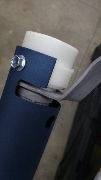

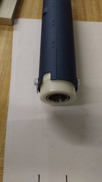

So the old bearing had 2 holes, new one 3. S I marked and drilled 2 new holes for the self tappers.

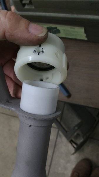

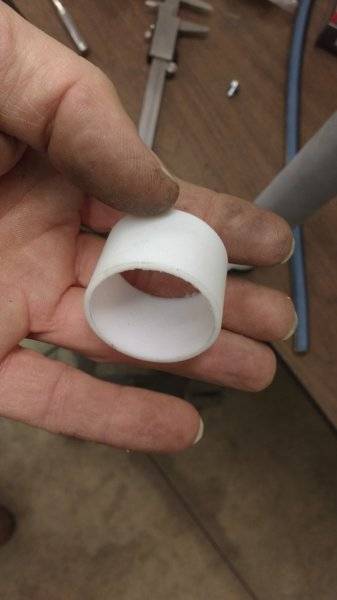

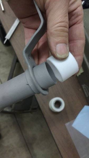

So I installed the shift tube and didn't like how sloppy it was at the bottom. So I made a plastic bushing to help that.
Much better, now just pull it back apart to paint the shift tube. BTW the bushing is 1.315 ID 1.420 od.

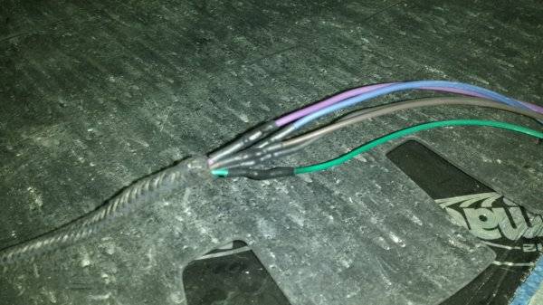

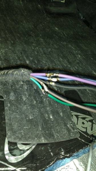

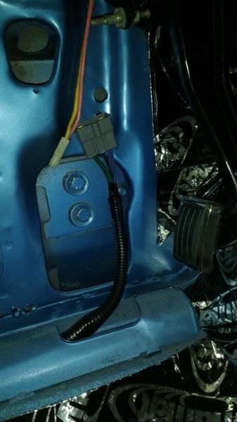

So I crimped, soildered, and heat shrinked the extention I made for the rear lighting harness. This was due to the mini tubs I installed. Made the harness about 6" short.

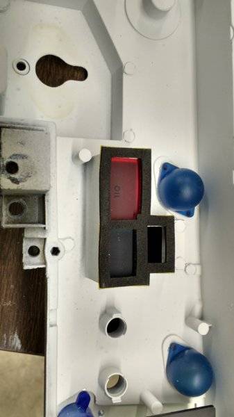

So I have a question for you guys. If you look there's a empty spot above the right turn signal indicator for a light of some sort. I'm wondering what would have been there. Here is what I'm thinking about doing. I'd like to put a on light, for my gear vendor overdrive there. I'd like to find a switch to use where the convertible top/rear defroster switch went as a option. So if you know of a speedo with this window for the light let me know. I looked in my manual but they didn't show anything.

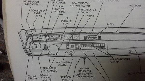

Service manual shows nothing there. On the circuit board it is cut for a light that ties into the other dash lights.
Mark I thought it was tied to the pin at 11 o'clock at the back. I could still bypass that with a led light. Was just looking to see if anyone has everything seen a speedo plate with a light there.
Also looking for a set of defroster vents.
You're right. I was looking at the grou ds for the lights tied into it. But the 11 o'clock pin is vacant in the service manual (no wire).
