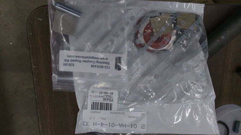

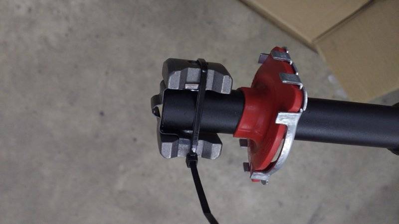

So I had to rebuild kits, one Year one, one Mega Parts. I was going to use the mega parts kit. Everything was going well till I went to I went to install the spring clip. It wasn't wide enough for the 2 pinned pieces and broke. So I had to rob the one out of the year one kit. Verdict buy the year one kit.

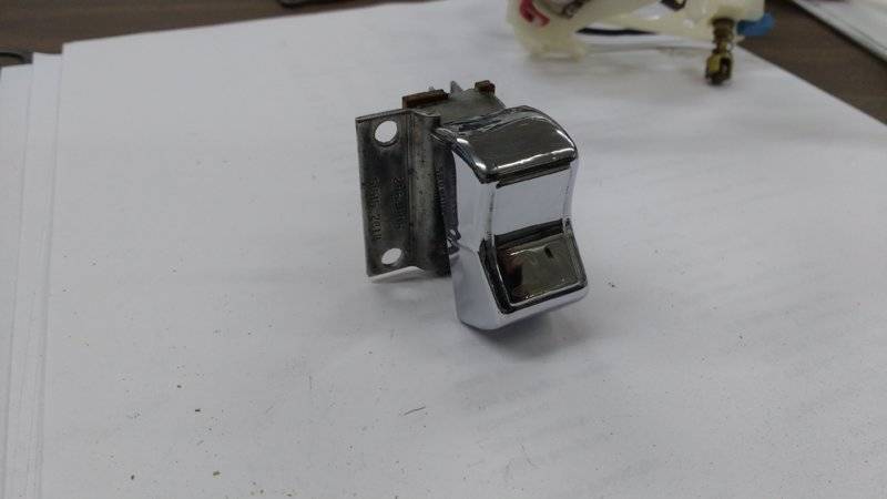

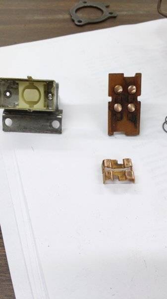

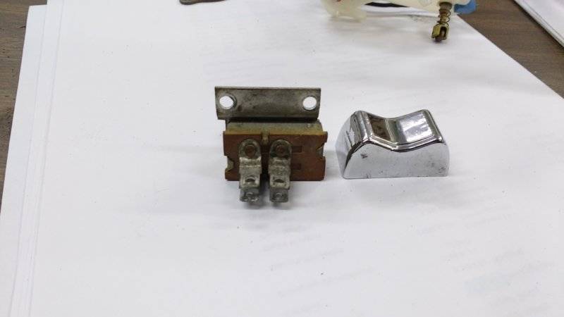

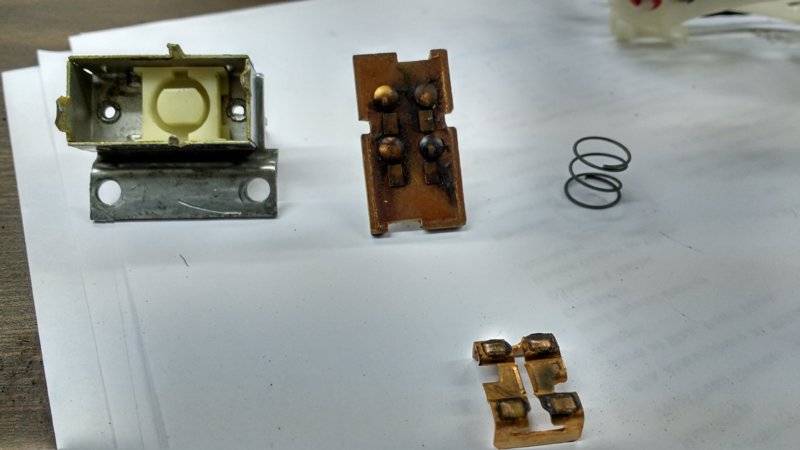

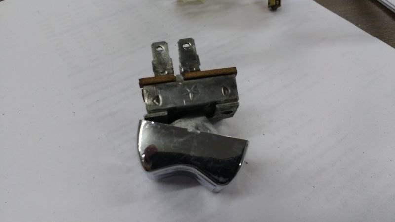

So 3wood was kind enough to hook me up with a 4 way flasher switch. I pulled it apart, cleaned it, put a little dielectric grease on it then put it back together. Got the Dremel out with the wire wheel and cleaned it up.

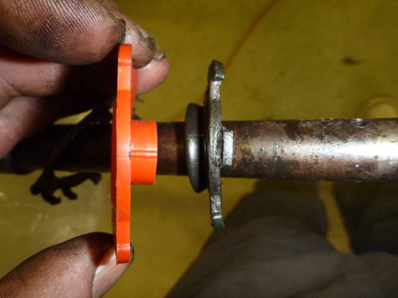

I have a rebuild kit from Partsmix and it has the same incorrect and not shaped correct red/orange seal in it. The pin to hold the two pivot/slider blocks was chopped to length plain offshore steel and undersize. Definitely not hardened, honed to shape and light press fit like the original. Turns out I'm using the old pin, blocks etc and ended up ordering (just received today) the correct black rubber seal and a stainless retainer from DMT. The only part I may be using from the kit is the spring clip!

I still can't believe the orange seals are still being sold.....Back in the day Ma Mopar offered the kit with the orange seals...I think I still have a couple kit.....

Oh man, so correct on crap parts. I ended up using the new seal and that was it. The rest of my old parts just needed a good cleaning and I reassembled, never took the cross pin out either.

The repro industry sucks.....very little good stuff and a massive amount of junk...

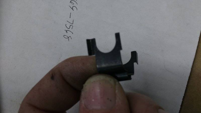

Guess I'll be using my old spring clip as well.. so nothing from the rebuild kit. Save the $20US folks and just order the items you need from DMT.

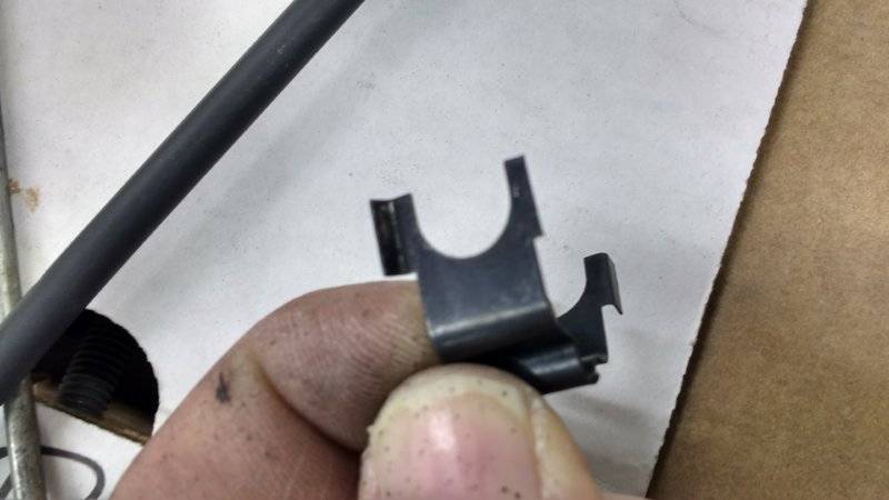

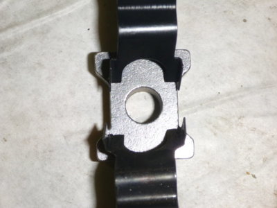

This is what Tim is talking about. The repro clip isn't as wide as the area it's supposed to clip around. Repro top, OEM bottom.

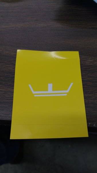

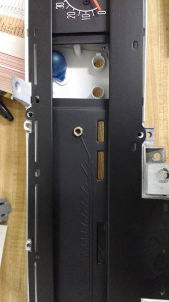

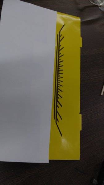

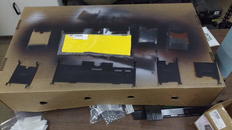

So I took the day off yesterday, and called it spring break. I decided to paint the white markings on my gauges. I bought the stencils. And are they everything tricky! What I learned was to peel the backing off then put it back on a just under the open line. They are really sticky and with the dry air and static cling it was a challenge!

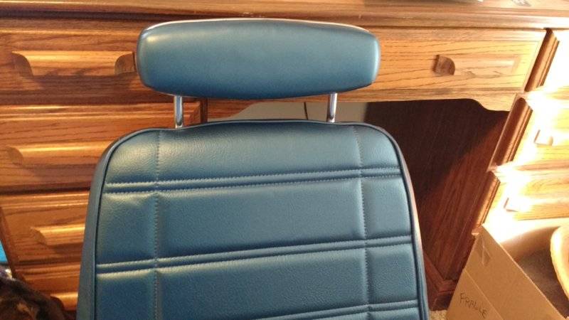

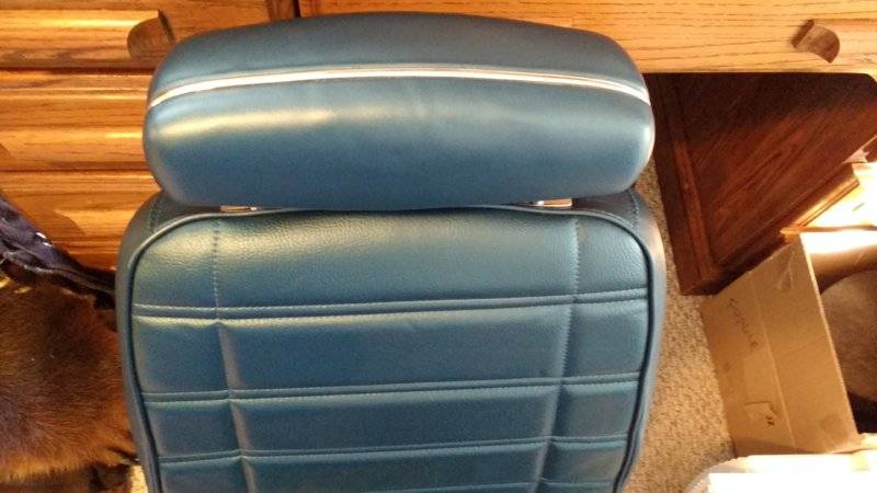

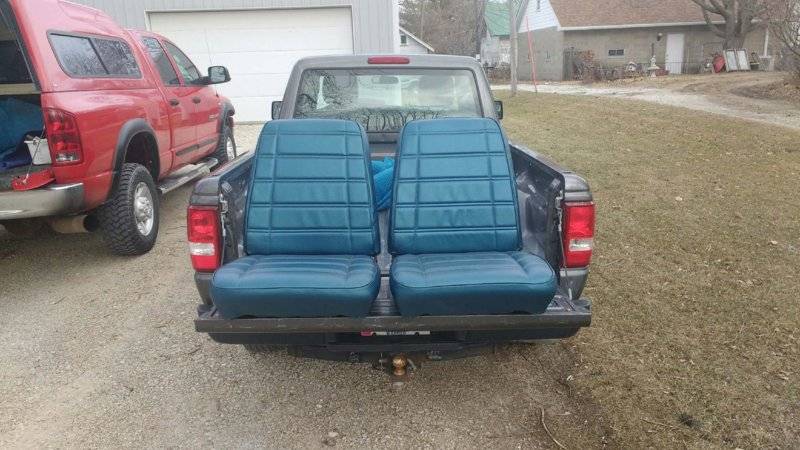

Thought I'd post pictures of the headrests, as Ray asked me how they looked.
View attachment 582190 View attachment 582192 View attachment 582194 View attachment 582195

Sounds like everyone has had the same trouble with these. My spring clip also didn't fit from the rebuild kit. I also just reused my original ones.

So the vinyl stencil is very sticky and hard to position. So I reapplied the backing to just below the lower markings. This helped me get the stencil in postion. You have to be very careful if you have to pull the stencil up not to stretch it. Once happy with the position I rubbed the open edges with a q tip.
