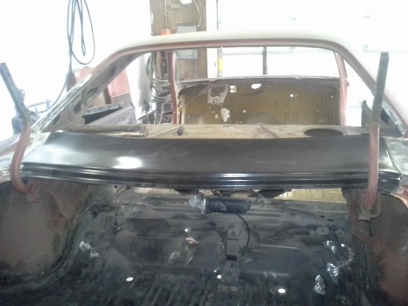

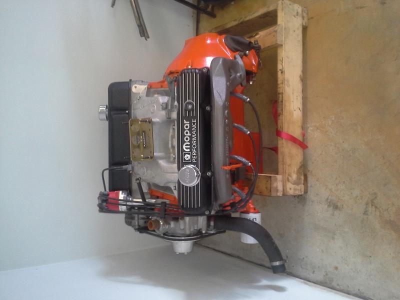

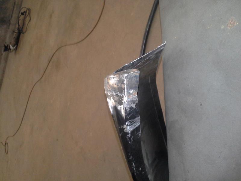

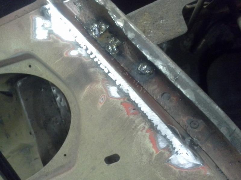

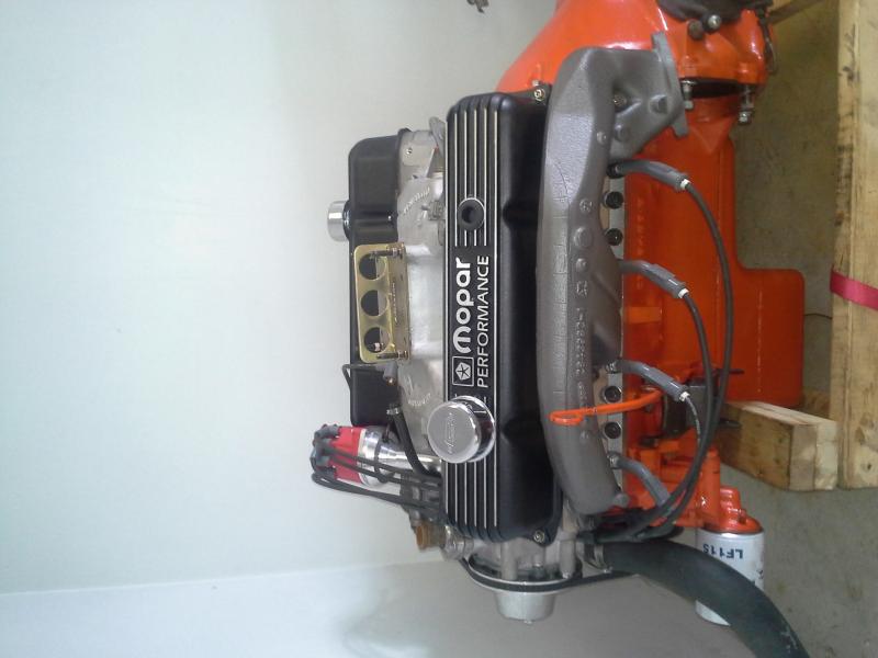

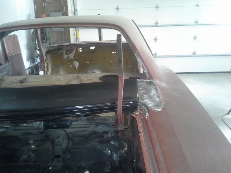

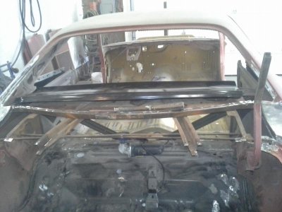

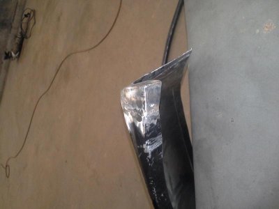

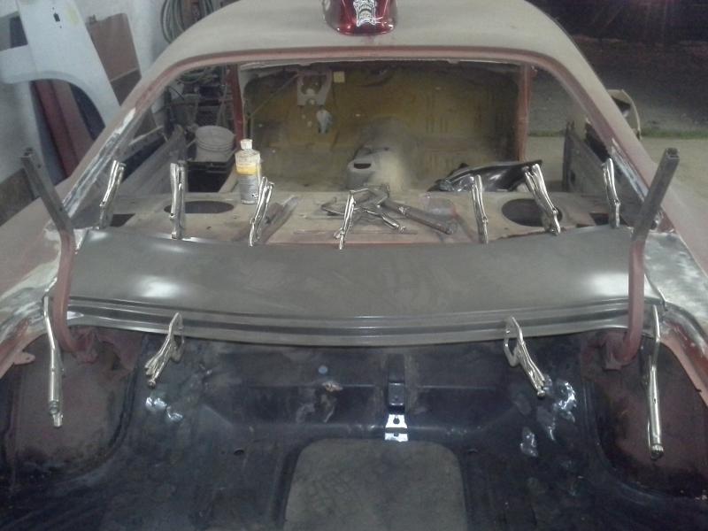

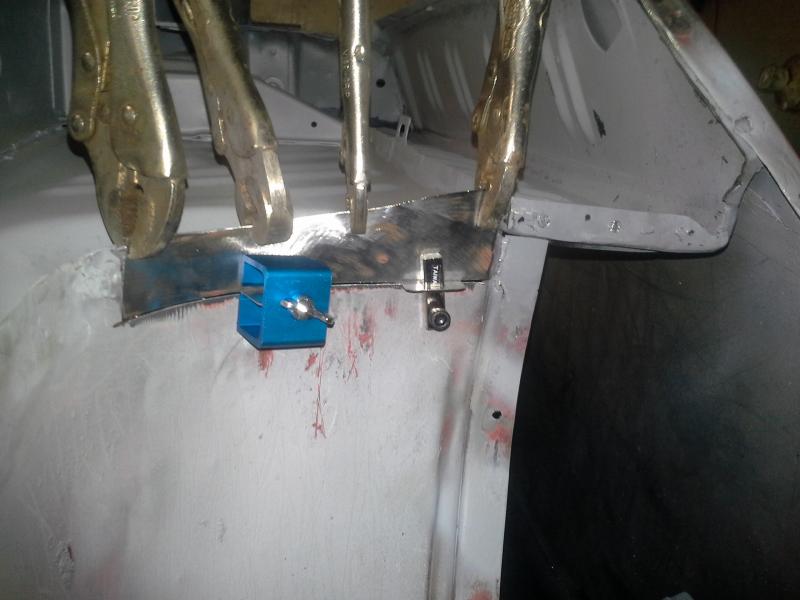

It's been a while since I had a chance to update this thread. The engine 440, is now completely rebuilt, alum heads, voodoo cam, roller rockers etc. the previous owner welded the rear deck panel to the quarters, so I decided to replace the panel as I wanted the correct look of the factory seem. The new amd piece fit decent, not perfect but decent. One corner was about a half inch too high so as you will see in the pic I had to slice it and dolly the corner in.
Deck panel

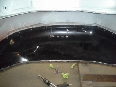

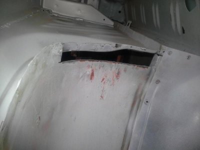

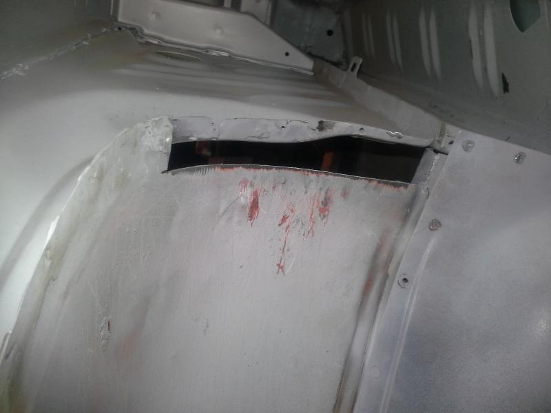

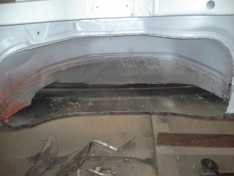

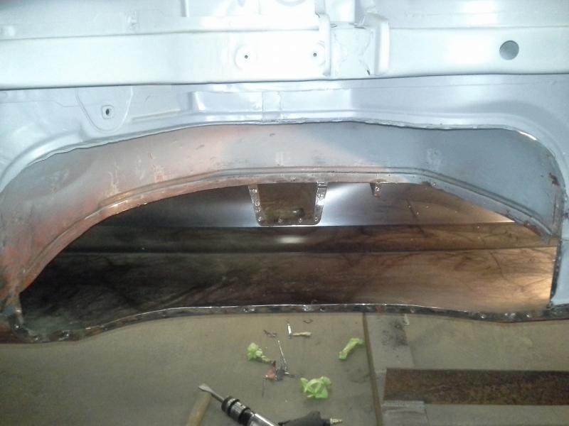

Outer Wheelhouse replacement

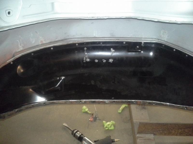

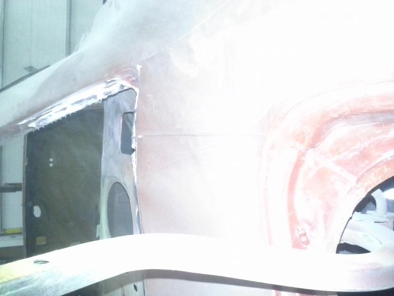

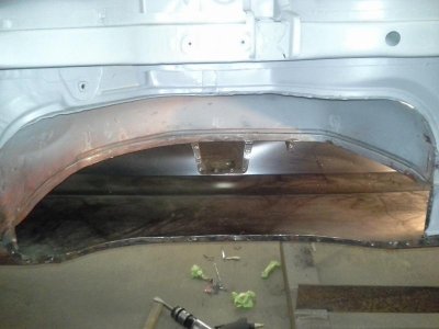

The previous owner had replace the quarters, but decided to patch the outer wheel houses in a very poor way. So I decided to replace them before I go any further.image.jpgimage.jpgimage.jpgimage.jpgimage.jpg

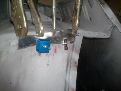

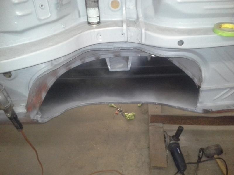

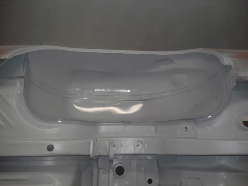

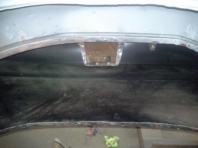

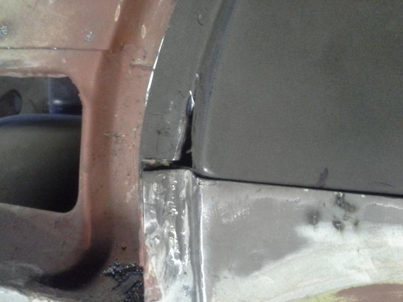

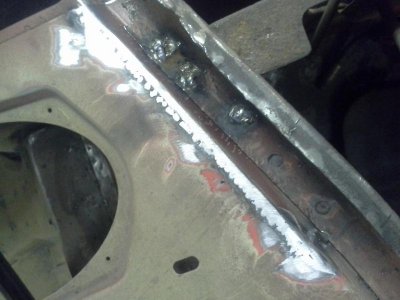

Wheel house finished in epoxy primer, seam sealer next. As you can see in the pic below, one of the wheel houses (AMD) needed the corner made longer, it was over a inch too short, I made up three pieces to lengthen it. I also had to patch a small area of the inner house.

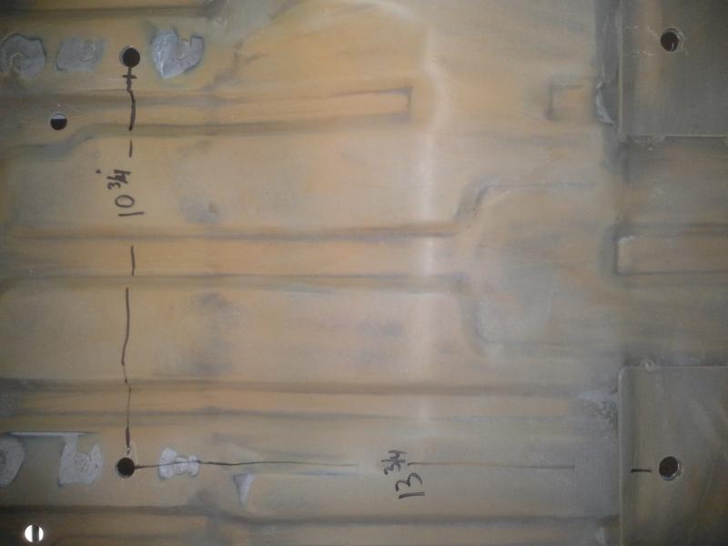

Bucket seat measurements
Here are the bucket seat measurements Bruce is looking for, side to side 13 3/4 inches and front to back 10 3/4 inches, this is from the center of the whole to center of hole.
hey thanks a lot dean, that makes it easier for sure
