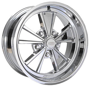

if you like the Rocket one above , Cragar make a bad *** wheel like that , you can order with the insets in black , looks like early hot wheels car wheel I love them

moparstuart, yeah those are sweet. I've been looking pretty hard at some centerline 5 spokes that are polished and probably derived or influenced from the TT spoke shape, different though.. like a heavy TT II spoke shape.
Anyways, they say they are made in Cali, which for the moment is still technically territory of the USA. :grin:
And they make them to order, you spec you backspace and hoop width.
I might go that route

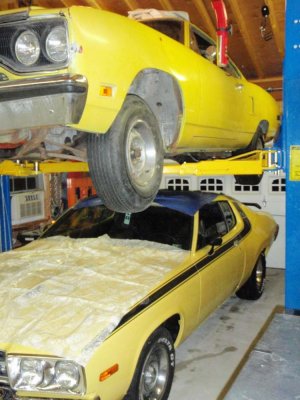

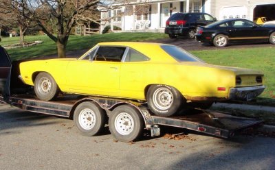

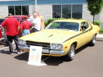

For what is is worth, I have used 275/60/15 on 8" rims with 4.5" of backspacing on my 73 and 70 Road Runners. I think they look great, they NEVER rub, and work well with no worries.
Note that the 70 Road Runner hasn't seen any real road time, but still has the wheels on it. It may be rough, but maybe you can get a sense of the look.
Hope this helps...

Do NOT drop that 70 on top of that 73!! :grin:
Thanks, yes that does help.
