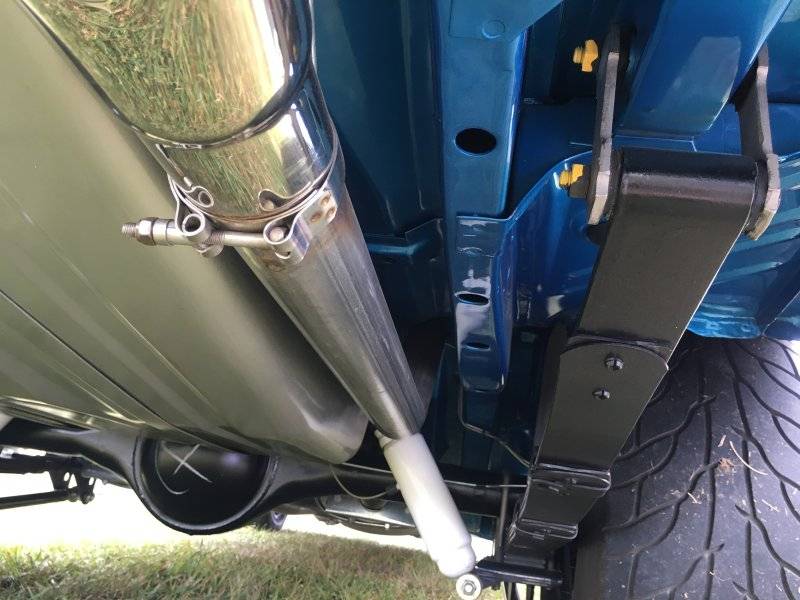

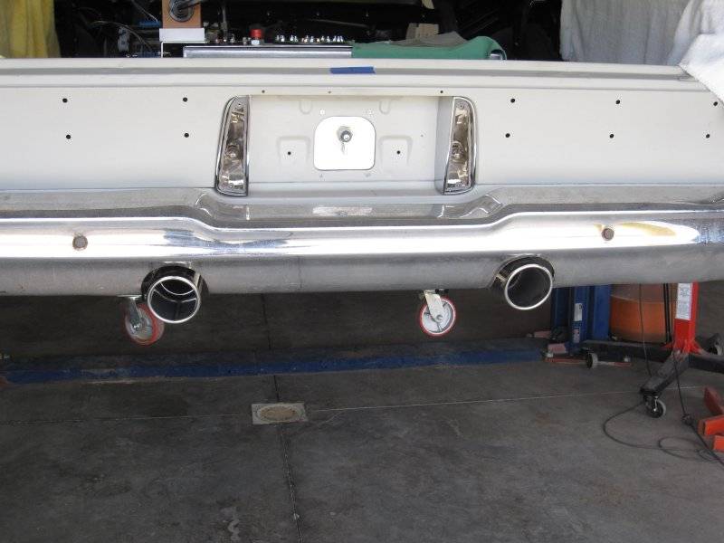

I'm building from scratch with pre-bent stuff - but I can cut and weld as necessary. At this point I have fabbed up short lengths to pass through the front crossmember humps. Next will be into an X pipe then out to the mufflers. The car has a stock tank and springs moved inboard. The tailpipes will run between the tank and frame rails but that doesn't look like it will be an issue (see atached photo of someone else's cars) I'm thinking offset outlets will be right under the hangers and a straight shot over the diff. Both of these guys are using center outlets.

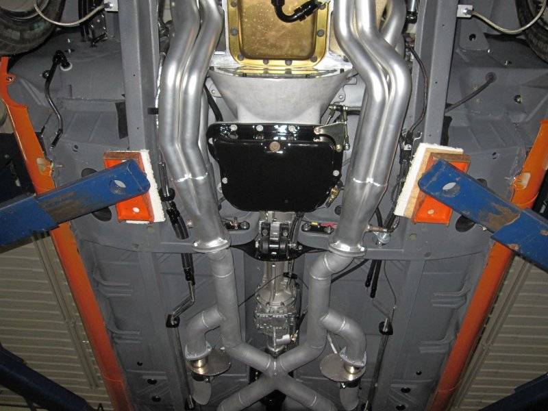

My 3" system. In retrospect, I would/should have used 2 1/2" for tailpipes. I have been using OEM style hangers on the last two systems, just love 'em! Note the tie-bar on the exit hangers. Anti rattle insurance.
Mike
Very nice work! Looks like you used "aluminized" steel as opposed to stainless, correct? I'm leaning that way but 409 stainless is not much more money. Did you do all that yourself? Mig or tig? I'm leaning that way but 409 stainless is not much more money.
Correct. I assembled the system but, my mig welds weren't much to look at so I had a friend go over them with a tig welder. I cut U bends to get the angles I wanted with my carbide bladed chop saw. I had to improvise hold down clamps to hold the tubing for cutting.
