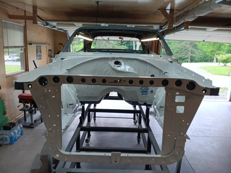

Quick fit to see what it looks like, 20° in the garage so no need to make any progress today. Need to change out the chrome valve covers with black ones. Will start work on fuel lines and wiring into the painless harness later this week. FiTech now sends a dual relay/fuse box for the system so i dont need wire up separate fuel pump relay now. They have also made some changes on the system from the older models that caused problems.

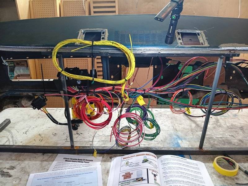

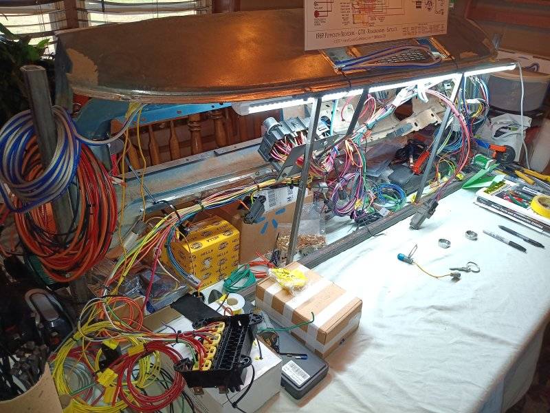

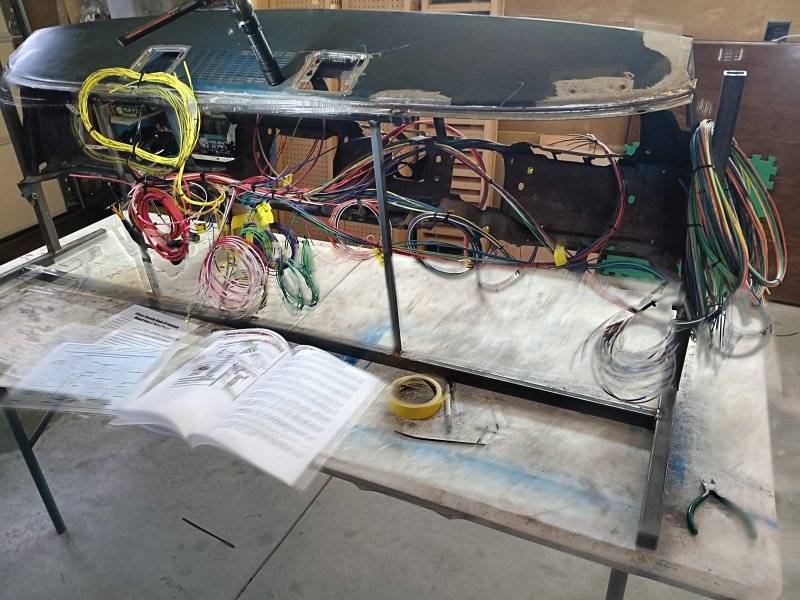

Got the garage up to 40°, so was able to make some progress. Temporarily mounted the fuse block. Ill build a glove box later on. Didn't take a start picture, but since its a universal harness the connections are bundled in common areas where the would typically be routed. Front and rear were fine. I reworked the middle section and changed most of the wires. I plan consolidate all the relays at the glovebox along power blocks, sonce the battery is in the trunk. I will need to make the lighting circuits for interior also the wiper circuit as niether one of these are provided in full. Still tons left, but a good start. Oh decided to clear of a table and just work inside for the rest of the dash wire up.

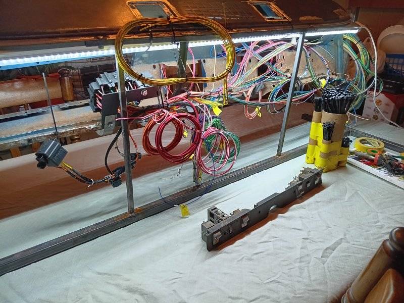

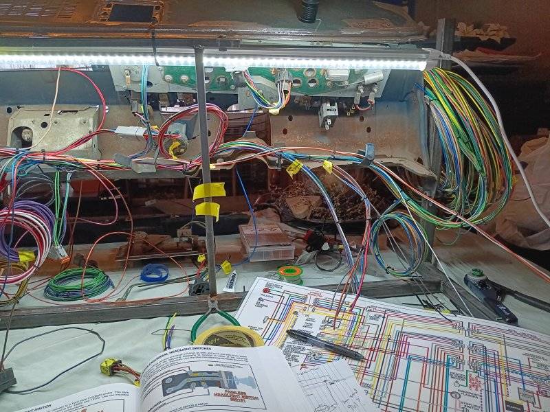

Six hours at it today, made some progress, doesnt look much like it. Wiper switch finished, reverse, NSS, engine sending sensors, instrument panel(with the exception of the ebrake warning) and floor dimmer. Working on the turn signal and emergency flash switch, those will need some splices/couple jumpers.
When I wired my friend John's C20 with the Painless package, it was almost 3 weeks to do. Some days at least 6 hours, others 1-3 or so. Routing, looming, adding grounds, securing, soldering, heat shrink etc takes time to have it look nice plus not have any issues. On the 50 F1 Ford that was essentially the truck body grafted to an 04 Ford Explorer chassis, that took 2+ months at 8 hours a day. I had to retain the CANBUS system from the 04. Many days of reading wiring diagrams to see what I could not use and delete. Many days of extending, shortening, re-routing, mounting power distribution centers/fuse blocks. I had to retain the 04 instrument cluster as that was the CANBUS communication hub. Mounted that inside the trucks gas tank along with several other electronics units. The tank became the electronics locker. In case you're wondering, the tank for the 04 is what stayed as the fuel tank.
Wow, thats above my skill level. It would be interesting to build something like that. The most "modern problem" for this is the BMW seats, the CANBUS signal that keeps them awake is not there, but with a simple 555 module and a 5V step down converter or just a simple toggle to reapply power they should work fine.
That was my first time with something that complicated. There were some line techs working at that shop who gave me some info here and there. The shop owner wouldn't cough up a Ford electrical manual for the truck, said just look it up on the net. Good thing I was hourly but what a waste of time. Zero info for what I needed. I ended up getting a manual on my own and made the service writer cough up the dough back to me. The truck owner had no problem paying for it. Just a PITA shop owner. It was for sure daunting but I didn't power anything up till I was ready. No shorts, no issues. I felt lucky.

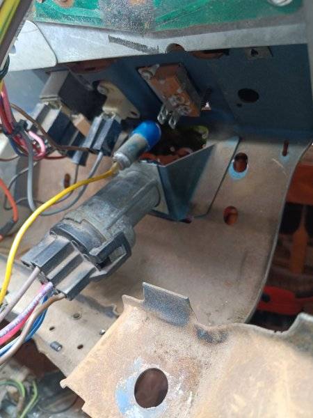

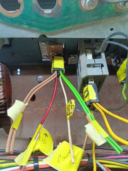

Tried to find which way the connector goes on but no luck and i cannot remember. Does the hazard switch connector flat side face to the right or the left as pictured or if easier , white wire top left or bottom right. Thanks in advance!
Not much work on the car lately. Wiring is 90% done. Function checked connections/switches with multimeter, signal goes where it should, wont know for sure until power is there. Solved hood issue with eddie motorsport hinges. No more tight fit on drivers side since these are really solid made. Finally found a Ignition switch with courtesy light from 6pktogo, so no more missing dash parts. Still need to build the glove box.

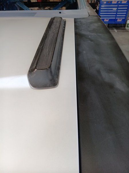

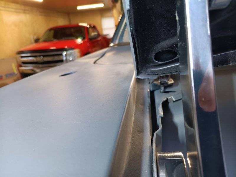

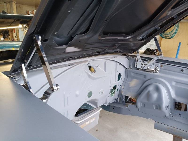

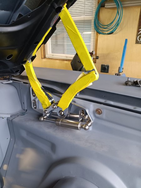

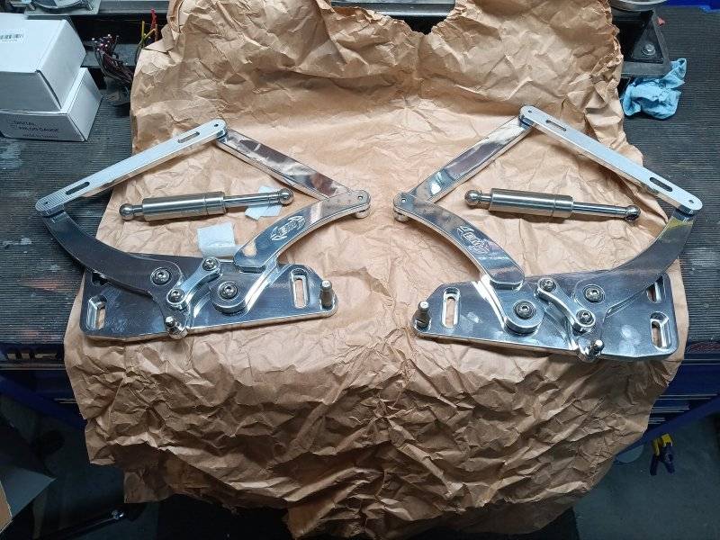

Installed a set of Eddie Motorsports hinges. Very nicely made, washers could be just slighly bigger. they want to dig in on the hood mount. I didnt realize, but there is a slight clearance issue( at least with mine)with them and the cowl to inner fender brace. Got a little gouge in the clear because i couldnt figure out where it was binding at first. Everthing was replaced on this build so its possible the aftermarket clearances are what caused the issues. A few pictures, not fully adjusted yet, but the initial fitment was pretty good
Few more of the clearance issue. Ground a little away and no problems. So glad i hadnt painted it yet

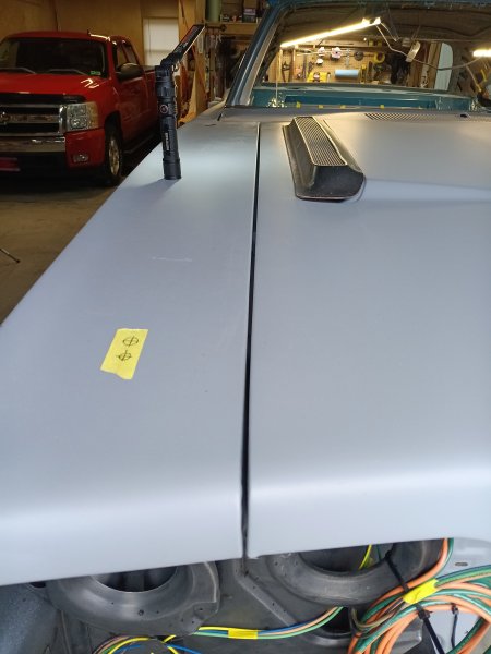

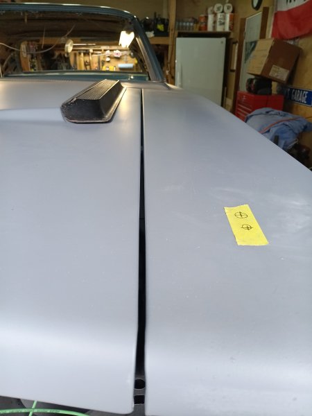

Here is a before and after for the gaps. DS side was always tight with two sets of hinges. These were pricy but it seems to have helped because no matter what I adjusted on the factory hinges I could not make the whole hood move evenly to the PS side without tons of shims and it still didnt fully fix it.

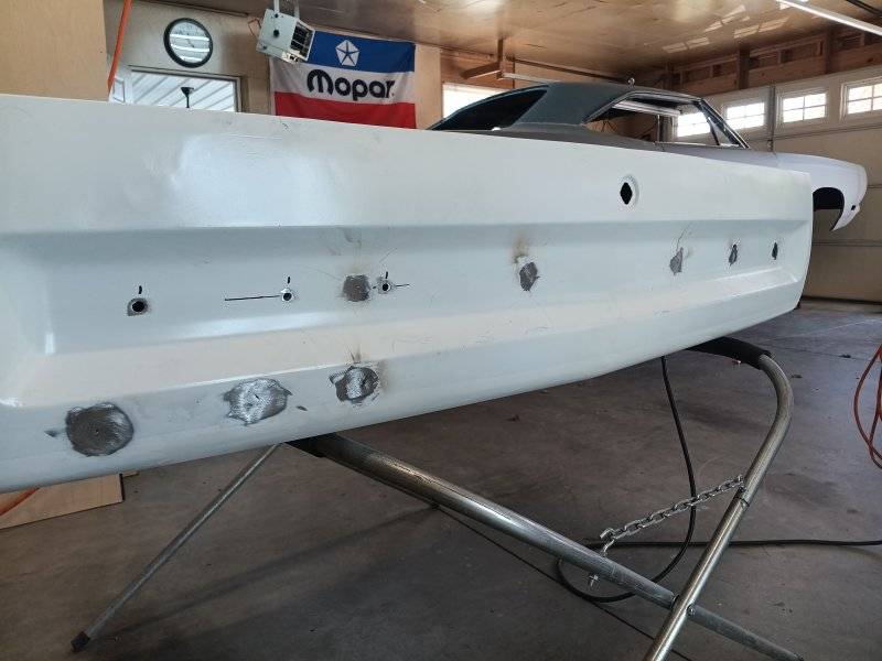

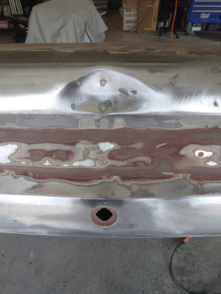

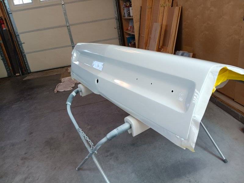

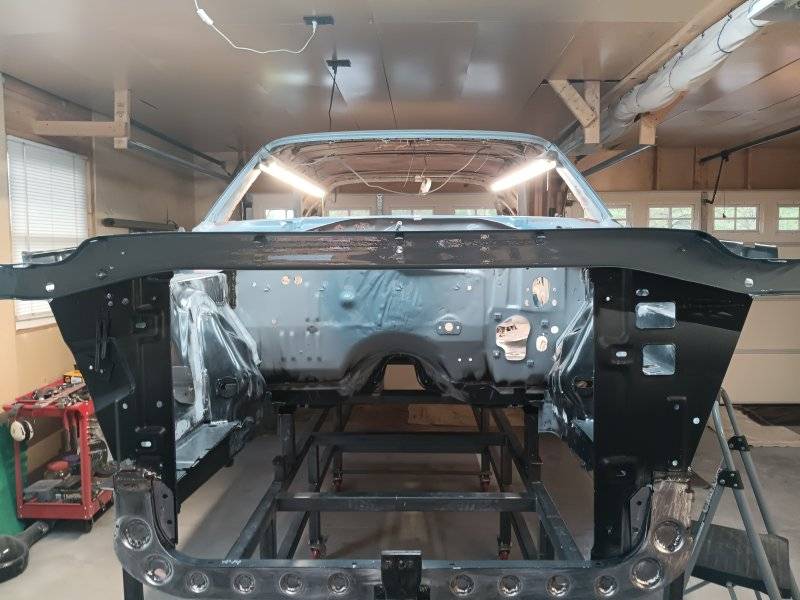

Time to start the month long journey to laying some color. 25 may -2 Jun is the plan, now just need to make sure the upcoming weeks are filled with all the little last minute, shoulda did months ago, things that gotta get done before paint. Worked on the deck lid this week. It was rough, had a few large dent that had to be pulled, a big one right in the back center top over the body line, having a time getting that right, couple others along both bottom sides

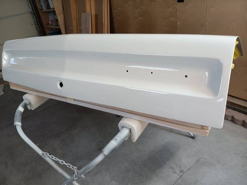

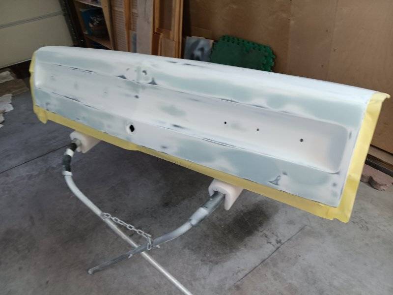

Put epoxy back on today. Three coats for full coverage on the bare spots. 2k tommorrow then ill know how much more work is left on it, then off to the next task. Im gonna go ahead and have my toners mixed, just in case the guy mixing them goes on vacation, would be my luck i wait and he is unavaible

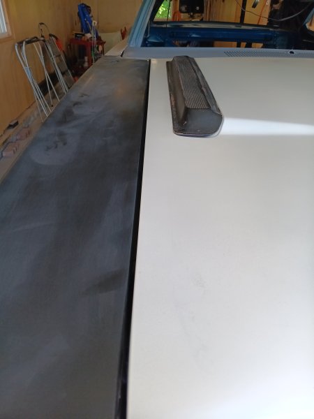

Here is the reveal line, looked straight till I sprayed it. Curves little towards passenger side
