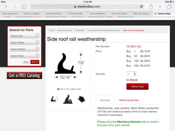

I bought 6' of this seal from Steele Rubber website.

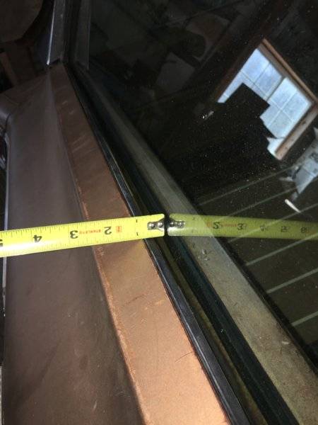

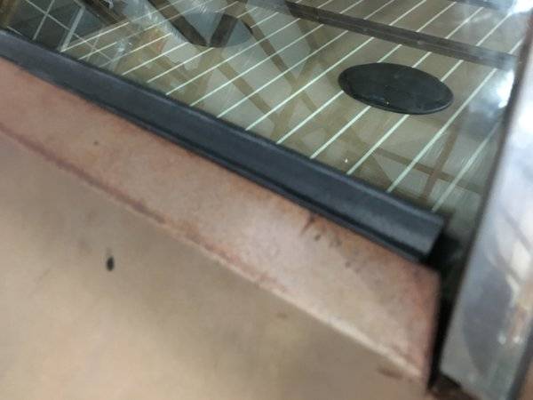

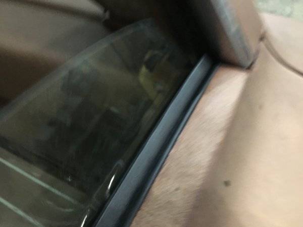

Just to give you an idea of the difference between original seal and the seal I went with, see below.
First pic is original style and see gap between seal and glass. I didn't like this so I went with non original type to help close gap.
