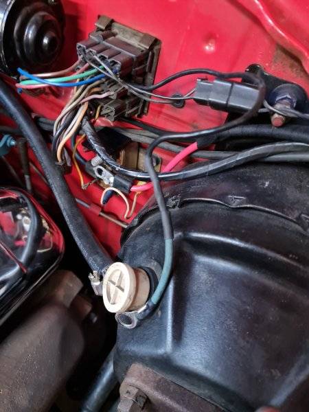

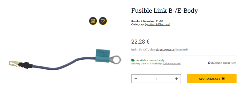

So in light of discovering other wiring issues, I looked over everything that I could see, that was visible that may become an issue later. Lo and behold, I found that at some stage a PO had cut out the fusible link. It had probably blown and instead of replacing it, he just joined the wires together. As this is a critical protection device and could potentially prevent my car from burning to the ground, I replaced it.
We are lucky enough to have a Mopar dealer in Germany, that has a lot of these knick knacks on stock. A bit pricey, but worth it in my opinion.

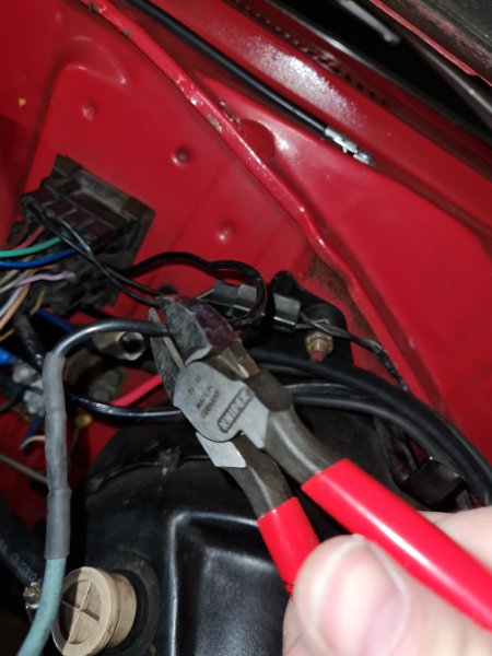

Removed the old piece of wire off the starter relay terminal
Chopped the cable with plenty of extra to spare.

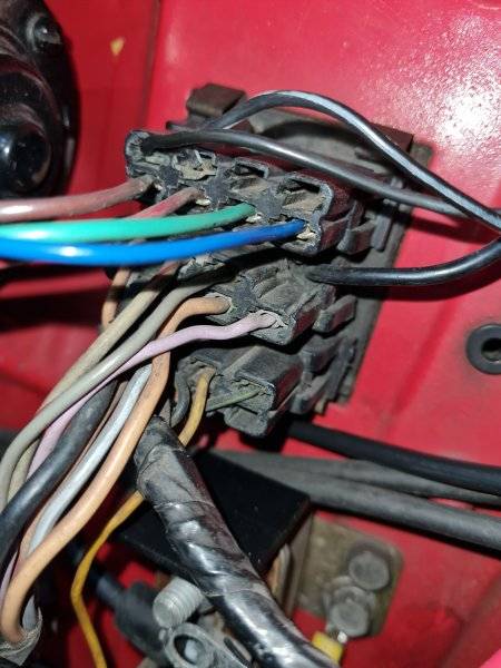

As with a lot of these bulkhead connectors, the joint had got hot at some stage and melted the housing. Somebody ran the cable straight through to the interior. I know this is a better way to do it in these circumstances, but I did not want to hack up my new fusible link.

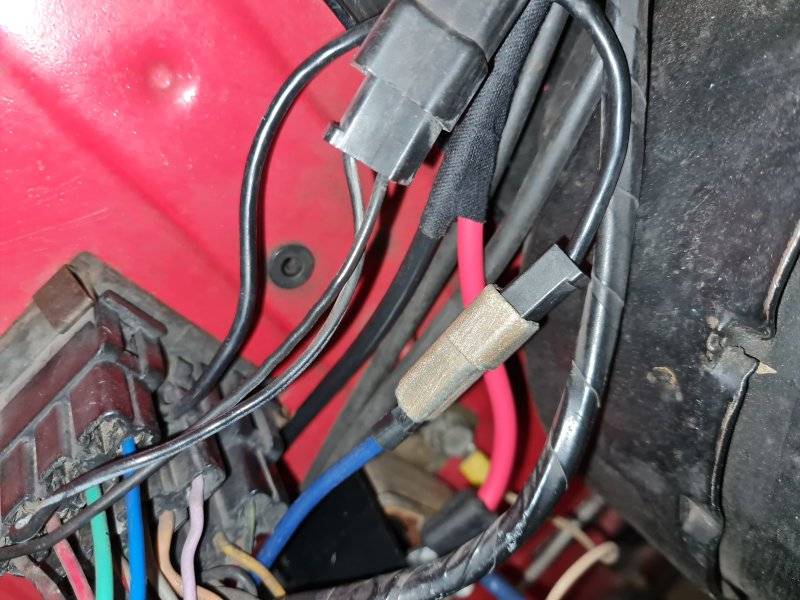

So I crimped on a female spade connector and stole the plastic connectors off my unused AC cable. I have a replacement from Bill Evans anyway, so no harm done.
I used this Delphi crimp tool that my Father-in Law gave me. I must say, what a beautiful tool. It does a perfect crimp.
Made the join outside the bulkhead connector. This way, I can keep an eye on it until I can fix it properly.
It looks like a bodge job, but trust me, that is as good as the original installation. The crimps are brand new and snap together nicely.

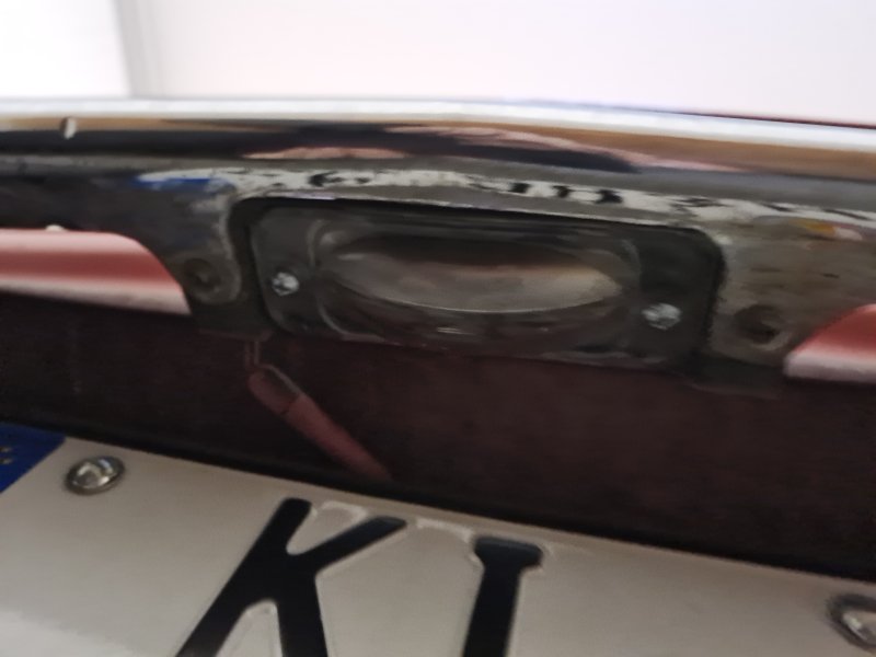

Then I replaced the missing lens from my licence plate light and also the lamp which was the wrong size.

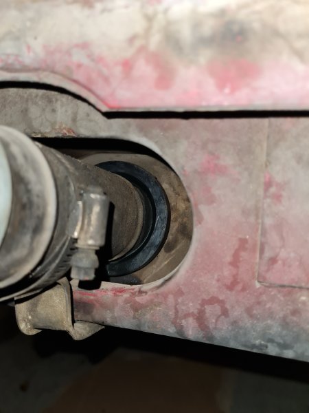

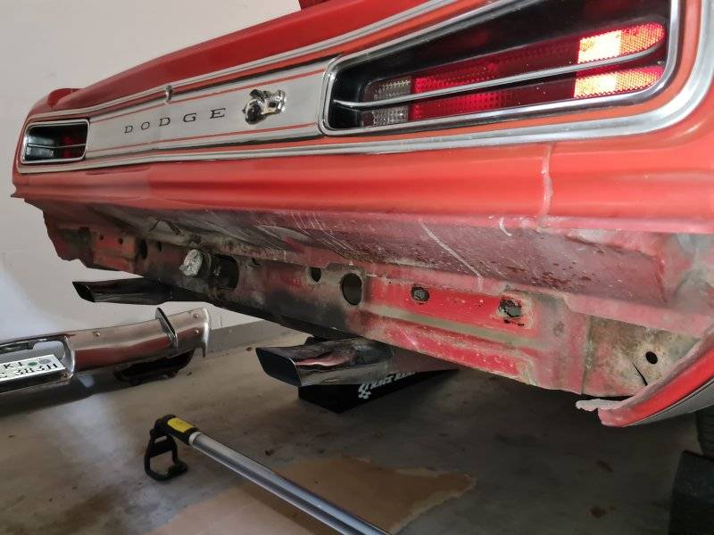

Back onto it. My gas tank leaks gas when I fill it up. Of course the culprit is the gas tank seal. I removed the rear bumper and gave it a good clean. I took the opportunity to replace the sad looking rubbers on the bumpettes with a good repro pair I purchased from Tony's Mopar Parts.
With full access to the gas tank nozzle, I removed it from the tank.

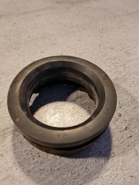

I removed the rotten old seal. Interestingly, it was installed backwards and has been like that for many years. It is a genuine Chrysler part complete with the Pentastar. I honestly can't believe that the factory installed it backwards. But the seal looks to be 54 years old, so who knows.

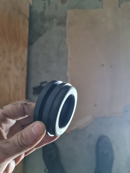

I purchased a new one from DMT.
This is a really nice part and I recommend it. Using some dish soap, I installed it the correct way round. I then lubed up the fuel nozzle and reinstalled it. It went in beautifully and is holding a good seal.
I have read that some people just about pop their eyeballs out of their head trying to get the nozzle back in. No issues with this seal from DMT.
