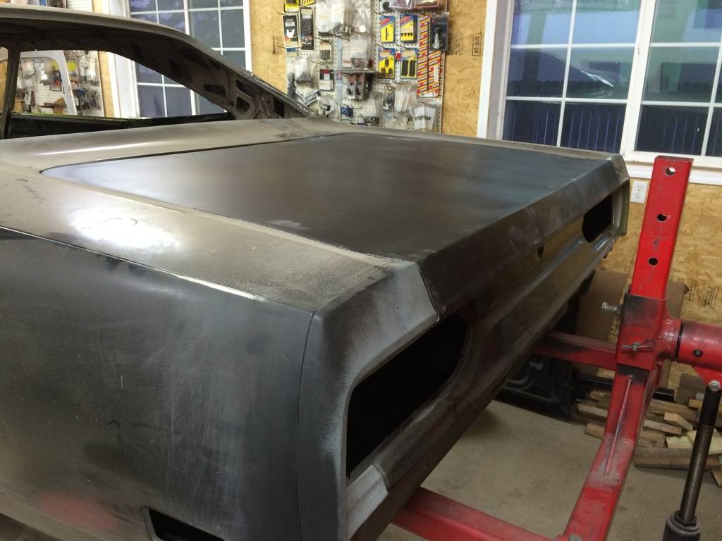

Am I seeing right? That you did away with the box under the dutchman? Or do RRs not have those? I've had 70 RRs but can't remember. I like the idea of getting rid of that waste of space if that's what you did... I'm wanting a Glasstek trunk and hood, let us know how you like the lid. Great project you got here. My dream after the car I'm doing now and after I hit the lotto, would be to do what you're doing but to a 69 charger and make a dayclona. Then take it to Bonneville and get in the 200mph club. Love the winged cars! They really do rule!
As Phil pointed out, no box under the dutchman on these. I'm doing this one for quarter mile racing, street cruising, Drag Week and the Maxton mile just to avoid the salt! I'd like to run 170mph in the quarter and hit over 200mph in the standing mile. I'm sure it'll be several years, but I'd like to do it all before I turn 50.

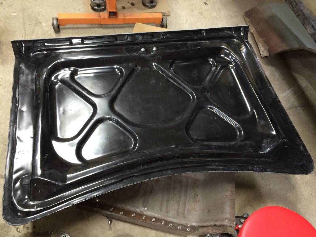

I have a Glasstek hood and a pair of front fenders that I ended up not using and their workmanship and fit is excellent. The hood is really nice as it bolts on with stock hinges and has the underhood bracing like a stocker.

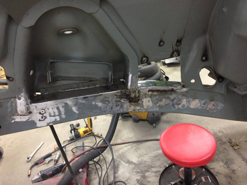

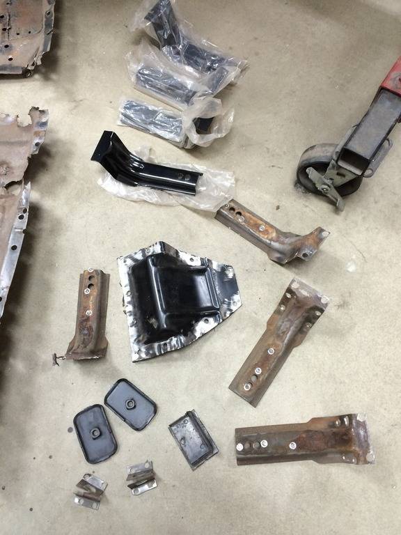

Since I widened the tubs 3", I had to subtract that much from the hinge support braces that fasten to the tubs so here's a stock one next to the shortened one.

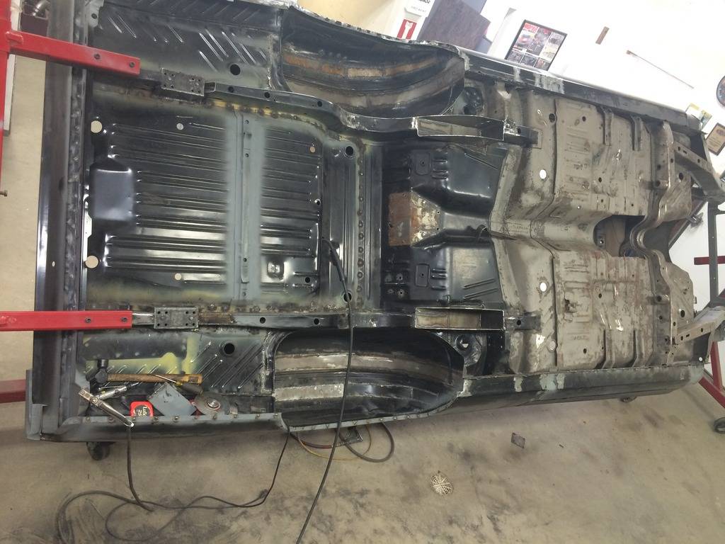

I worked all evening and have both supports for the dutchman panel and both hinge supports welded in. I modified and welded one of the support braces.
I still have a ton of grinding to do on the welds in the trunk area alone. Tons of work.
