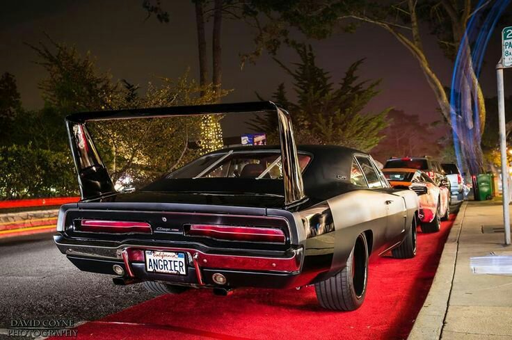

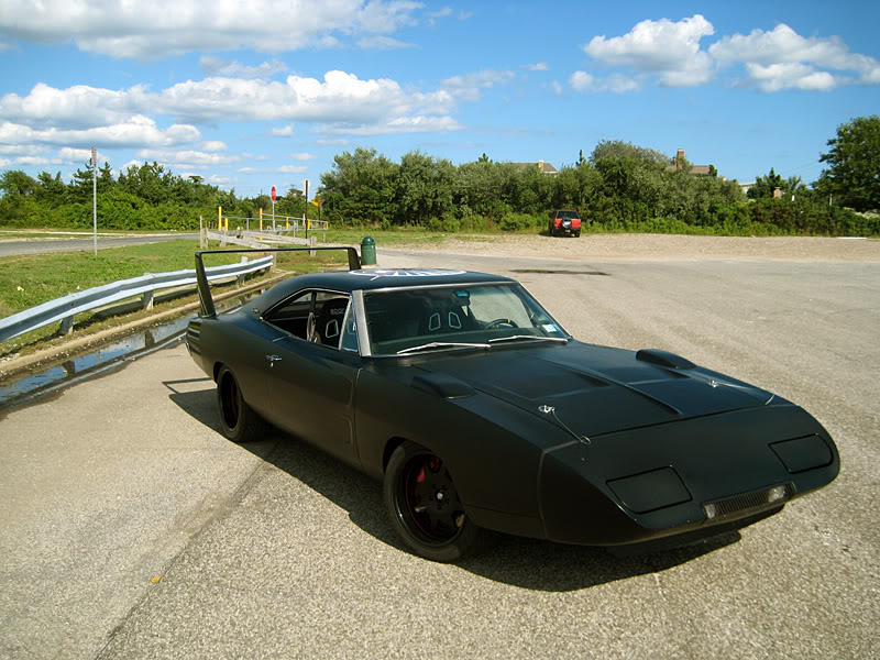

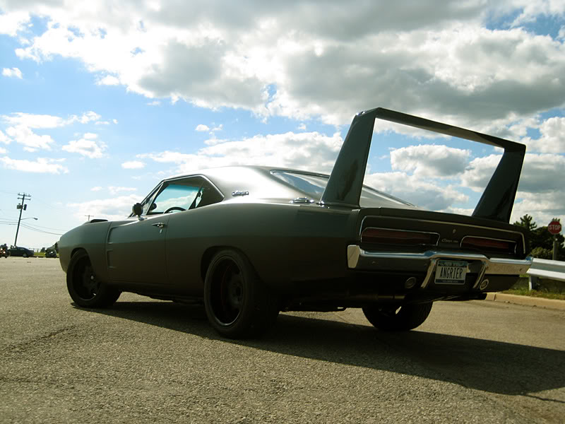

will look absolutely sick! Reminds me a bit of Mike Musto's Daytona
That picture is sick! Love the black on black and the wheels are fitting. Can't believe how well that trunk lid fit's, I'm used to seeing sub-par fiberglass panels. This is going to be a wicked piece of American iron, keep after it!

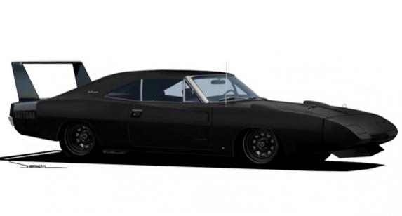

Love that Daytona! Mike sets his cars up to handle well and haul the mail and look great doing it! Mine won't be doing any high G-force corners, but I'll get him in the straights! lol. Sometimes, I think I prefer the body lines of the Daytona and that looks really good in that concept drawing. I'll just have to live with the Superblackbird's lines and even the vinyl top!

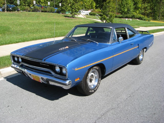

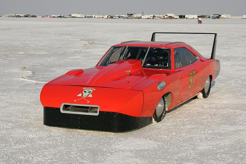

Probably looked something like this...
Wow! That was purty!
This is one is badass, it has a s-bird sticker on the upright but looks more like a tona to me.
The rear window area certainly looks more like a daytona than a bird, but as badass as that is, he can call it anything he likes, lol!
