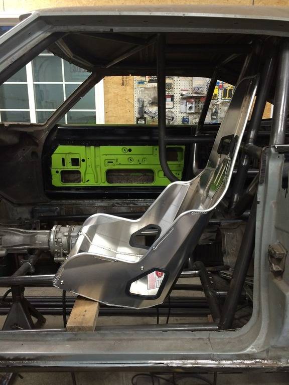

The seat showed up so I can add the seat bars and mounts.
Once the seat is located, I can put in the harness mounting tabs. Once all this is done, I will finally be able to put the floors back in. The seat mounts will raise it up some. Too low here.
I ended up raising it some but it still gives plenty of room around the helmet and good visibility down over the dash and hood.
