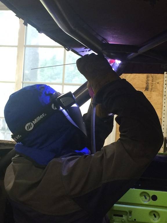

So....back to the cage. I got the A-pillar bars done and tacked them in place. Once satisfied with their fit and position, the bottom side of the joint was welded out.
They're real tight to the A-pillar. The A-pillar trim will have to get cut into two pieces and trimmed to fit tight against the bar. I think it will look nice and clean once done. The other piece of that puzzle is the dash. It will get trimmed to go around the bars. The top part of the dash will get welded in. The rest of the dash will hinge on the side bolts and attach to the upper half of the dash using Dsuz fasteners. This will allow easy removal of the dash for service work on the A/C or electronics.
